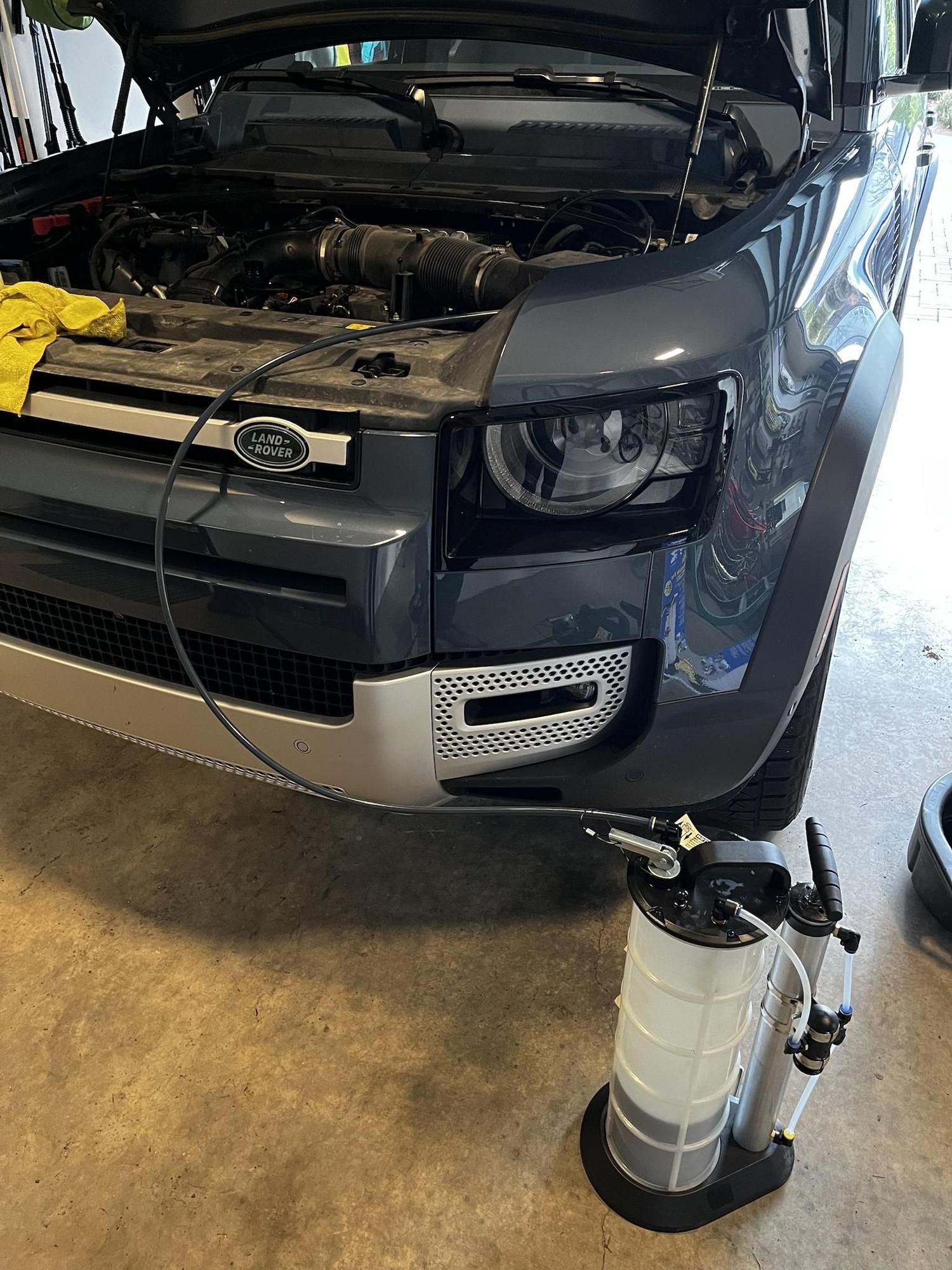

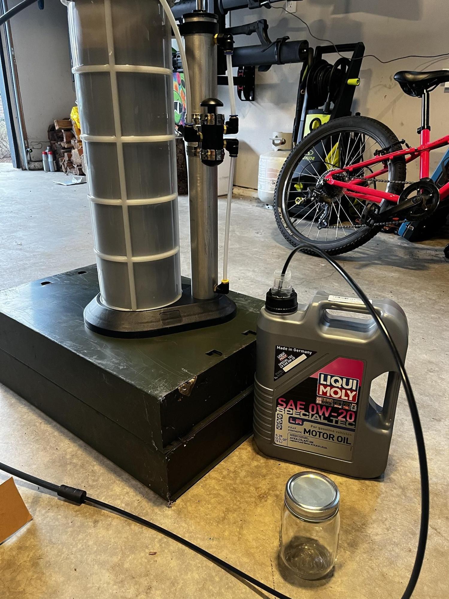

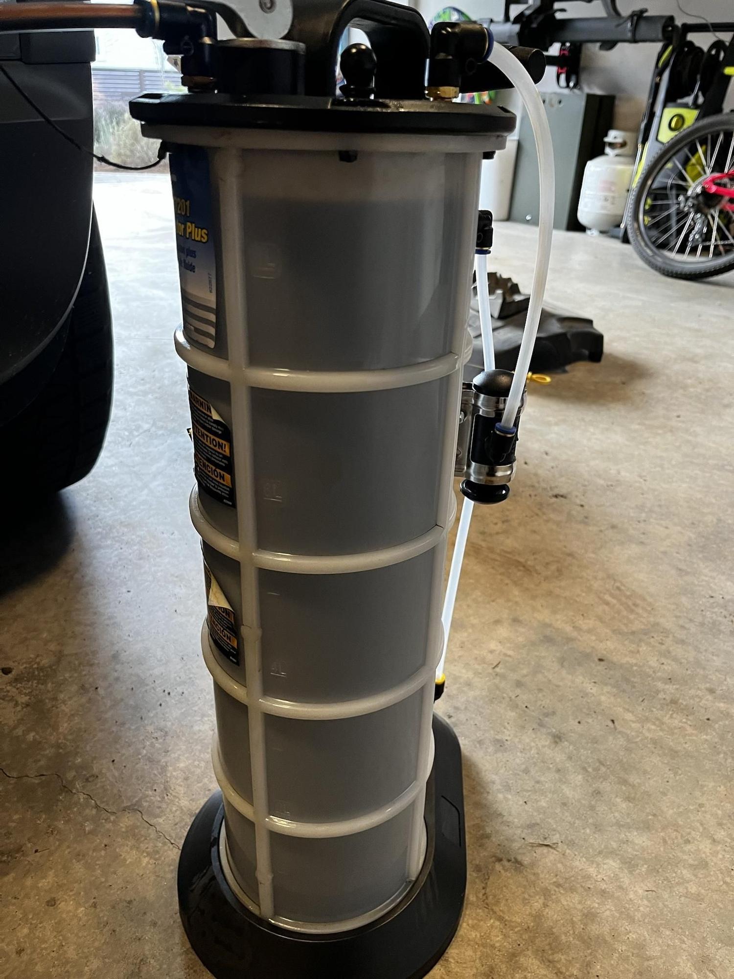

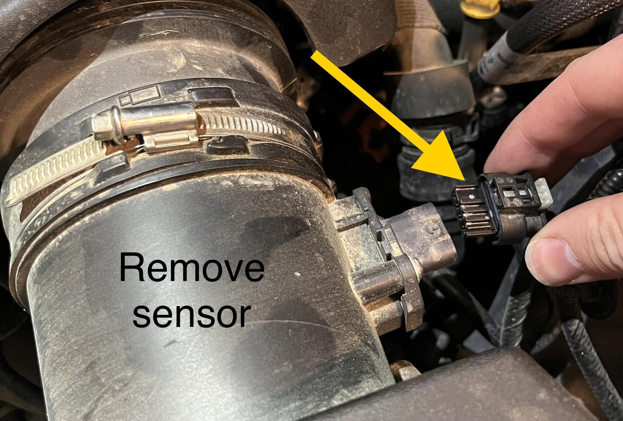

25,00 mile Oil and filter change. Almost 10,000 miles since the last one. I will get a sample off to Blackstone labs when their bottle arrives.
The pump is so handy. Works a treat. Pumps the extracted oil back into the empties also.
This is a 1 beer task.
It's important to stay lubricated. Happy St. Patrick's Day
Gave the plastic cover a wipe with an oily rag. #Fancy
8.8L removed and 8.8L of new oil goes in.

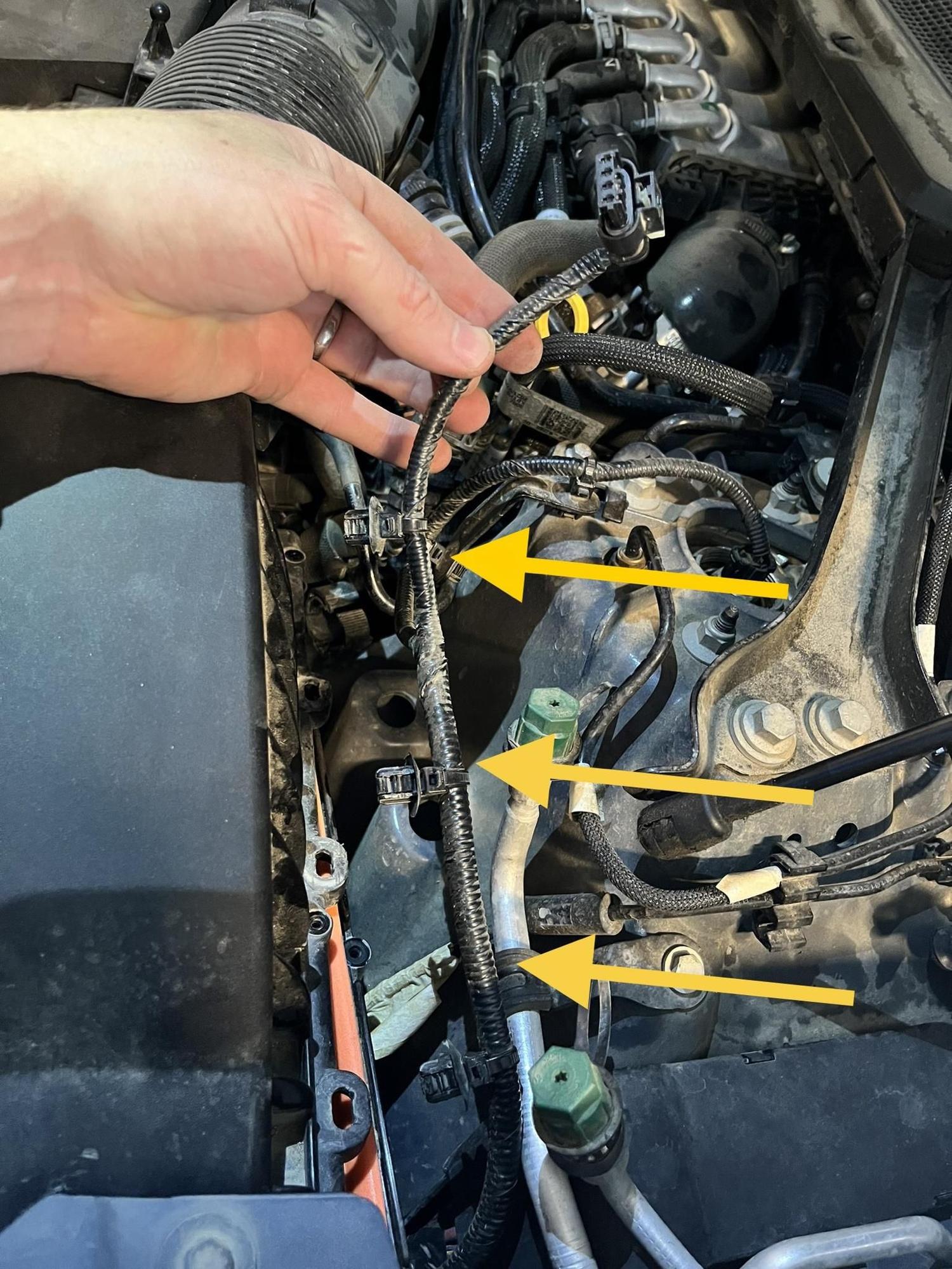

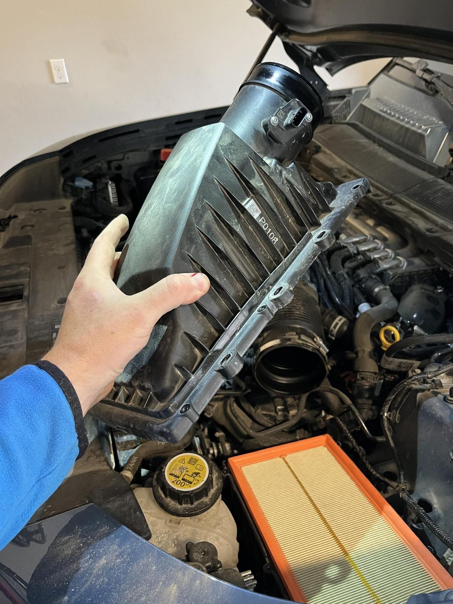

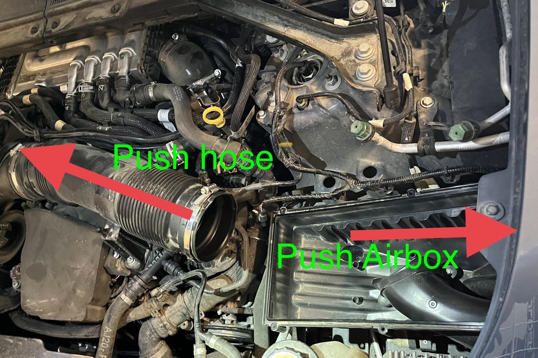

2 years old and time for some fresh filters again. LR sure do know how to make the little things complicated. Filters weren't too grubby looking but still fairly heavily laden with fine dust.
Cabin filter is a much simpler affair.
Fresh oil oil filter and brake flush in a 1000 miles or so.
