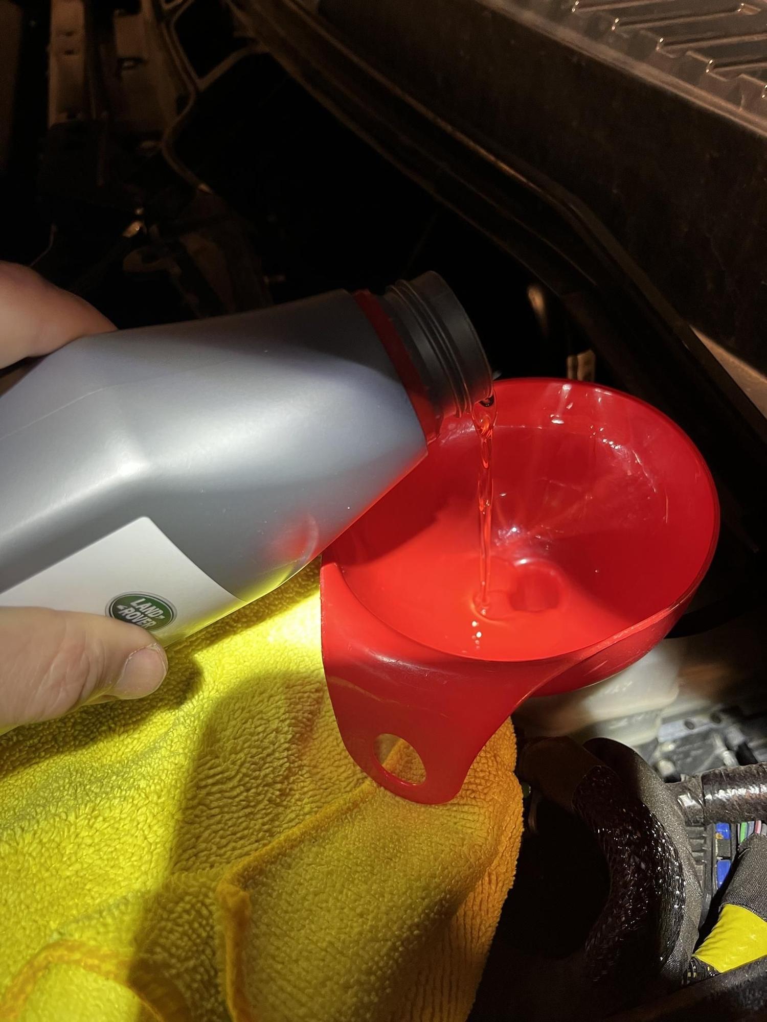

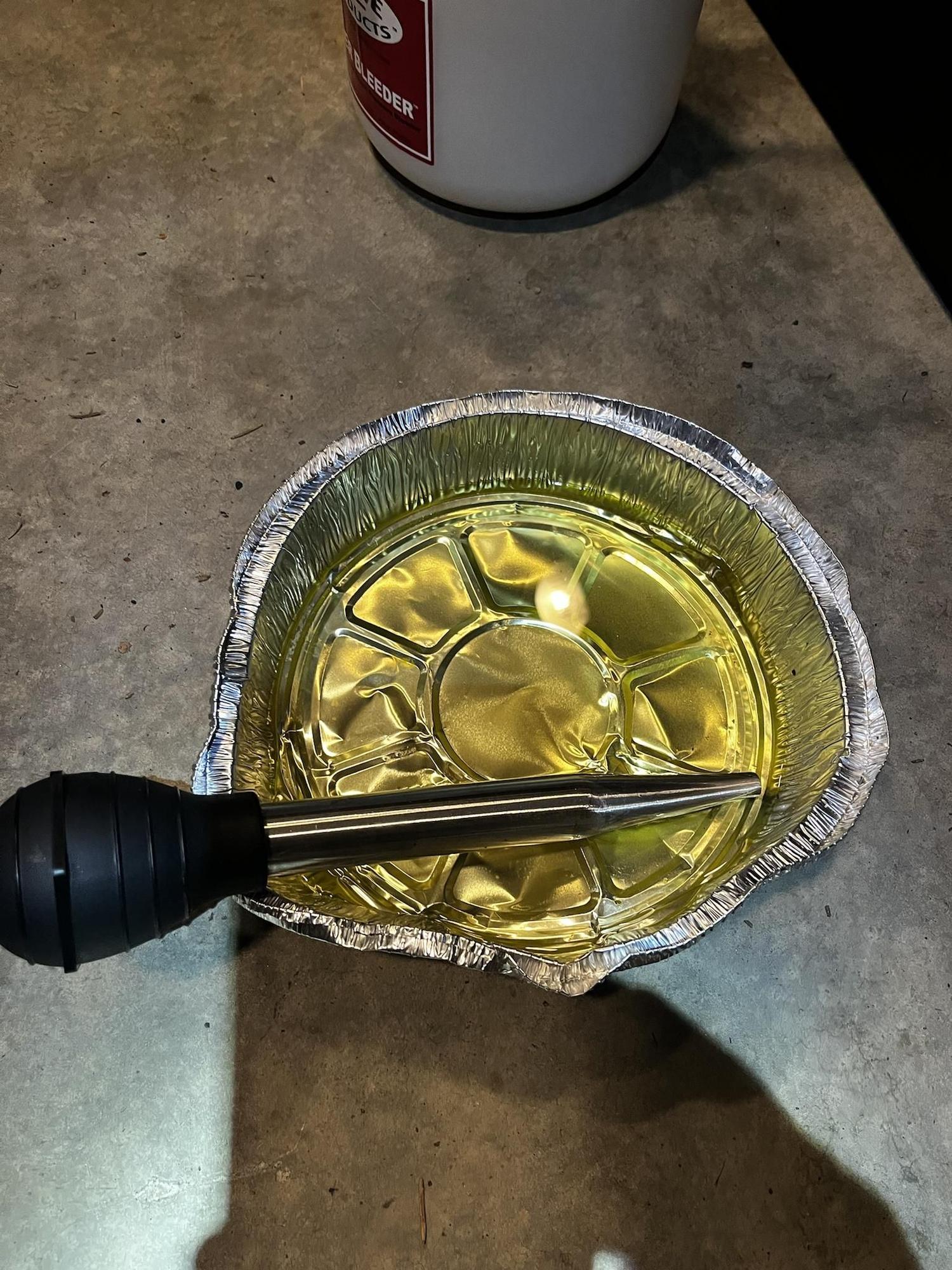

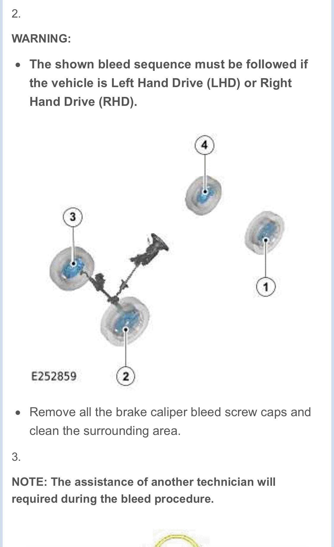

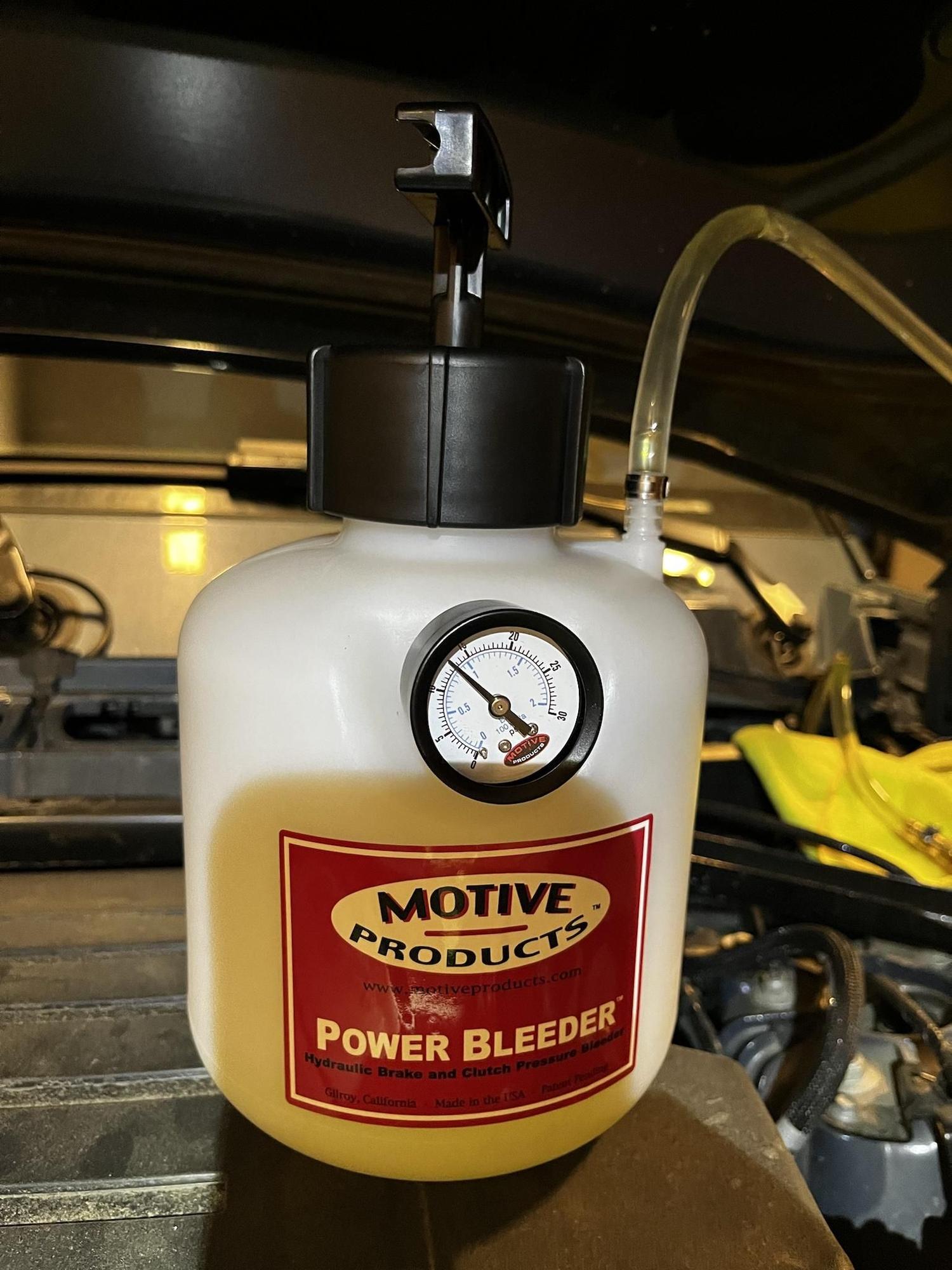

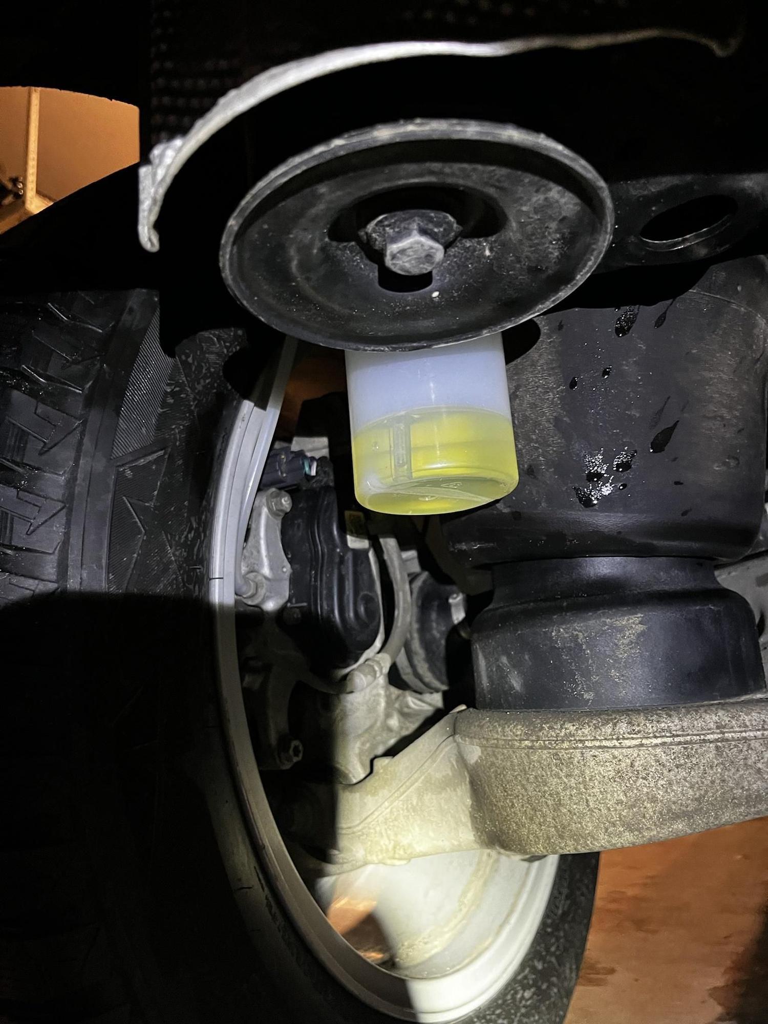

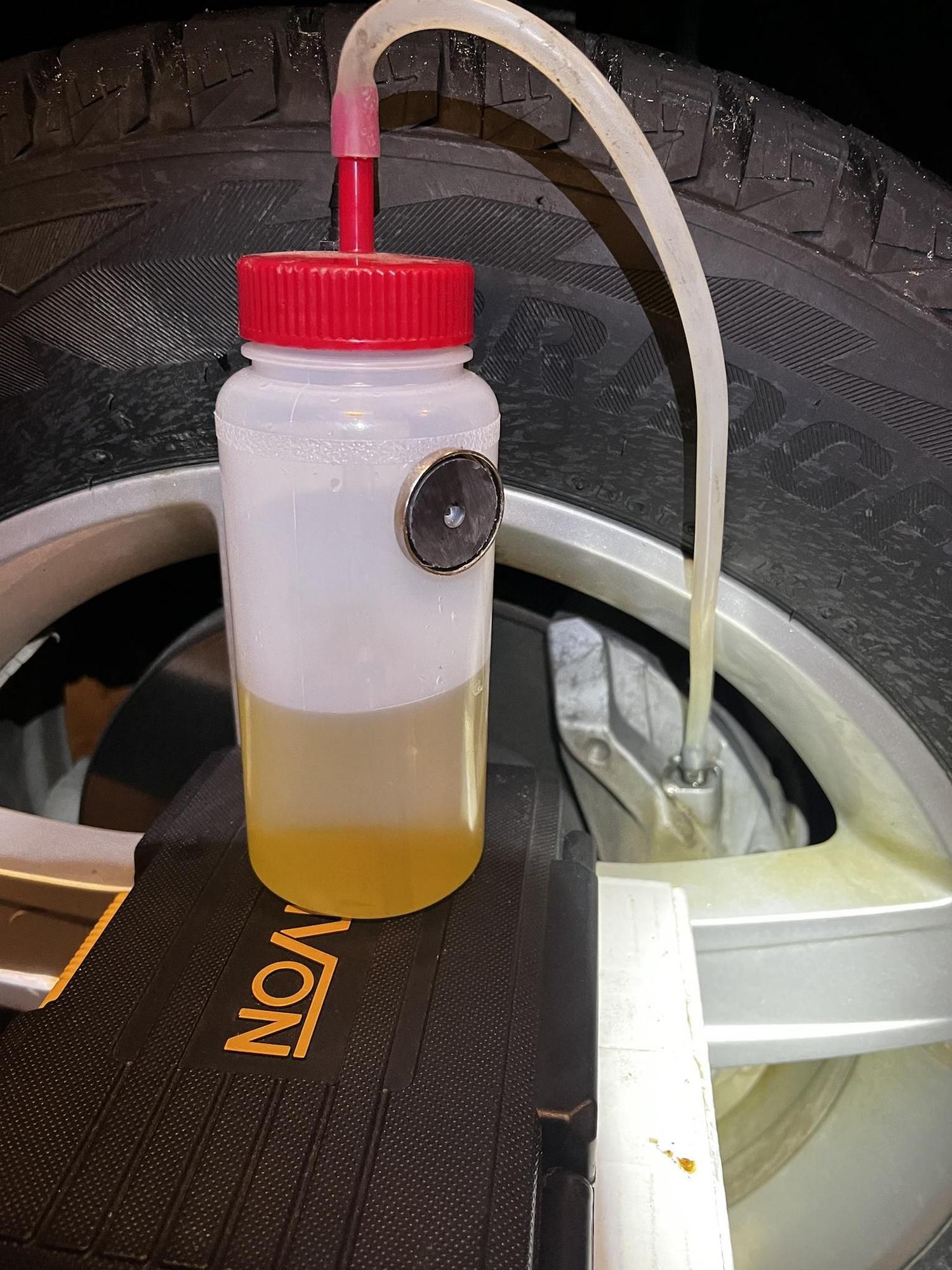

Blake flush completed a little later than ideal. 23,500 miles on the clock. 21,000 is what's recommended.
The fluid was perfect looking. No discernible discoloration.
Same process as any other car. I didn't use JLR's diagnostic tool as I don't have one. Drained and filled the reservoir before cracking the bleeder valves and flushing new fluid through at about 13psi.
The sequence is shown below.
A simple task made trickier by the fact that I couldn't find an 11mm spanner so used an 11mm socket to break the seal and an adjustable wrench to control thereafter
Remove the covers to access the brake fluid reservoir.
hi Gavin, thanks for the guide to brake bleeding.
I ask you for two pieces of information, before making bleed did you put the brake system in the service position? when you opened the valves on the brake calipers, and let the oil out, did you also press the brake pedal, or did you just use the system pressure?
thanks for everything.
Marco
Marco
I don't have an LR diagnostic tool so did nothing other than drain the tank and flush. I didn't use the brake pedal. Just the power bleeder. The online instructions do mention one technician pressing the brakes while the other does stuff.
