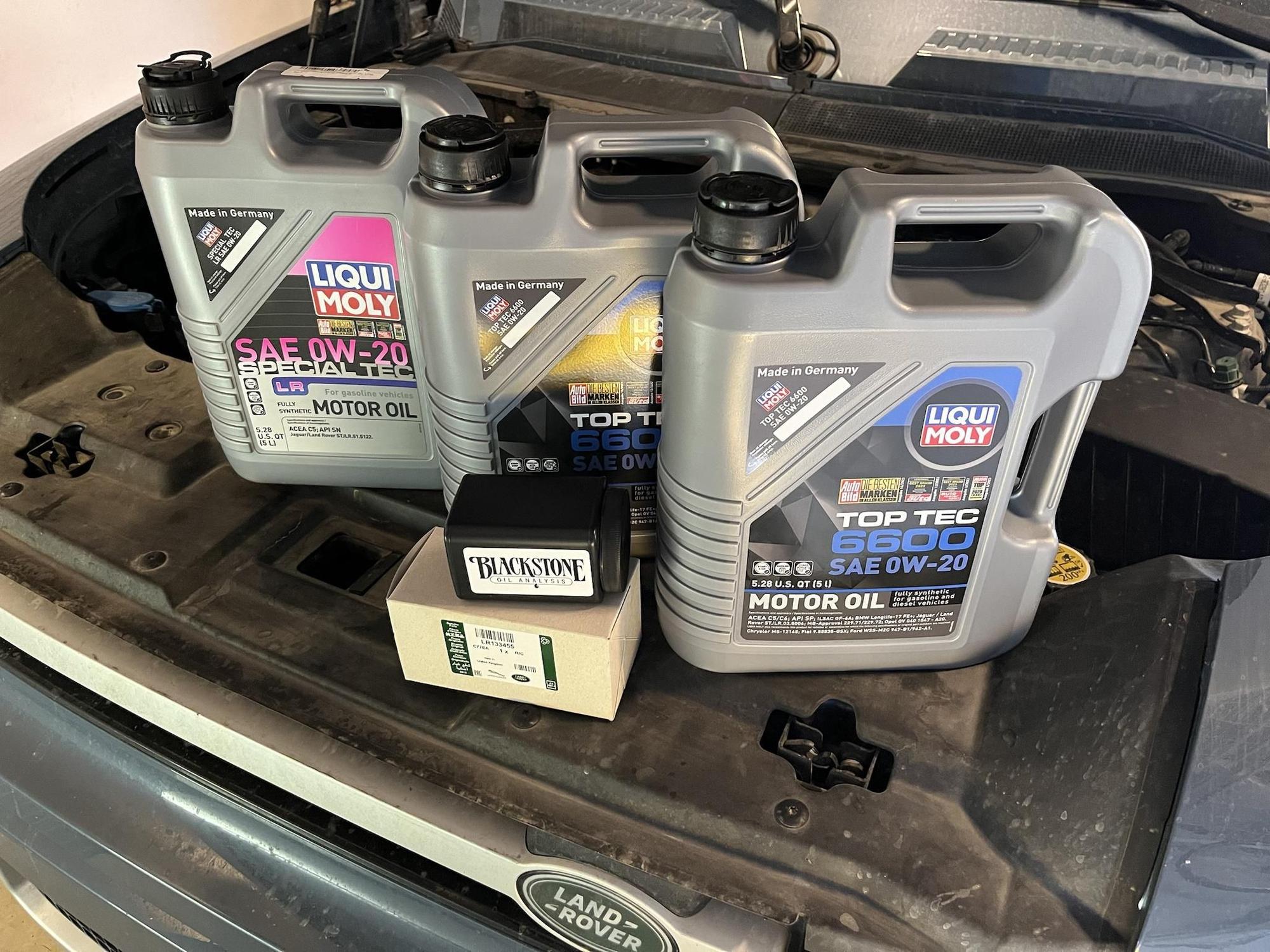

35,000 miles on the clock
10,000 miles since the last oil change
A mix of Liqui-Moly Top Tec and Special Tec. 8.8L added
New oil filter
Reset service interval
Sample for analysis.
Tunes in the garage.
About 30 minutes
Total cost is ~$150
Seems like I burned approximately 800ml of oil in 10,000 miles.

Wht the mix of oil?

I had 2.4 L leftover Special Tec from last change (1.2L leftover each oil change 10L bought -8.8L used. )x2
Decided to go with Top Tec this time.
6.4 Liter Top Tec.
2.4 Liter Special Tec.

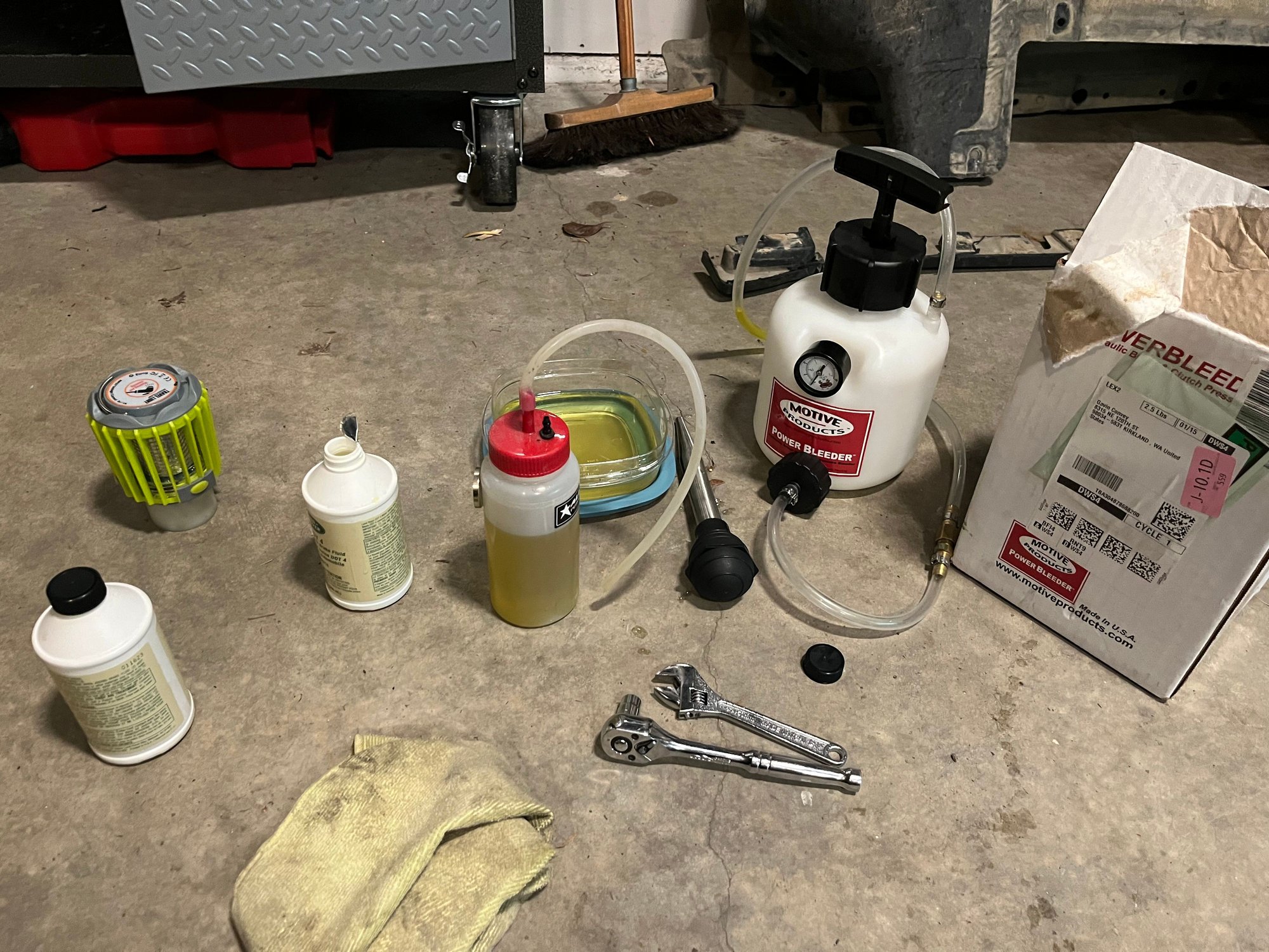

Default 42000 mile Brake Flush Defender 110
Completed a brake flush today. This is the second time I’ve done it
GAP tool used to activate service mode. this sets of a bonanza of dash warnings as it goes into this mode.
Pressure Bleeder, a one way catch vessel, DOT4 brake fluid. OEM.
drain reservoir and refill
pressurize system
service mode activated for the 4 brakes but must be deactivated to bleed the EPB on the rears.
sequence
Driver rear
Driver Front
Passenger Front
Passenger Rear
EPB driver
EPB passenger
About an hour if you’re slow like me.
Pressure at about 1.5-2 bar
GAP4 used. GAP 3 also works.
Catch vessel 5cm above bleeder valves.
