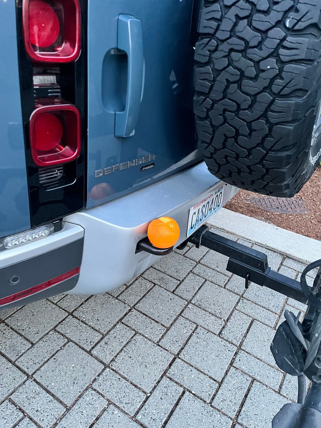

With the miles creeping up I’ve decided to shorten my oil interval to 8,000 mikes.
Got to tinker with a mate’s Defender. Installed his tow eyes. L’orange looks good on Gondwana.
bonus Grenadier action. Helped fit this Expedition One bull bar.
A great fun weekend.

This was my second time installing these after doing my own some years back. The bumper removal is very straightforward but I wasn't sure what extra was involved with the rear mud flaps on this one.
The two top bolts holding the mud flaps need to be addressed. An 8mm Nyloc nut and two washers on each are removed. Then it all comes off with ease. The flaps also made repositioning of the wheel arch liners more difficult. Took me a while to figure out the process.
You do not need to remove wheel arches. Just carefully finagle the bumper off them. Very doable. Especially important if you have the extended wheel arches. Best not to mess with the adhesive on these if possible. It'll never be the same.
All in it was 3 hours for the whole thing. I'd estimate less than half that without rear flaps in place.

@Myron Thanks mate
There are no clips or anything like that you'll lose. The wheel arches don't need to be messed with. The bumper is just a combo of bolts and screws, some plastic clips in the wheel liners (WD40 is your friend in getting the two recessed ones back in), one big electrical connector and one small camera connection on the LHS. One water pipe on the RHS. As mods go this one is fun and stress free. Get stuck in.
125ft lbs or 170Nm on the bolts for the tow loops.
WRT the bumper sticker, divorce proceedings or at the very least, an unwinnable debate, would be prompt and tiresome, if I decided to embellish my rear. I do appreciate the generous offer though. Thanks again.
As an added note, the OEM trim pieces for around the tow eyes are very well made. Fit beautifully. Now I have a bad case of L'orange envy
