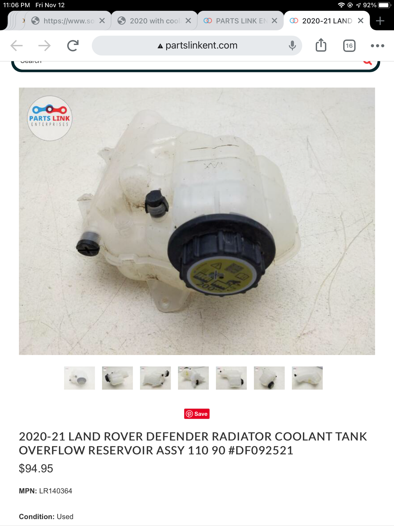

Look, I understand the moral high ground of “it’s under warranty the dealership better fix it!”
But as a Man, seriously, I would simply buy the part ask the dealership to install it if it fixes it great, if not then wait for the new part, but I would never ever let my dealership hold onto my car. Ever.
I give my service advisor a 100 dollar bill when I need warranty work with the understanding that I will be there at 7am and stay at the dealership all day until it’s fixed. I literally pull up, they diagnose it, waited 2 weeks for the coolant reservoir tank to arrive like my 2020 had problems like yours, and the came back two weeks later and they installed it while I waited. That was worth 100 bucks.
But go ahead Custer, make your last stand on that hill, let them ransom your very expensive vehicle. I think it’s hilarious that most guys can’t see the big picture of what it takes to get service done.
I would buy this 90 dollar part and install it myself waiting on the dealership part.
but ok boomer drive a raggedy loaner or go vehicless.

Understandable. It's a cheap part but I'd probably not do that either. Mainly because I've been through leaking coolant 3x with new JLR products and it's never stopped me from just driving it while I wait.
Identical symptoms. 2-3 weeks or so after a top off, it gives a low coolant light. A spray bottle with straight Simple Green (cold engine only) and a rinse to clean off any coolant residue followed by a top off with distilled water gets it ready for a quick leak test. Just run the engine with the hood up until it gets to temp and watch for steam from a leaky hose. Use a flashlight. It might not be obvious.
If you see a small leak, just keep it topped off with distilled water (fine to do a couple times) or JLR orange coolant and I would personally drive it anyway.
If there's no visible leak, could be another issue. The sensor mentioned by others or a bad head gasket sucking coolant. Maybe don't drive it then but the part numbers you had were for an interior arm rest (?) and a coolant hose so it sounds like your sa already spotted the leak and determined it's the hose.

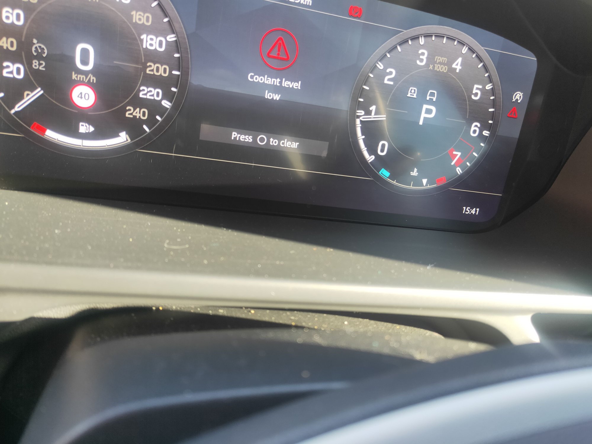

Unfortunately, I seem to have run into a snag. I got a Low Coolant warning on the dash. Figured it was just not filled up properly from the factory and stopped by the dealer. They topped it off.
A few weeks later, light came back on. Took it back to the dealer and they told me the vehicle is not drivable, leaking coolant, and needs coolant hose and a seal (LR part numbers LR121714, LR121762). They are currently quoting 2 weeks...
Does anyone on the forum have a lead/ ideas on how to get these parts delivered faster?
