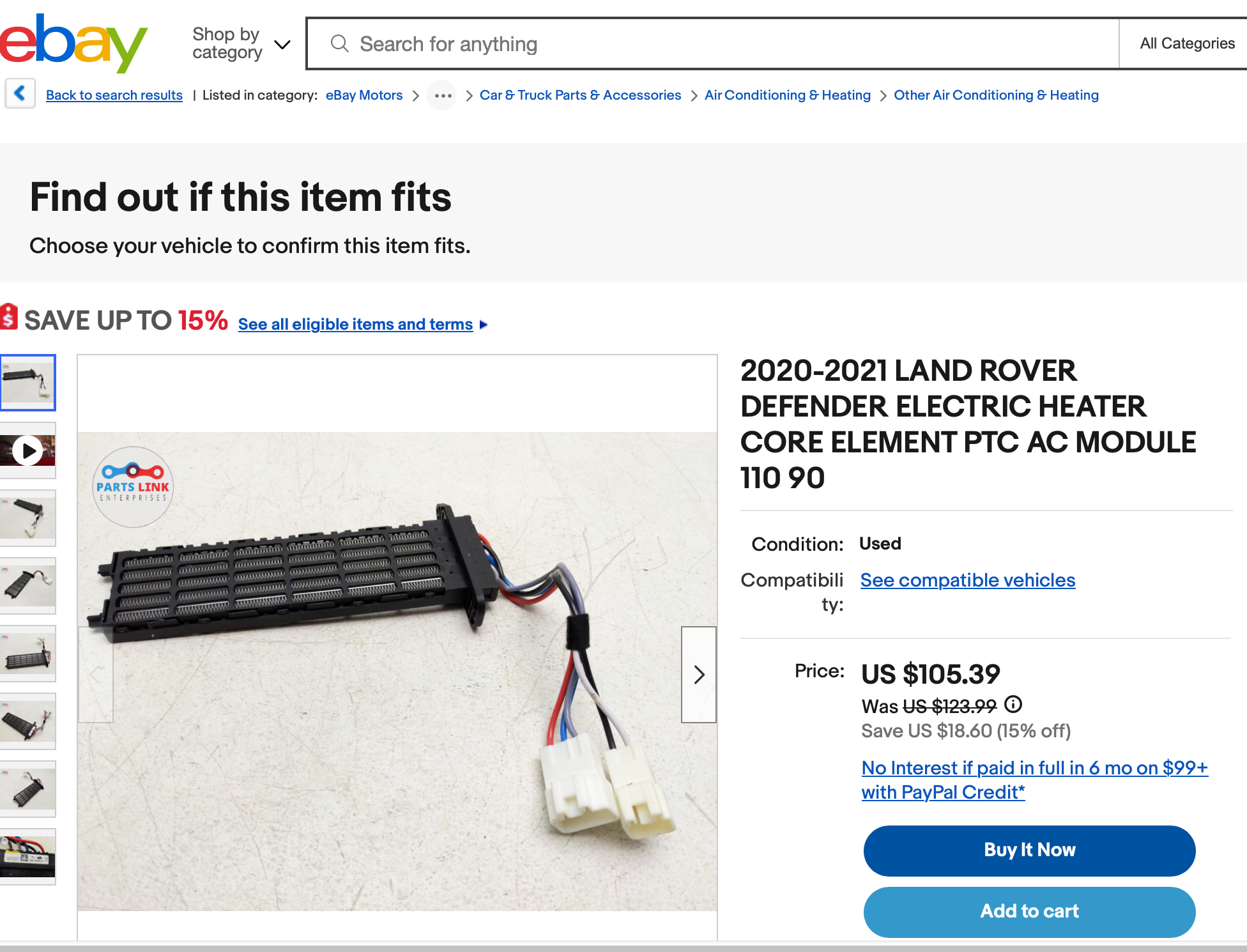

I've been banging on about this for about 2 years now but I finally found proof that a 2020 Defender (110 X like mine) has the aux electric heater installed. Here
In the past 24 hours, I've driven 3 LR's....my very scientific study is as follows:
2020 Defender - takes at least 2.1 miles for the heat to be felt in the car normal city/suburb driving. Does not matter in auto, or manually cranking temp and fan.
1988 Range Rover - warm air 2 blocks down the road
2000 Disco 2 - warm air begins about 1/2 mile down the road
I am 100% convinced that there is a glitch with the computer programming in the 2020 L663. This aux heater is not turning on, if it were, I would get heat! The whole point of the aux heater is to kick the heat in earlier than the engine coolant, I believe.
