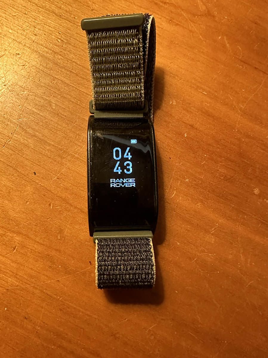

I added an Activity Key today using the GAP IID tool and it behaves differently than my Keyfobs.
- Approach unlock/lock doesn't work (I have approach unlock/lock activated via GAP IID and enabled in the UI)
- I can unlock the car using the button on the door handle, but I cant lock it that way
I'm curious, if anyone here has an Activity Key and Approach Unlock activated, does yours behave the same?
Did you ever get this figured out? Mine does the same thing. I reverted the CCF settings back to Disabled for both approach and walk away locking, and that restored my ability the use push button on the handle with the Activity Key again.
I also never got approach unlock to work correctly with any of the key fobs. It's not the end of the world but would be nice to have full functionality.
No, although i haven't fiddled with it. So when you disable the approach unlock/lock you can then use the button on the door handle to both lock and unlock? Mine will only unlock that way, it cant lock the car.
Other than that, my approach unlock/lock works with my normal keyfobs, just not the activity key.
I had to disable it via the CCF. Toggling it on Pivi wouldn't restore function. I spoke with Patrick at GAP about it and it's most likely a software issue -- the functionality may be partially there but not totally integrated as it was never released as a feature on these cars.

I have an activity key that I maybe have used three times in over 2 years. I go boating, skiing, you name it and i guess I don't need another thing on my wrist - though I could put it in a pocket and be less worried if it gets wet I guess.
