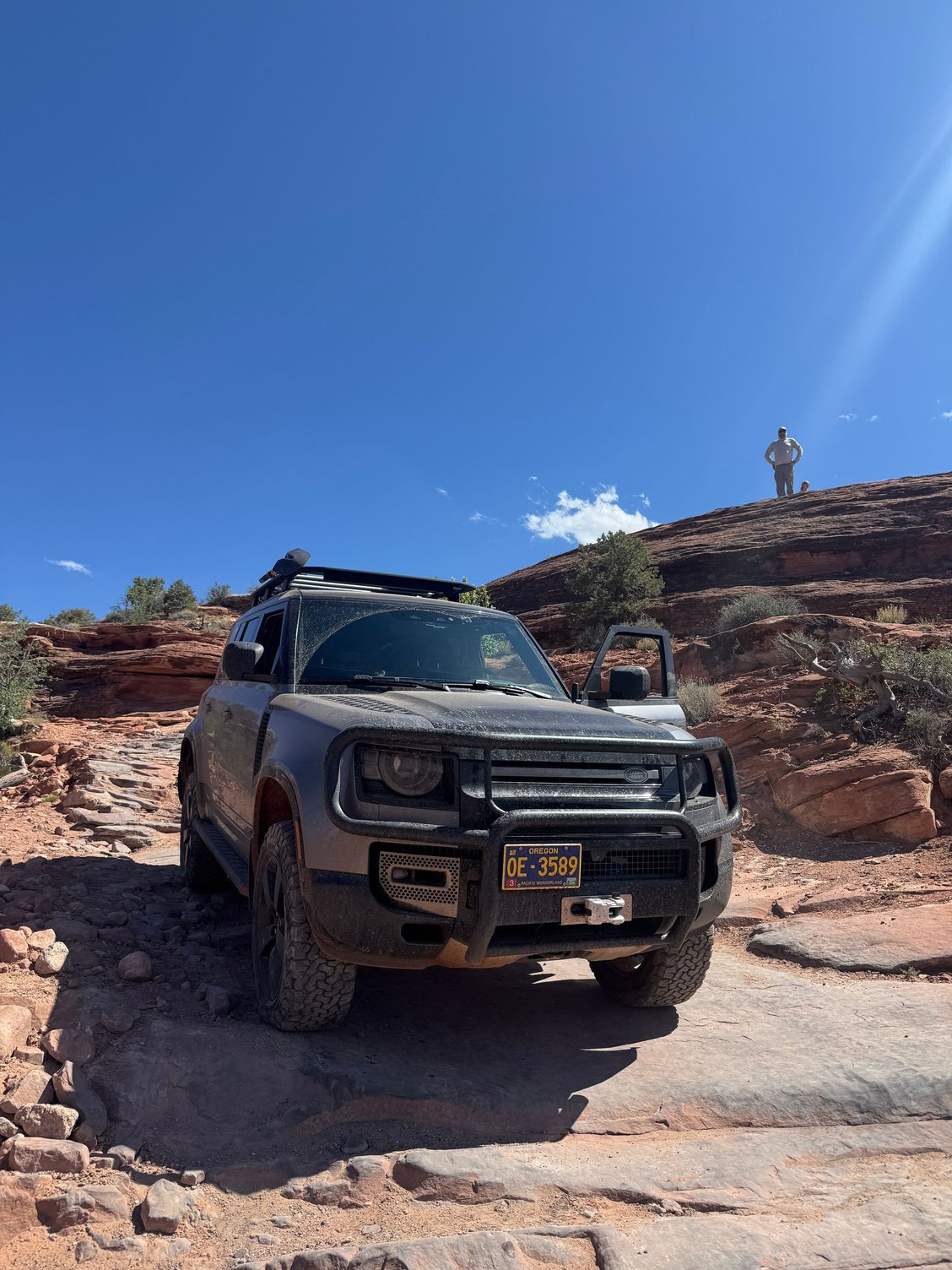

I definitely knocked my 110 out of alignment roughhousing on my Moab trip recently. Not surprising given the abuse and rocks.
I’ve had it aligned 2x since new, both at the dealer. Problem is, that’s like $500. Obvious cash grab but ... they do seem to do it properly.
If I just go to a regular tire place / alignment shop -- will they know what to do -- do I need to put it in “tight tolerance” mode with my GapIIDTool like I would have needed to on an old LR3/LR4/RRS? Or does it not matter?
Any experience?
