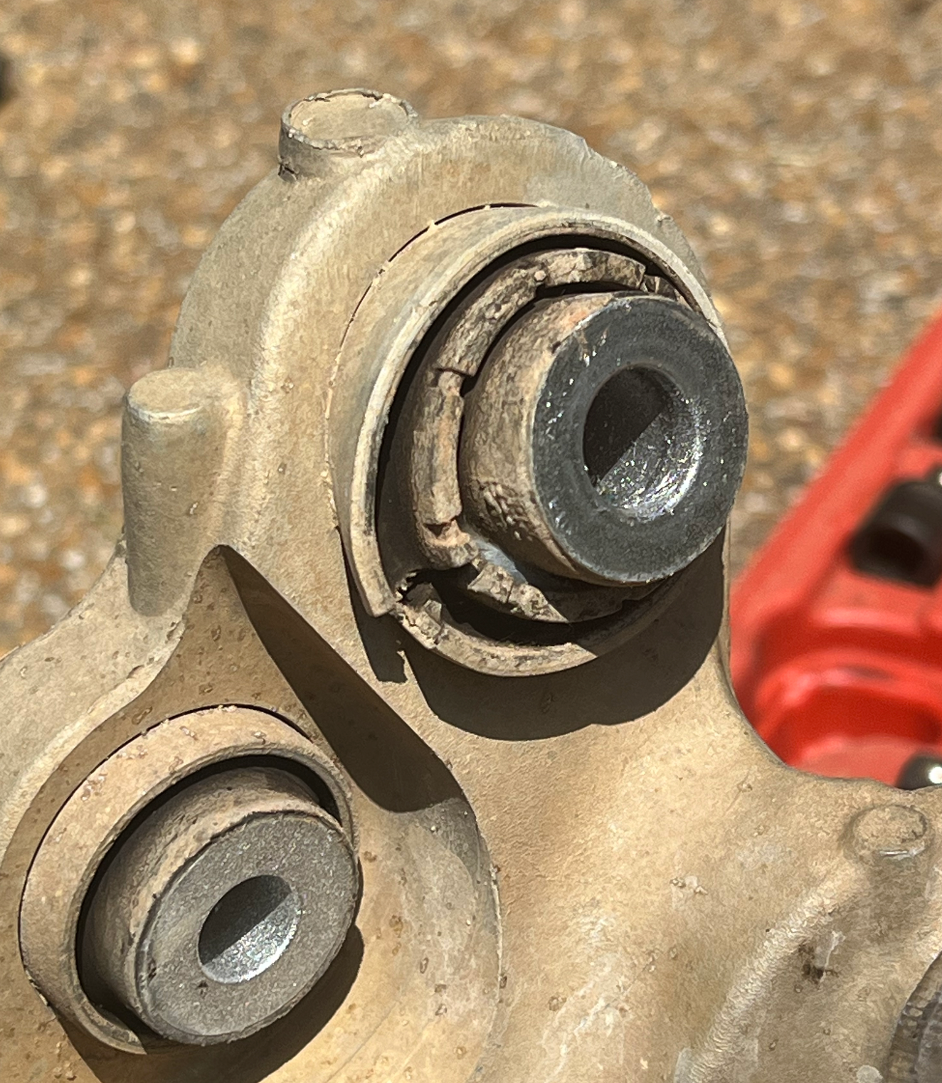

Thanks Ralf! Well I pulled the knuckle, not too bad to do. The bearing is definitely bad and I'll work on pressing that out this weekend. However, I've run in to another issue. The bushing that connects to the lower control arm is also spent. See photo below. I've looked at the LR Parts diagram (here) and was puzzled by the absence of any part numbers showing for bushings. I just called my dealer and they told me that they don't sell just this bushing. You have to buy the whole ($1,400+) knuckle! That is insane. I'm digging around to see if I can find the right part elsewhere but am a bit frustrated by this.
Posting here in case someone has some guidance/advice/experience with this.

Thanks Ralf. Pulled the knuckle and the bearing is indeed bad. Gonna work on pressing that out and replacing this weekend.
However, I found the control arm bushing is also bad. Called dealership, they tell me that they don't sell just the bushing, have to buy the whole $1400+ knuckle. I have a hard time believing this, but it is not in the parts diagram. Anyone have any thoughts or insight?
You are correct in that JLR does not sell this bushing separately. The whole knuckle is the factory fix. We are currently working on a HD replacement for this bushing since this is a bit silly that it is a wear item.
