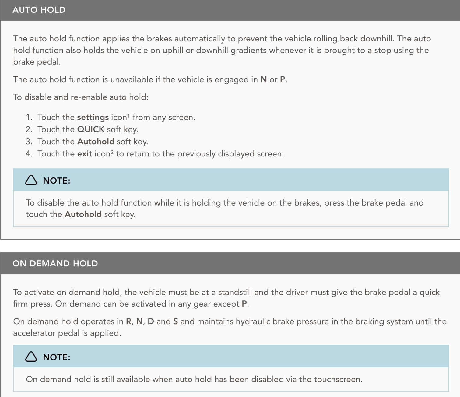

This is pasted from the manual. There are two versions of BRAKE HOLD. AUTO HOLD and ON DEMAND HOLD. Auto Hold is activated through the soft buttons using the PIVI screen. Brake Hold is always available whether Auto Hold is activated or not. I use Brake Hold often, but it sometimes is confusing to those who aren’t aware of it and unintentionally activate it by an inadvertent extra hard press on the brake pedal.
