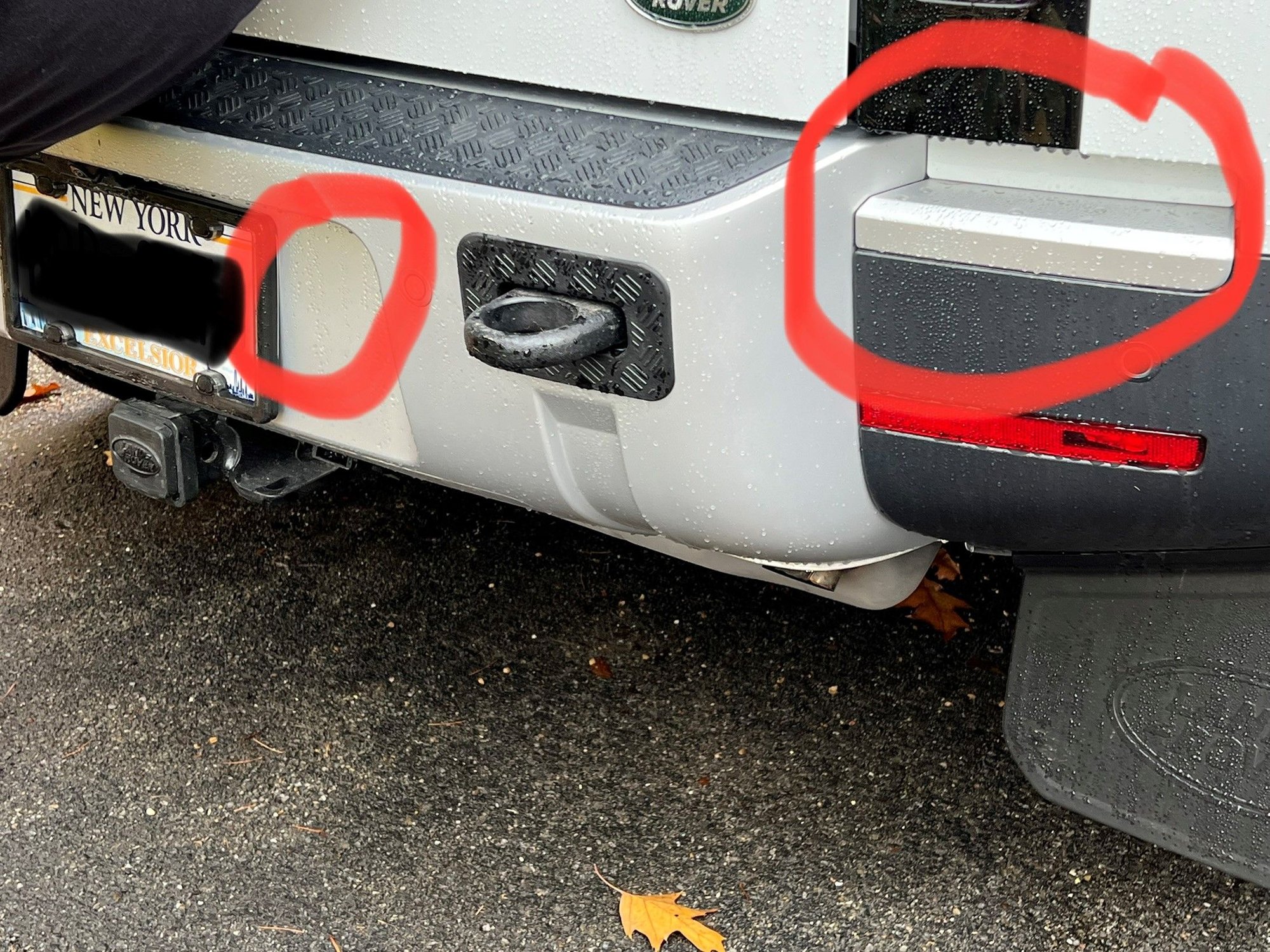

Originally Posted by teej
Has anyone mounted reverse lights under the bumper, maybe flanking the tow hitch?
I'm installing some KC HiLites C2 Backup light system on the bumper (somewhere...picture below red circles) this weekend using my Switch-Pros switch panel and PowerfulUK's wire tap for the reverse signal. I will be able to use them as reverse lights (switchable) and/or be able to turn them on/off whenever I want. I don't want them hanging low because I hammer on my 110 off-road. I've had the rear bumper off already when I installed the rear tow loops...should be an straight forward install.
I'll post my install...Stay Tuned.
