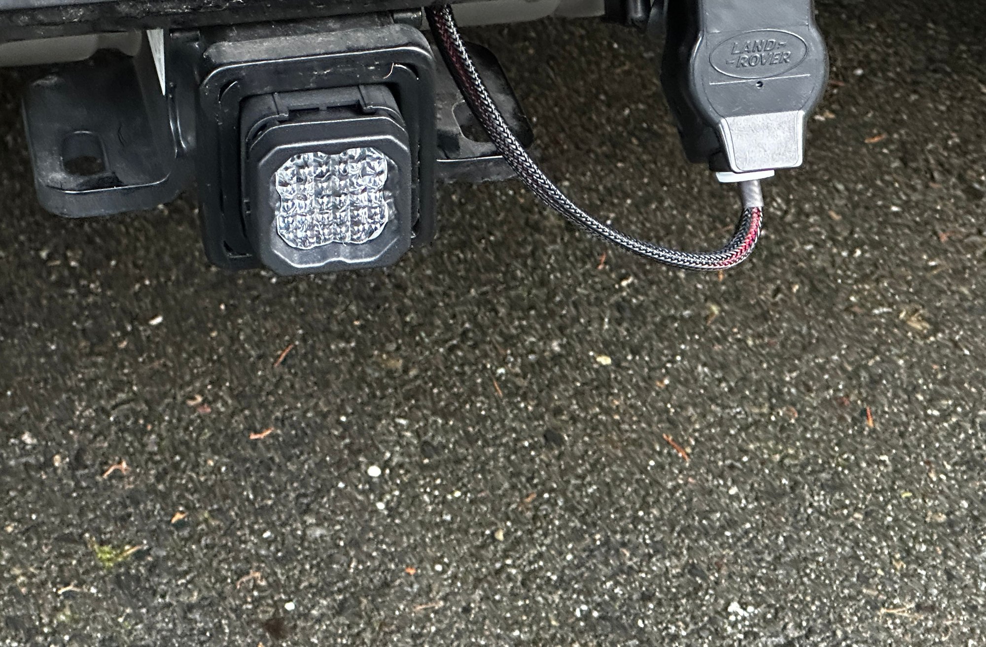

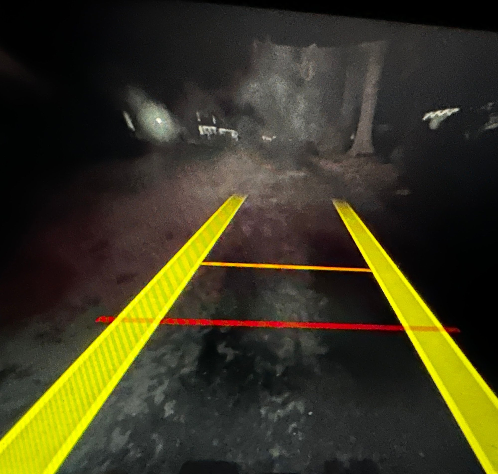

I'm about 1500 miles in on my Defender 110 and besides the OEM tires (Scorpions, replaced at about 500 miles with Cooper AT3's 275/55/20's) the backup lights have been the only other disappointing feature. We get a lot of dark rainy nights in the Pacific NW and the stock backup lights might as well not be there on some nights. I was searching for some hitchmount solutions and stumbled across this product linked below. It wasn't clear if it would work on the Defender though so I took a bit of a chance. As it turns out, since the harness is designed to go inline behind the existing 7pin trailer connector it wouldn't work as designed on the Defender, at least not that I could tell without taking off the bumper. I ended up just clipping off the LED plug portion of it and buying a 7pin trailer end connector for $10 and hooking the plug up to that which took all of 5min. A little dielectric grease on it and good to go. Total cost was about $110 plus some tax. Links and pics below, just another possible option for those that are looking!
Hitchmount light Hitchmount light
7 pin plug 7 pin plug
Plugged in. I rerouted the wire over the top and out to the right for a bit cleaner look.
Before
After

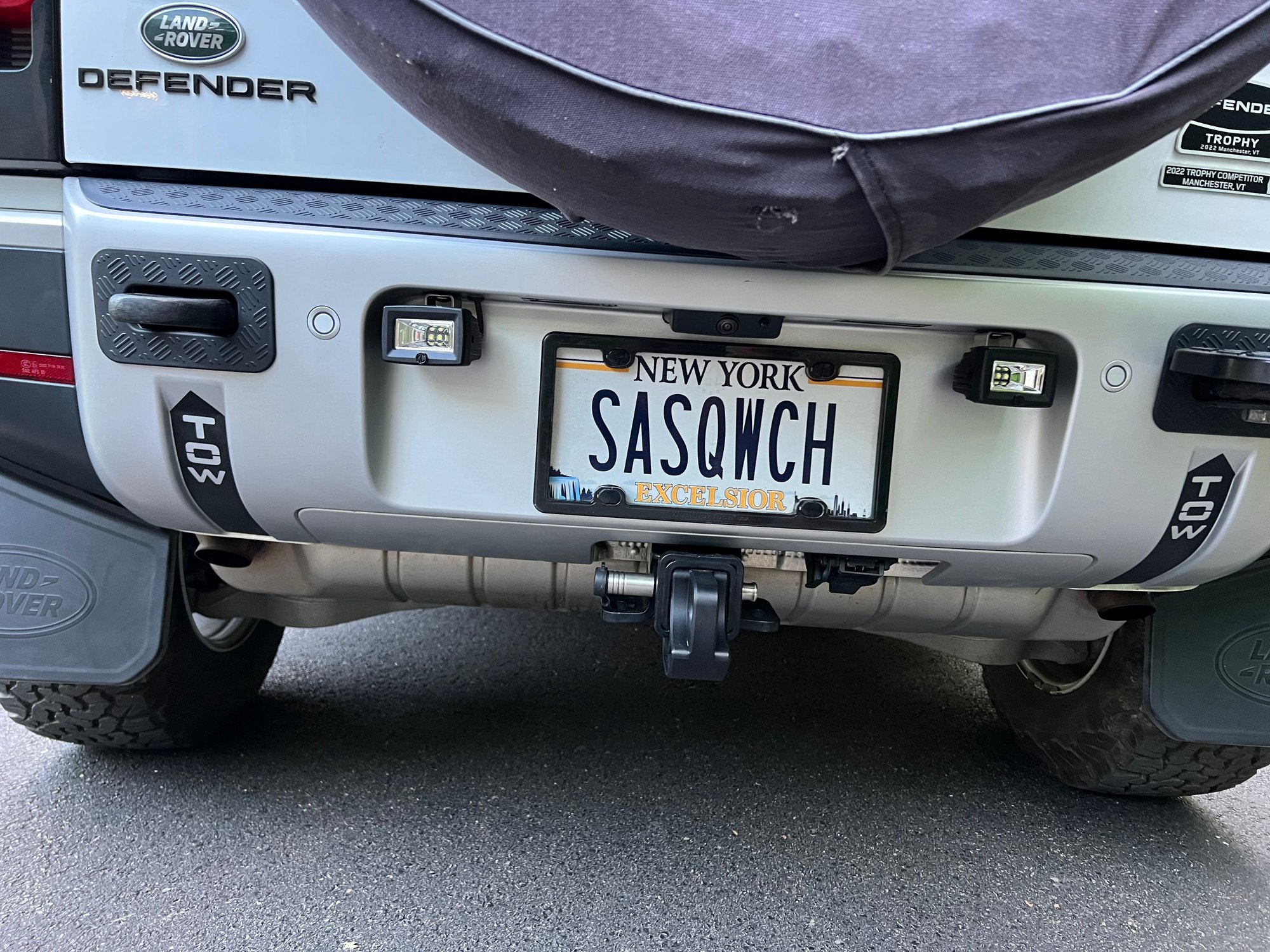

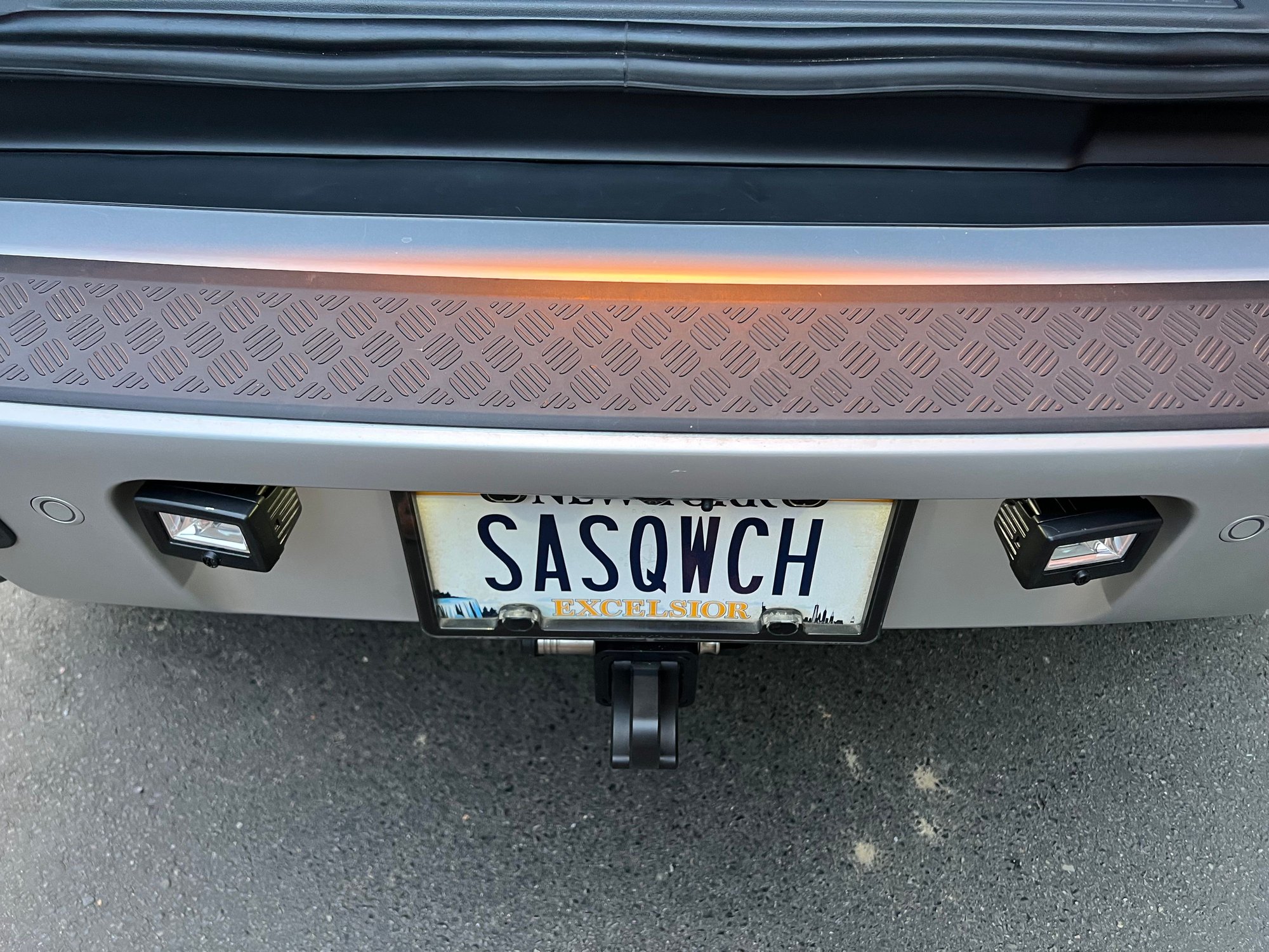

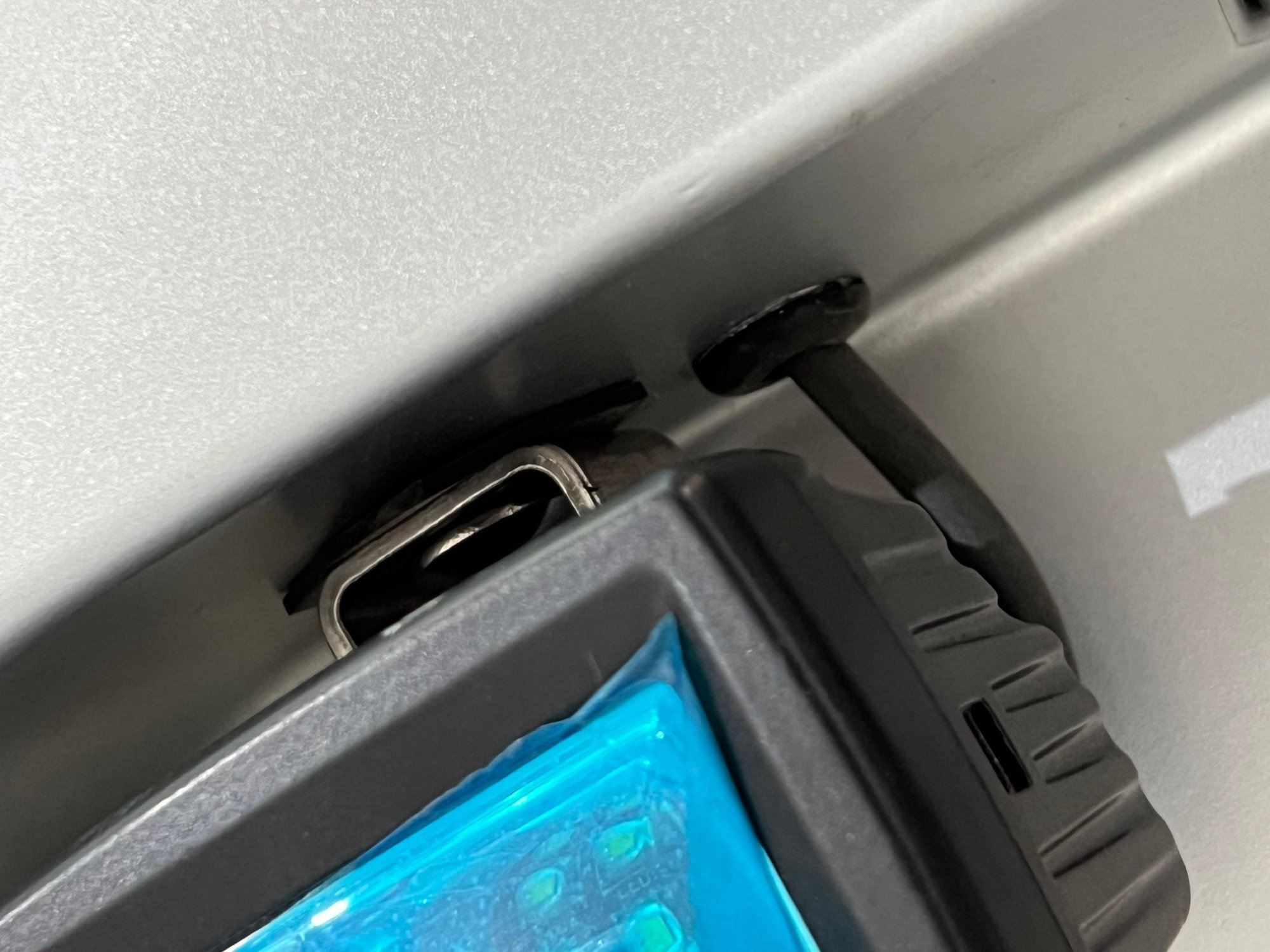

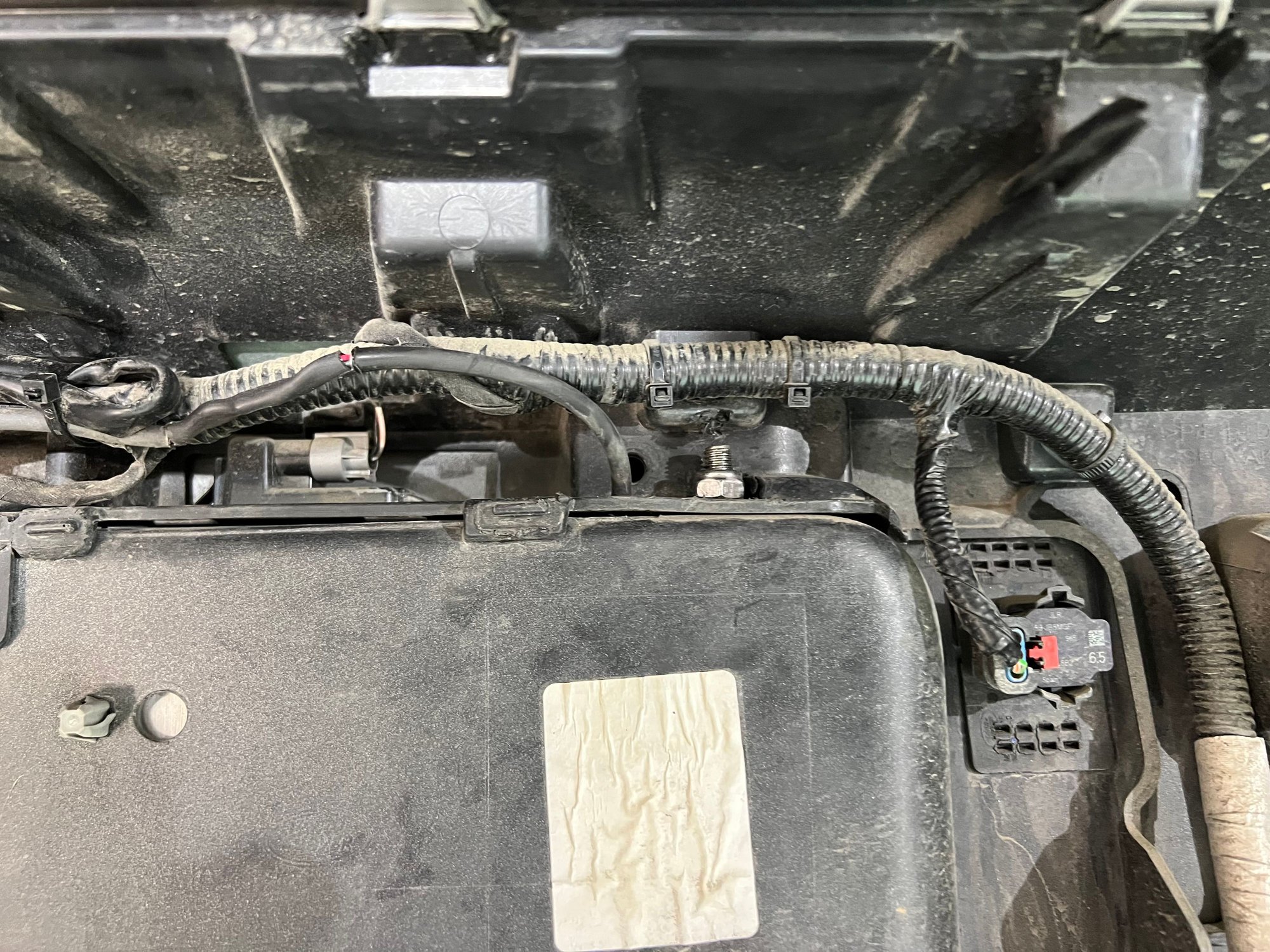

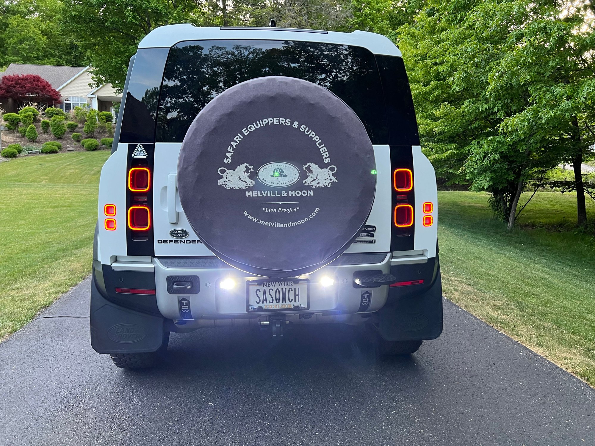

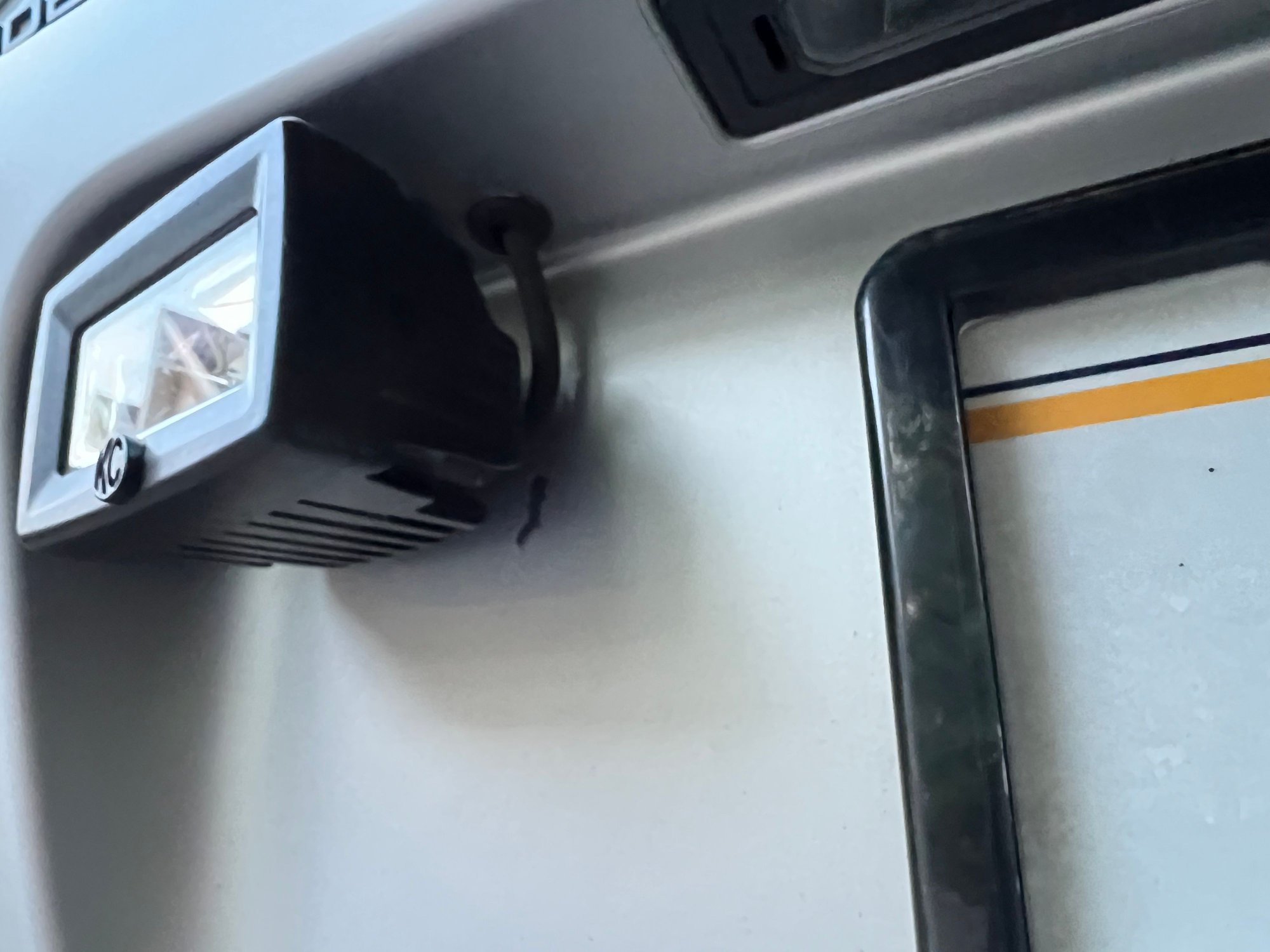

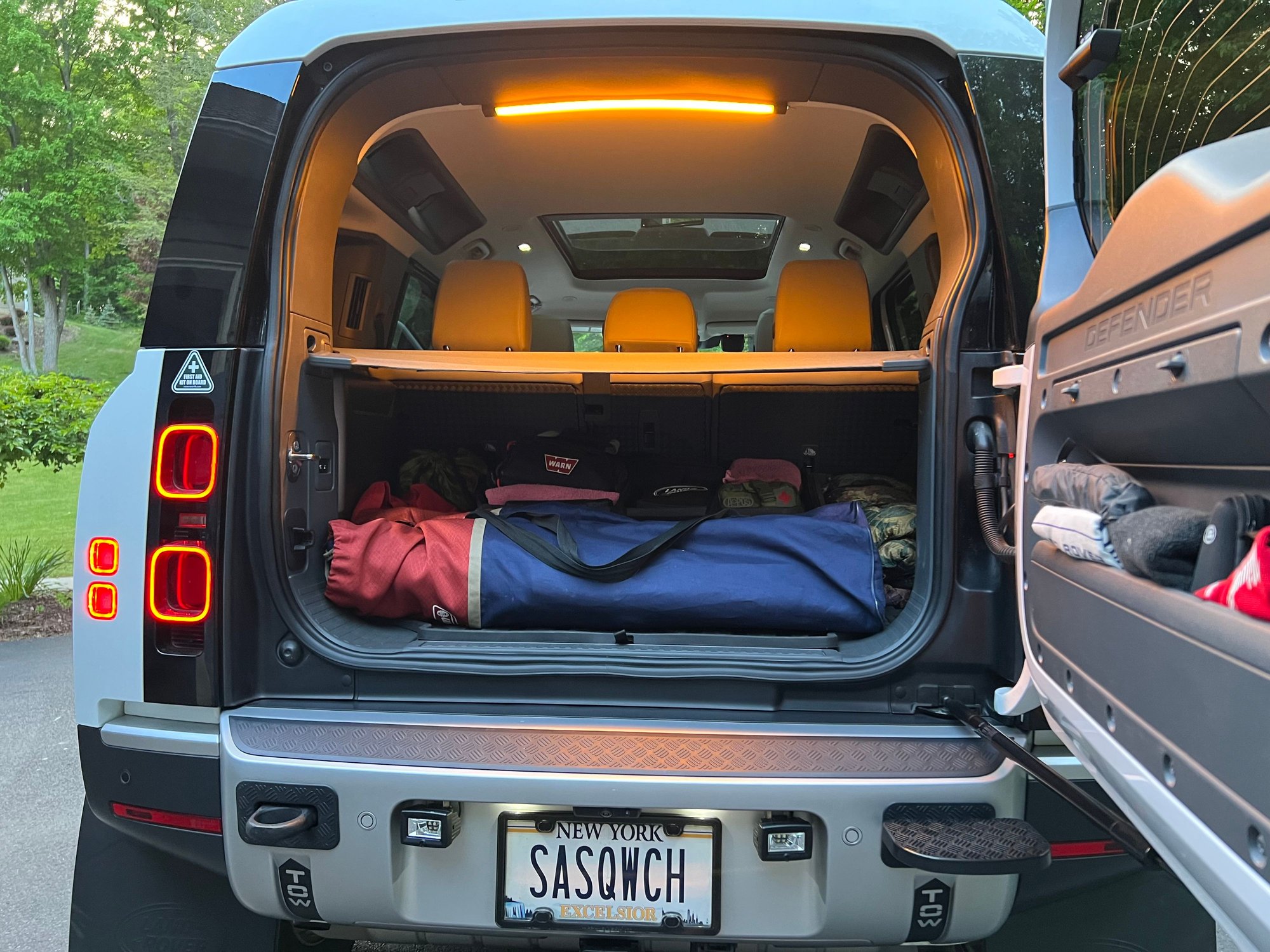

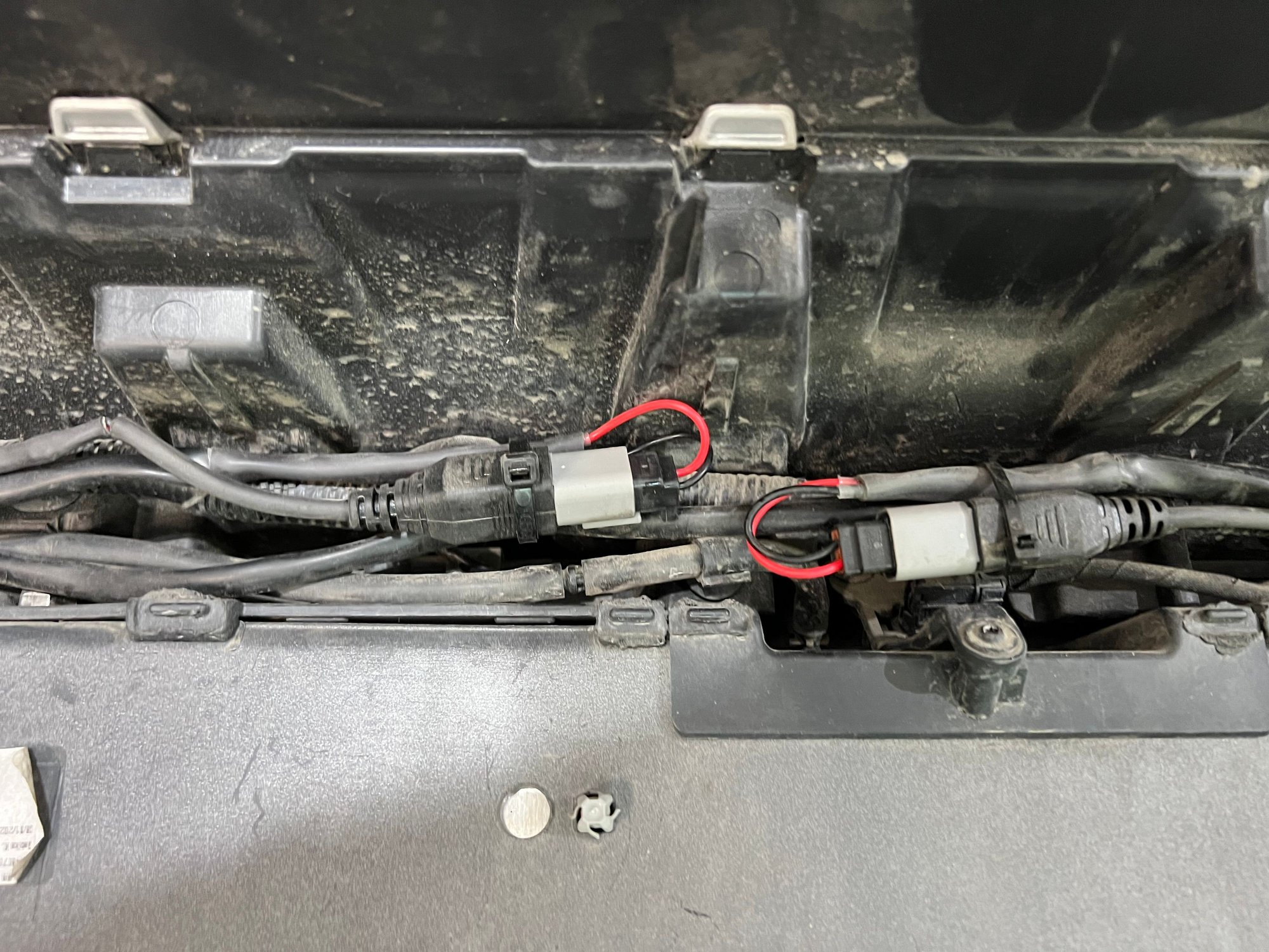

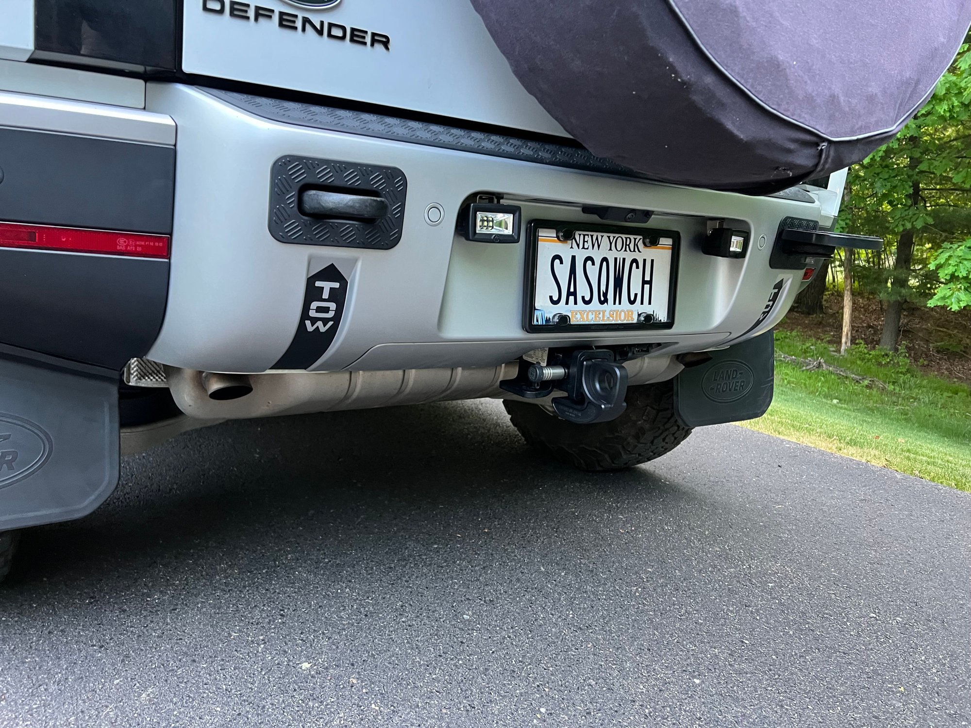

Installed some KC HiLites C2 Backup light system on the bumper using my Switch-Pros switch panel and PowerfulUK's wire tap for the reverse signal. I am able to use them as reverse lights (switchable) and/or be able to turn them on/off whenever I want. I didn't want them hanging low because I hammer on my 110 off-road. I've had the rear bumper off already when I installed the rear tow loops...was a straight forward install...tucked all the wiring into the bumper cover for a clean install.
https://www.kchilites.com/2-c-series...ystem-519.html
