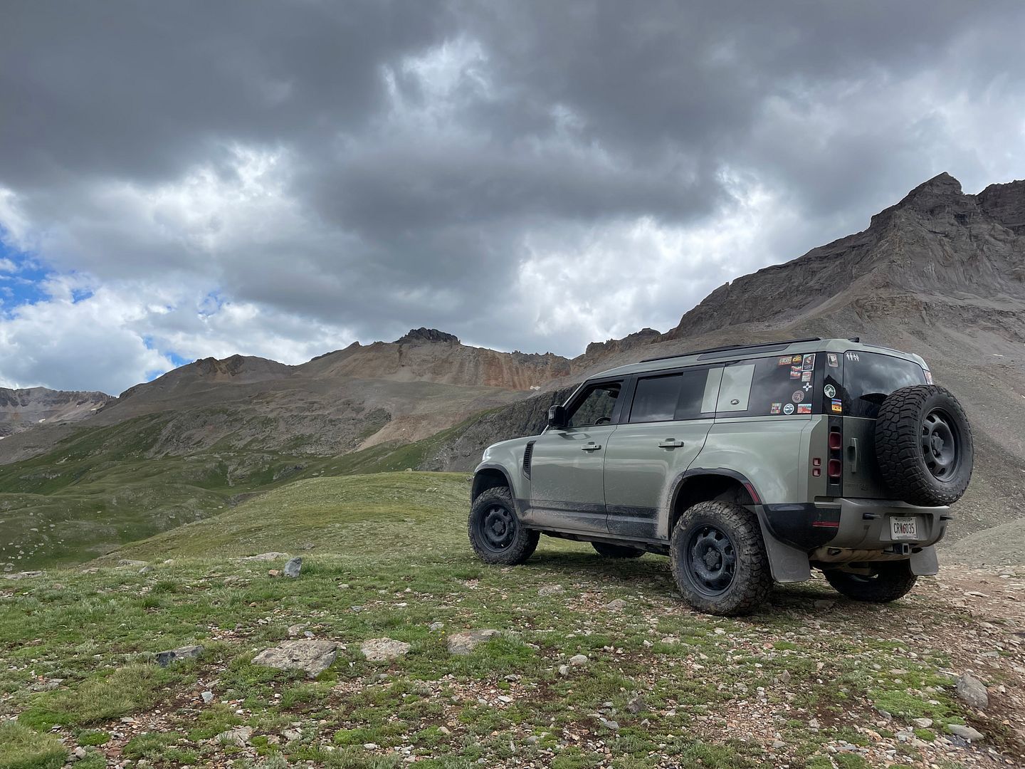

My P400 110 with LK8 rear caliper conversion requires spacers (25mm, iirc) in front, and no spacers in rear. OEM 18” steelies.
Correct. Or you can grind a small amount of the front caliper off at the top edge.
