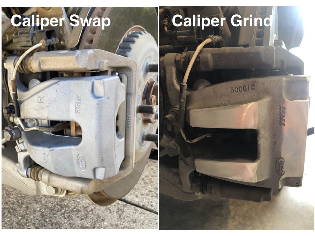

just wondering how hard was it to grind down the calipers? I am desperate to do the same for my P400 X. Wish there was something that was more plug and play.

You can swap calipers out if you have the regular P400 rotors and not the even larger ones that come on some of the models with 22" alloys.
Grinding is not difficult just takes a while if you're new to it. I am slow and a veritable novice when it comes to this stuff and it was a bit of a grind. Some rims will need less mod than others.

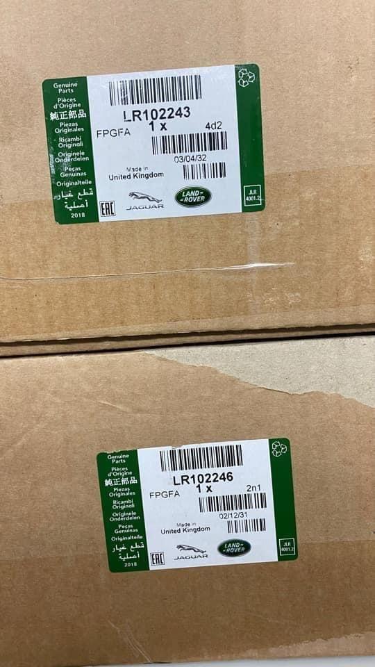

Gavin: can you confirm those calipers Part # (LR102243 & LR102246) are correct for a '23 MY X-Dynamic SE w/ 20's? Would love to swap calipers so I can run both 20's and 18's... as long as no loss in brake performance (or durability). Thank you!!!

I've not used them but from the many months of digging I've been doing here and elsewhere I'm 99.9% certain these are the correct part numbers. A member @mshotel posted in another thread some months back that they had fitted them and were running 18's on their P400. Thesecalipers are listed as fitting the 2020 P400 on OEMparts website https://landrover.oempartsonline.com/
They look identical to a caliper swap another person did on FB. I'll post the picture of them later.
Essentially AFAIK its a Discovery 5 caliper. If you have the regular P400 brakes, this is the caliper swap. ~$200 a pop on the listed site. If you enter a MY22 or MY23 VIN they will come back as not fitting. Enter your model as a MY2020 P400 and they are green lighted. Trim and model year are not important. Engine size and rotor size is. P400 with 20" wheels from the factory comes with the regular P400 rotors and calipers that I have.
