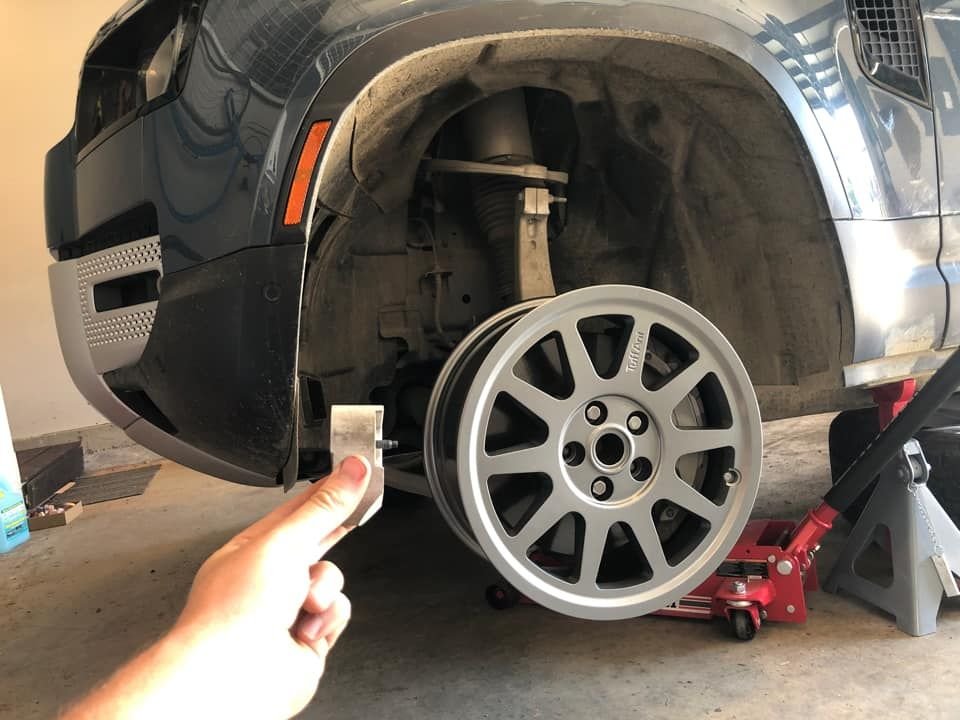

You probably already know this but the mud scraper on the fronts needs to be removed from the front setup when you have 20" rims. It's a 1 minute task once the wheels are off. One Torx T30 screw.

Thank you! No, I wasn’t aware the scraper needed to be removed. Where is this located on front? I ordered the black Kimberleys, but just saw a pic of the smoked grey on a white Defender like mine, and might change the color to smoked grey from black. How do you like that color, and any issues with the finish coming off (abrasion, chipping, etc…)?

Picture from the no-lift tire thread sticky.
