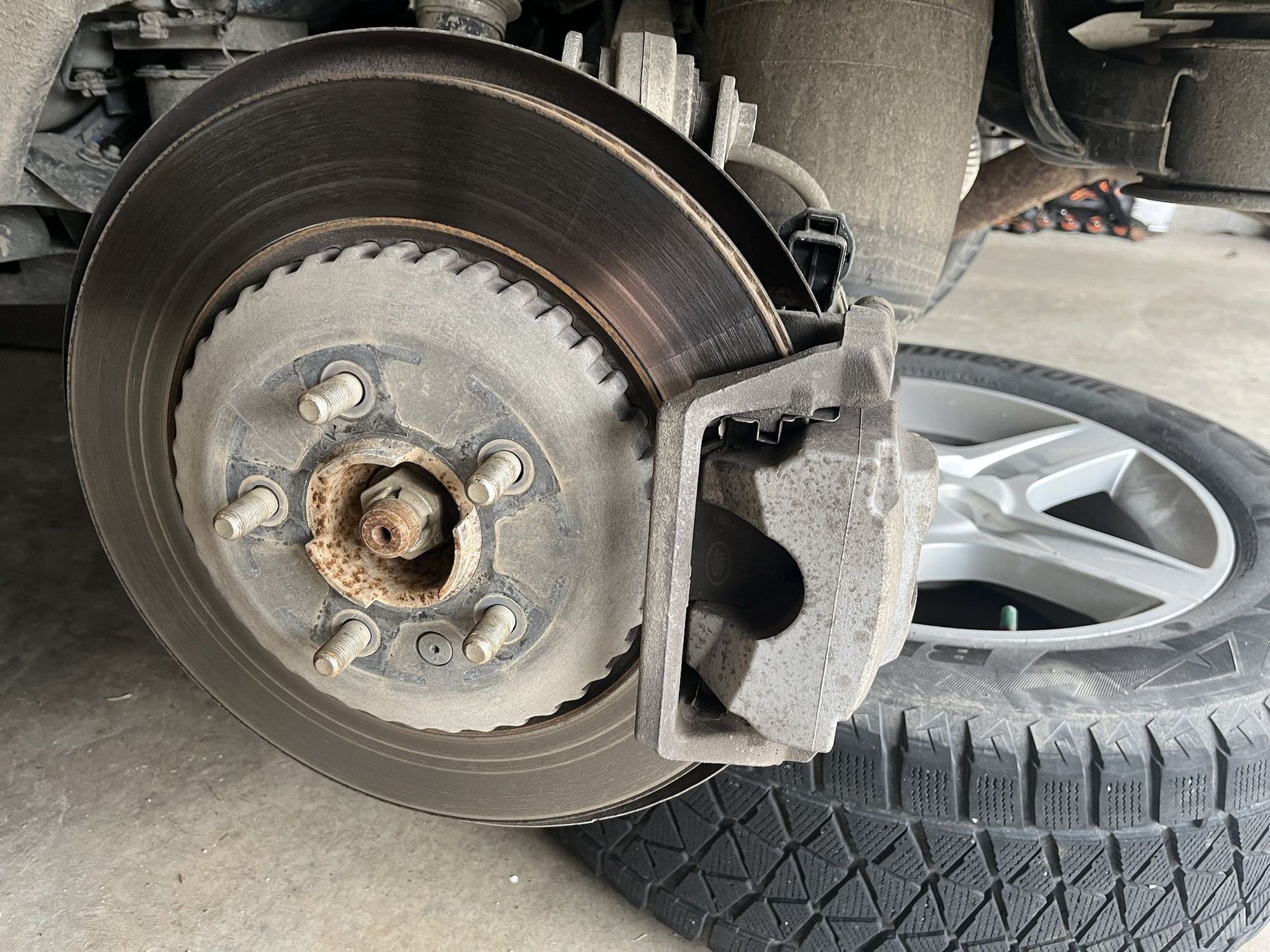

50,000+ miles since my caliper grind and all is well. I've looked at them oodles of times during ire rotations, seasonal swaps and most recently when changing the rear pads at 58,000 miles.
The only slight negative impact is the tight clearance and the inevitable scratching /grooving of the rims internally from off-road debris. Also a small scratch on the unadulterated front calipers.
No downside to this mod in my limited experience.
Caliper in situ 48,000 miles post shave

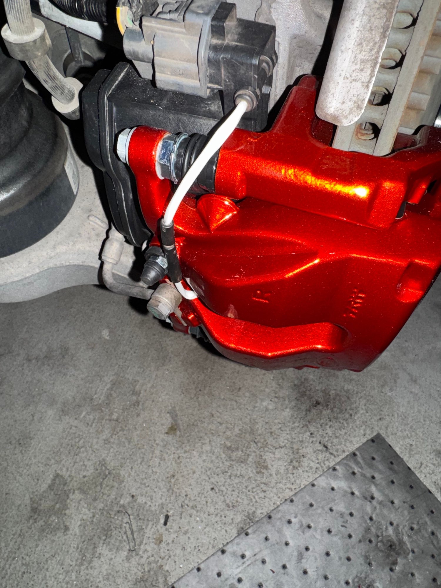

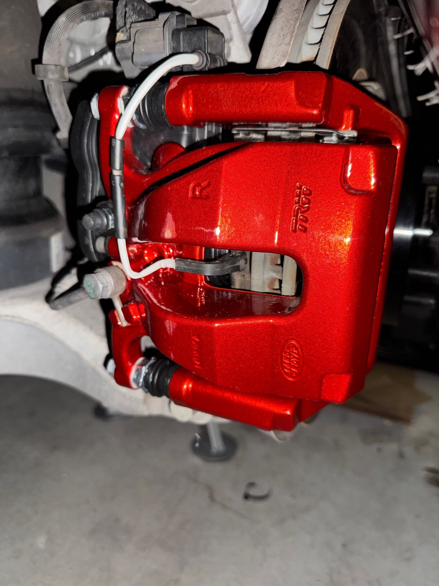

Just wanted to chime in on my DIY:
Have a 2020 P400, chose the caliper swap option.
While there were off, rebuilt the “new calipers” and powder coated them.
FYI, if you swap the caliper ann caliper carrier, it will change the caliper offset and might not clamp the rotor where it should. Ask me how I know…
Anyway, I installed the new calipers and redbourne 18’s.
There is the slightest rubbing on the leading edge of the caliper “knuckles”.
Looks like I’ll still need to grind a bit to get more clearance… pics below.
FYI looks like even after extensive research, Powerful UK also had a 18 rim touch the caliper after a swap of the caliper...

Very neat looking work
Yeah PUK were trying to fit the steel rims on their P400. Wont work without spacers due to the +41.5mm offset.
I'm surprised your rims rubbed. I thought the Alstons were one of the ones that works well with the swap. That's a bummer having to shave the calipers after a swap. Hopefully it was before all the pretty red powder coat went on.

Sadly no. The powder will need to be done, but at this point at a future point. Need the P400 on the road, so I will just take a file to get a bit of a gap at the leading edge and put some clear coat on it for now. I put 30mm spacers to see about pushing the rim out, thinking it would give more clearance but sadly it just shifted the rubbing to a different location on the inside of the rim.
I too was surprised that it didnt clear, and by at least 1/4"+. In hind sight I wish I had done a dry fit first, pre-powder.
Fortunately since its toward the back of the caliper, it should not be visible, but as you know, that once you know it's there, it's hard to forget.
