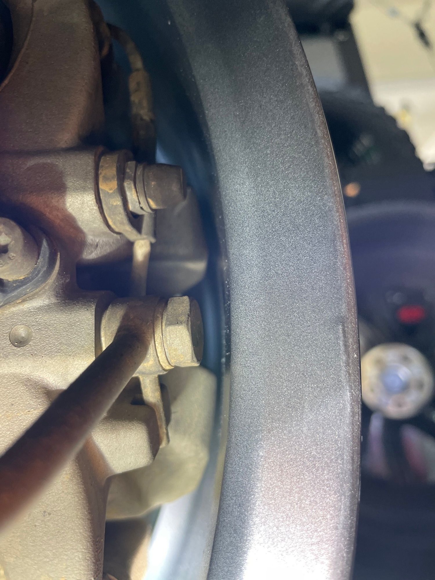

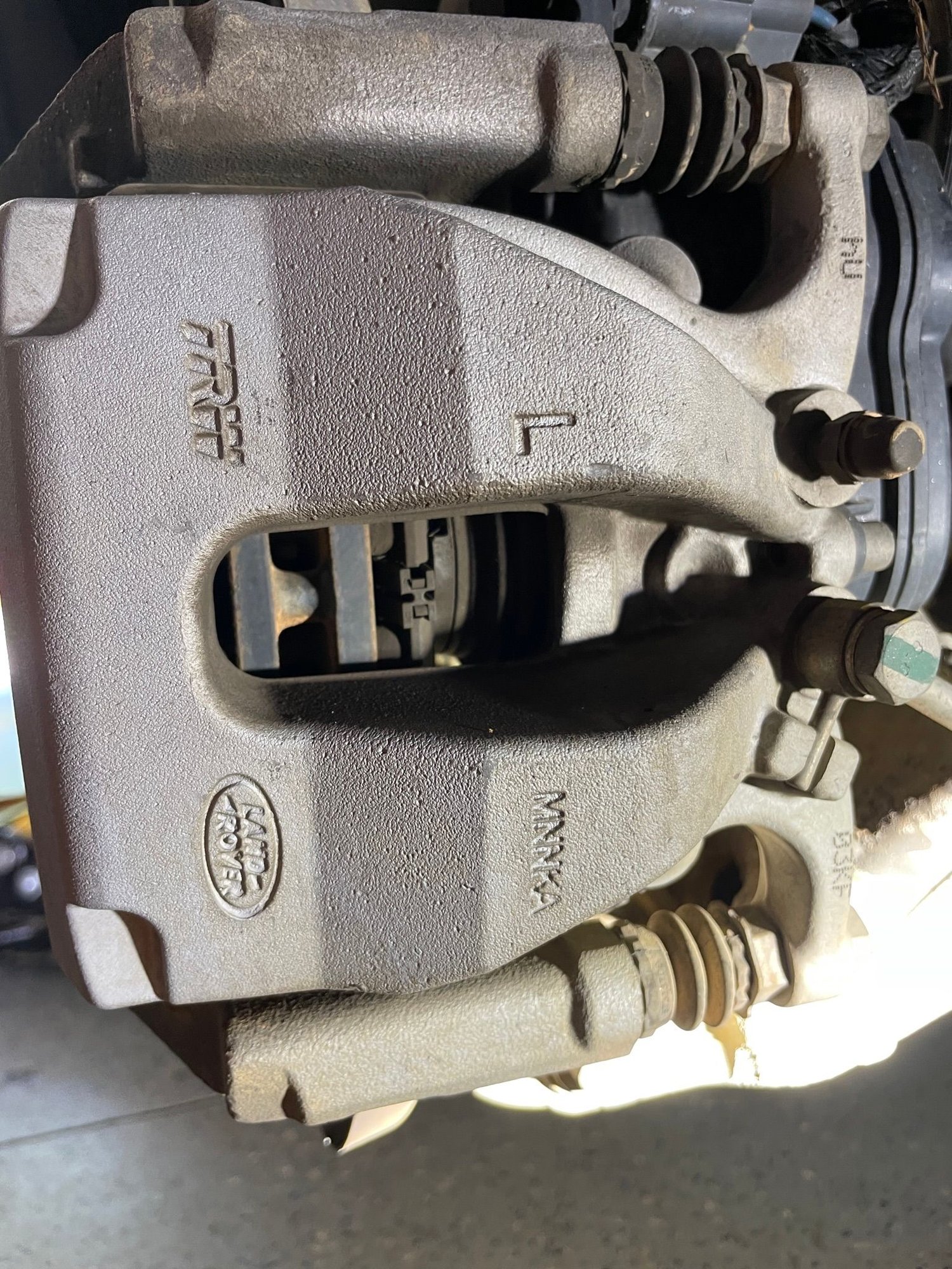

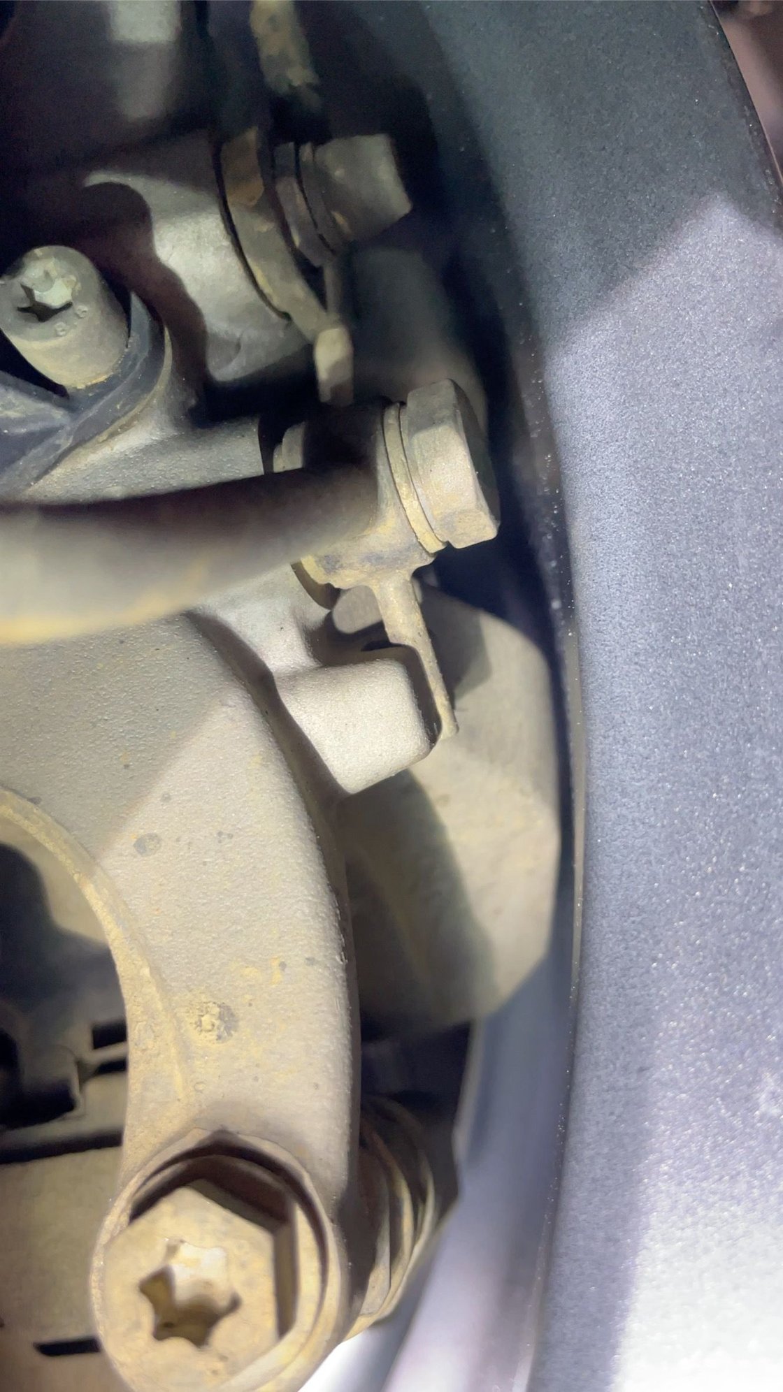

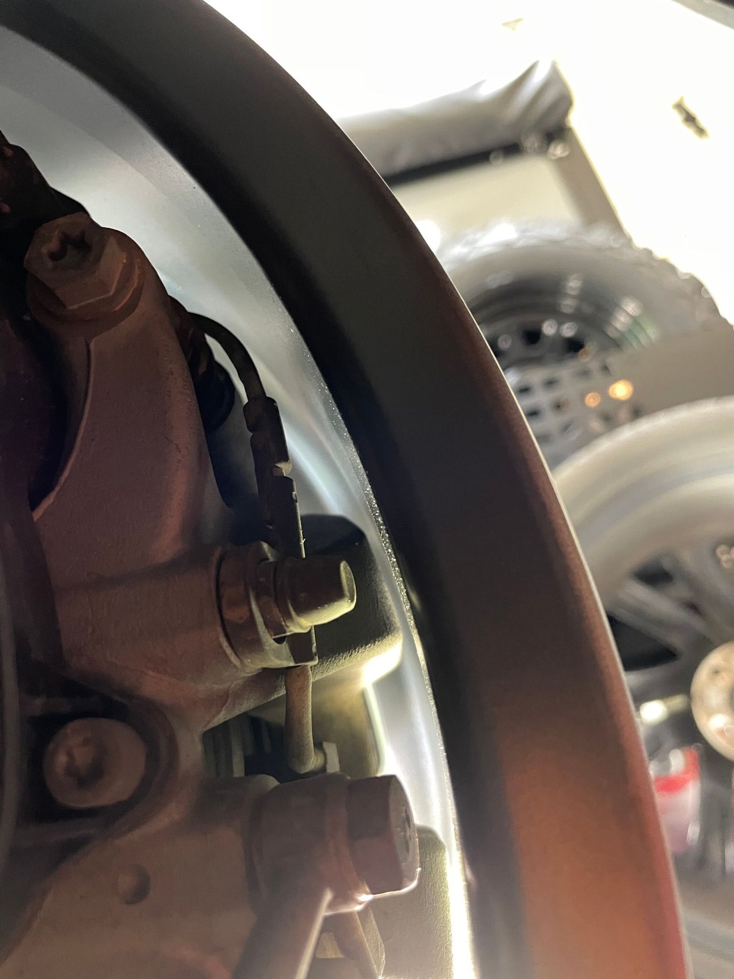

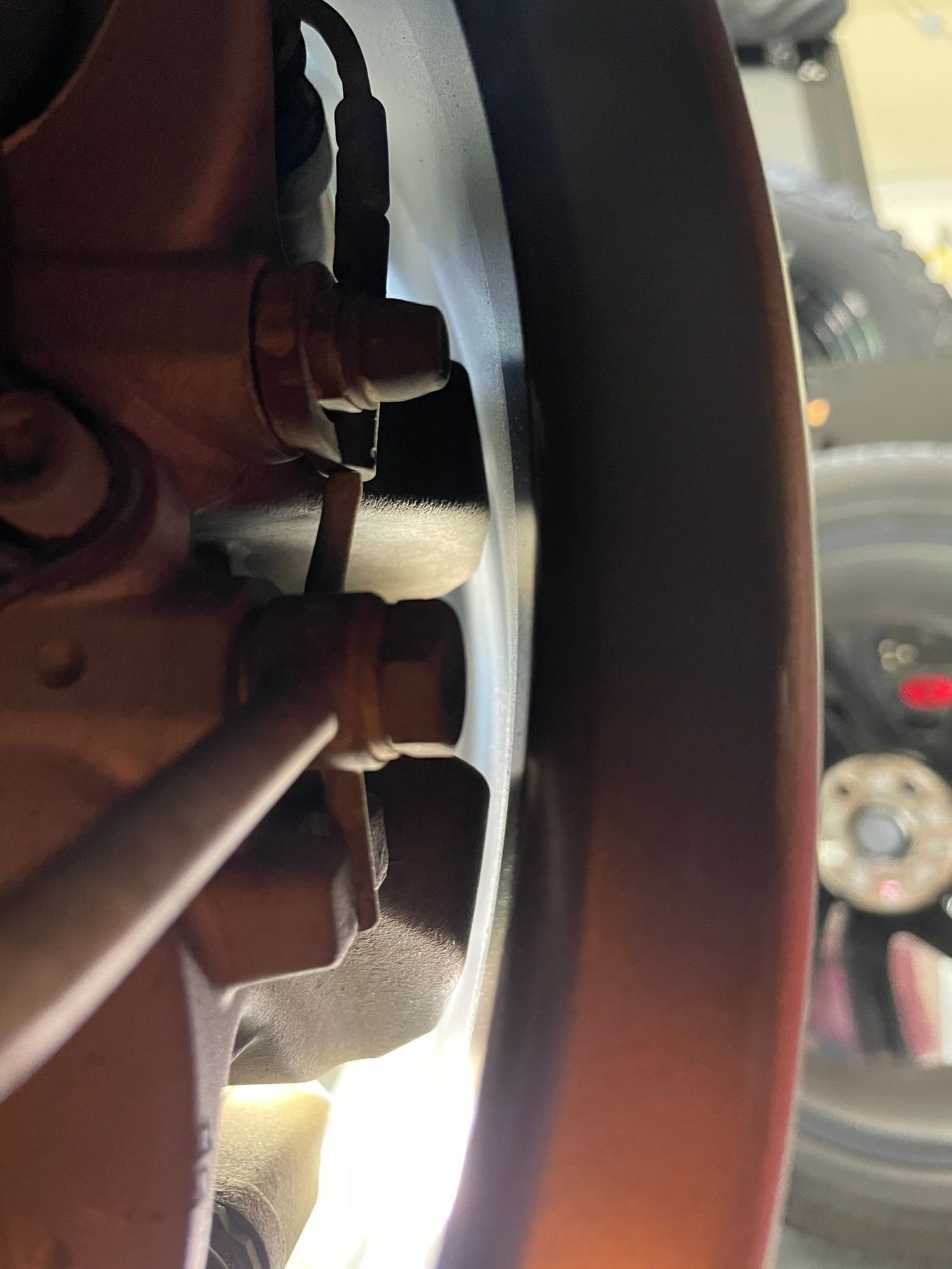

My MY2023.5 P400 has arrived as did my Tufant Kimberly's. My wife drives a MY2019 Disco5 HSE LUX and I think I'm in a position to do the caliper swap. I removed the rear wheel from the Disco and offered up the Kimberly's. As far as I can see there's 5mm or 1/4inch room between them and I think it will work. Before I pull the trigger and take them both to my dealer I wanted the wisdom of this group to confirm my judgment. Am I missing anything, apart from the rim balancing weights what else could touch? The photos below are largely from the rear side of the assembly. Thanks all.
Old Apr 30, 2023 | 06:20 AM
  #44
NoGaBiker's Avatar
Joined: Feb 2021
Posts: 1,338
Likes: 1,440
From: Atlanta, GA
I had to go to crimp-on external weights (old skool) because moving the stick-on inside-the-barrel type way to the inside of the wheel (toward center of the car) to clear the calipers made it so they couldn’t get the wheels balanced. This is OEM 18” steelies.
