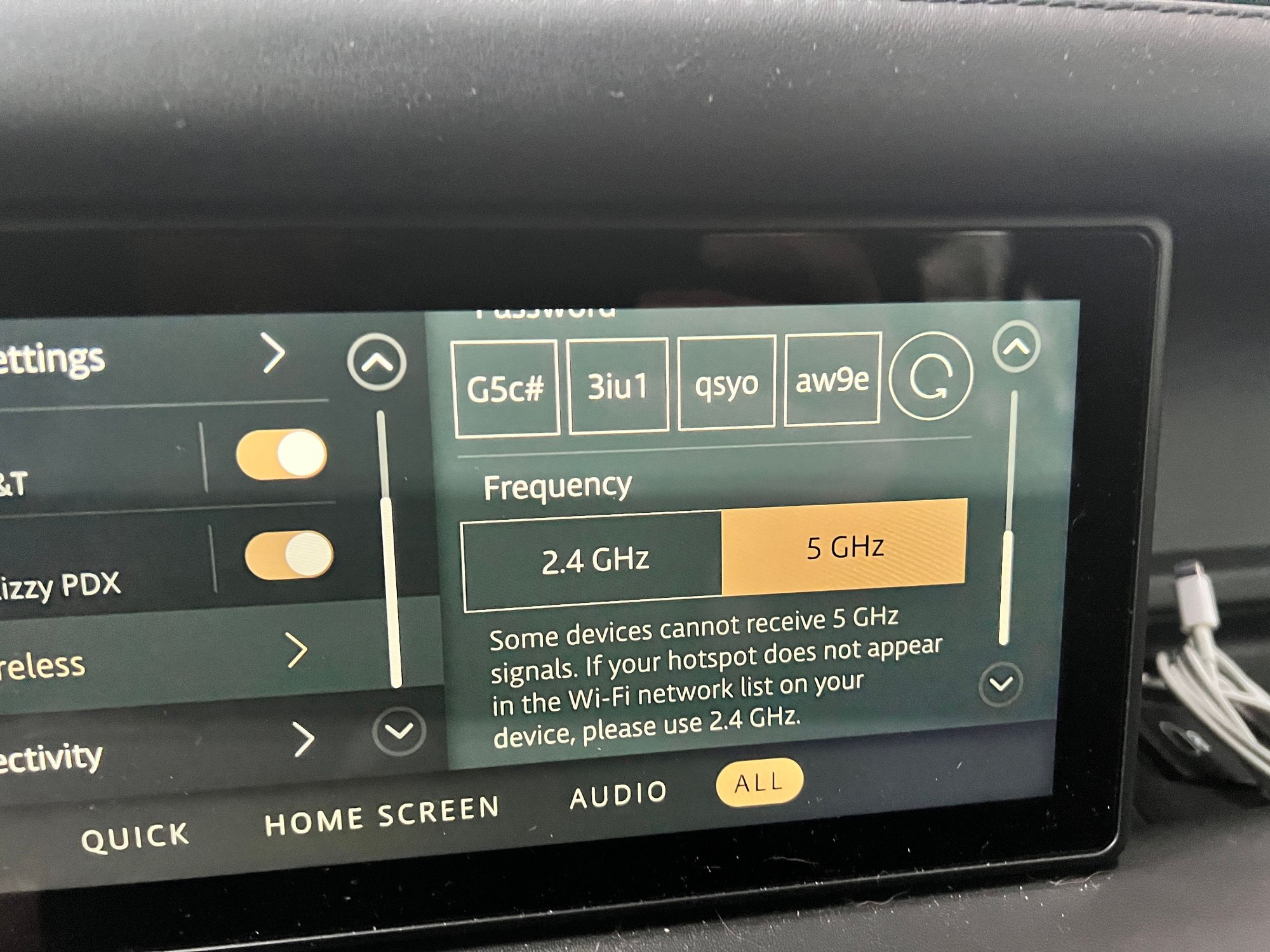

my system:

Hmm. That's indeed odd. Couple thoughts.... My gut says that if you're seeing that LR wifi network on your devices,.. something is indeed happening and the car does have a wifi network. I would think if you don't have it, that network wouldn't show up at all.

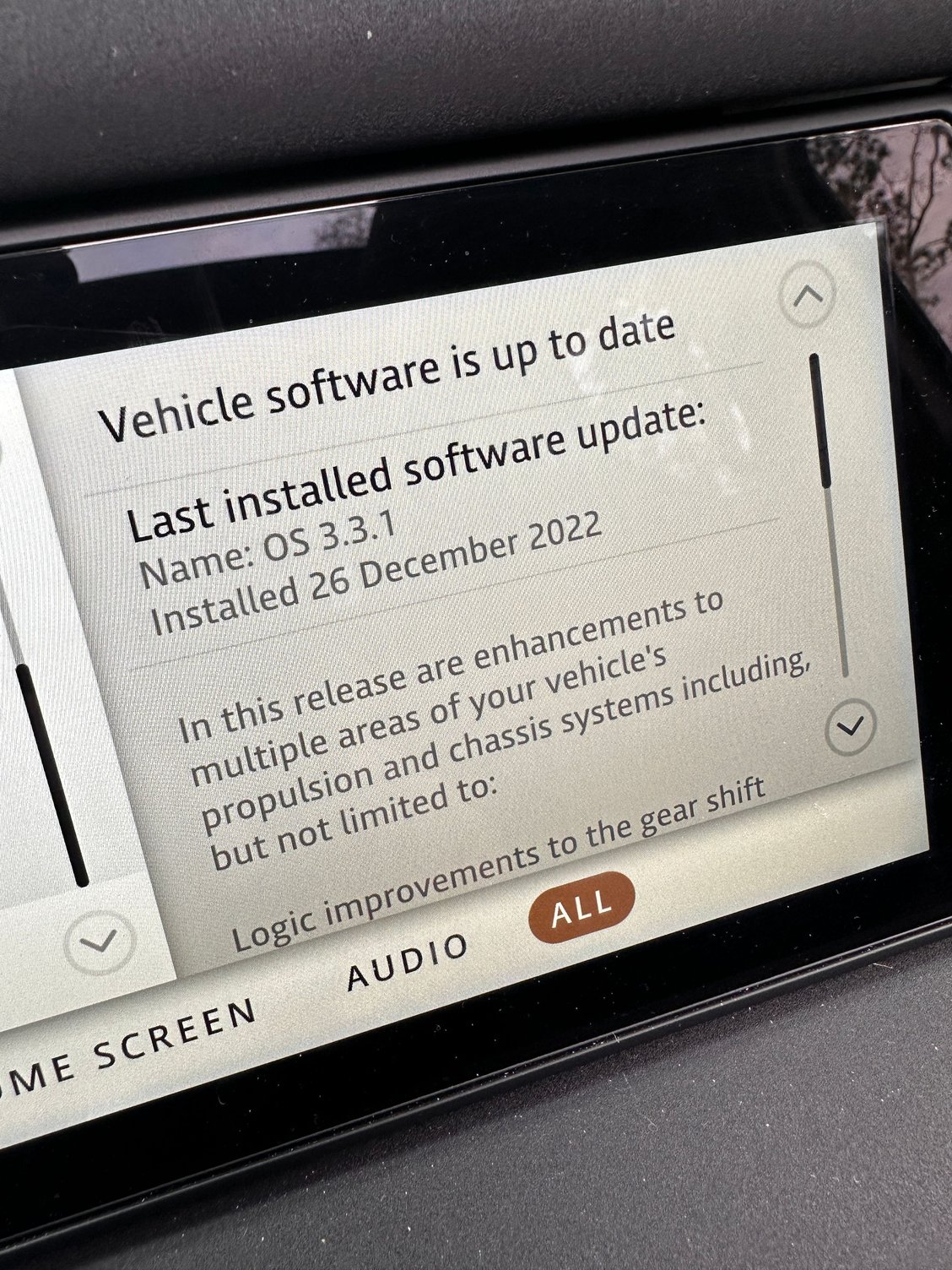

Can you go into software update and tell us your software version? I'm 3.3.0. (?) I wonder if you're on an older one. The newest is 3.3.1. They do futz around with menu locations and titles going from version to version in the interests of UI improvement.
Also what happens when you click the "wireless" option above in your photo? Can you post screenshots.

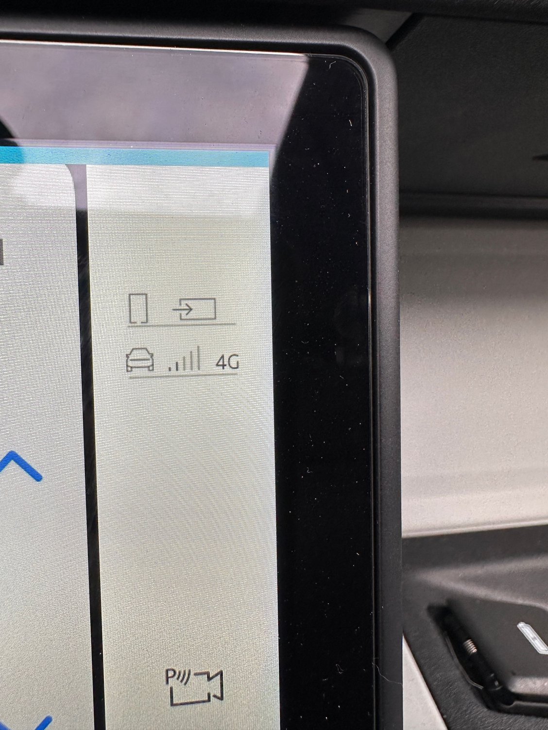

Here are a few screenshots, looks like my software is also the newest up to date as well
While it shows I'm connected...I think it has something to do with the REMOTE app maybe? It lets me connect here, but nothing happens, and when I try to connect another device like laptop it asks for a password, my phone offers to share the password, and then it just says "you are not connected to the internet"

Ohhhhh. I think I know. CarPlay is via wifi. So that network is how your phone is connecting to your car via Wifi. Aha.

I am extremely appreciative you've helped me with this - I believe you are right, I thought it was all bluetooth connected, but it would make sense as to why my phone already knew the password, which is like 20 random characters that no human would ever create themselves.
