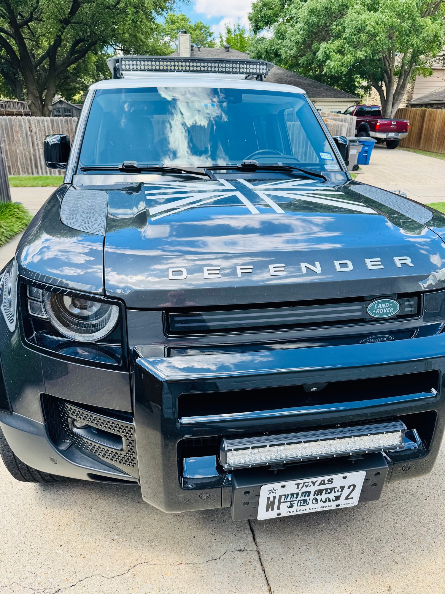

Thanks, nashvegas! I have an A bar (see photo). I would have loved a full-sized brush bar or bullbar, but that was just too expensive!
