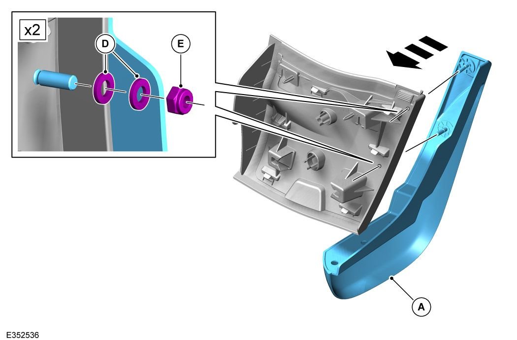

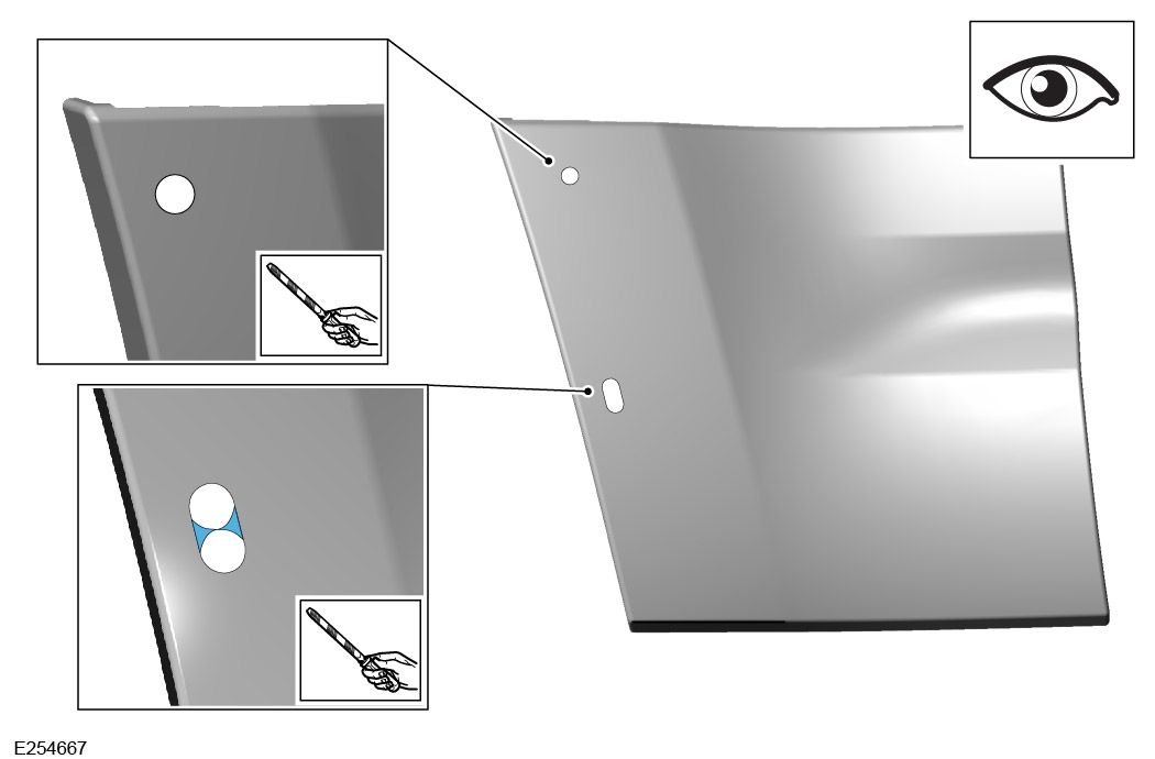

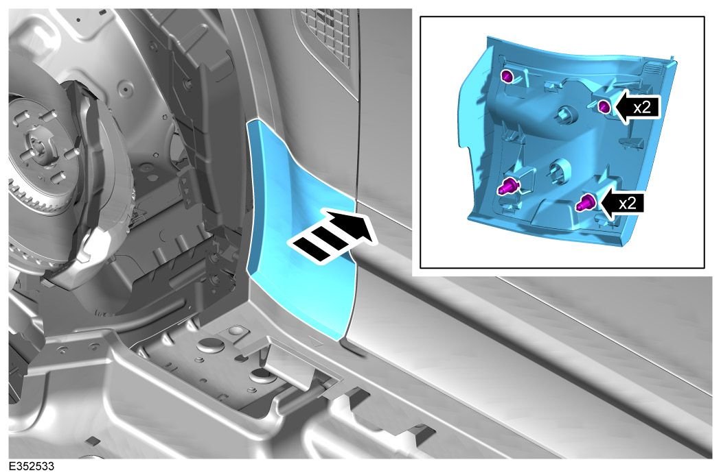

The front mud flaps require holes drilled into the front side trim panels. See pictures below. The rears don’t require holes drilled where you can see them.

There’ll be visible holes on the side for both the front and back mud flaps. You can easily go from large to small. I went from small to large (dealer installed wrong style on delivery) and they use the same holes.
