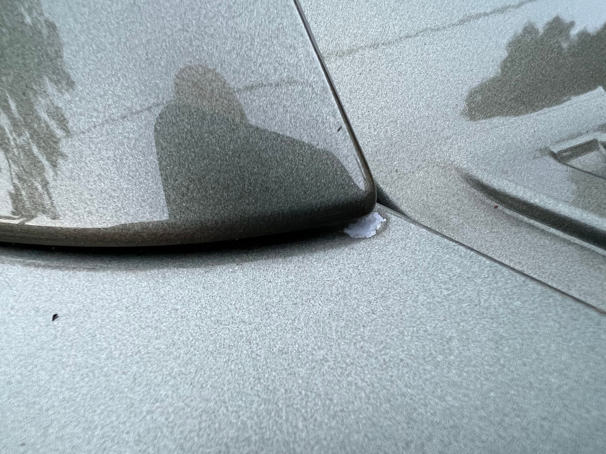

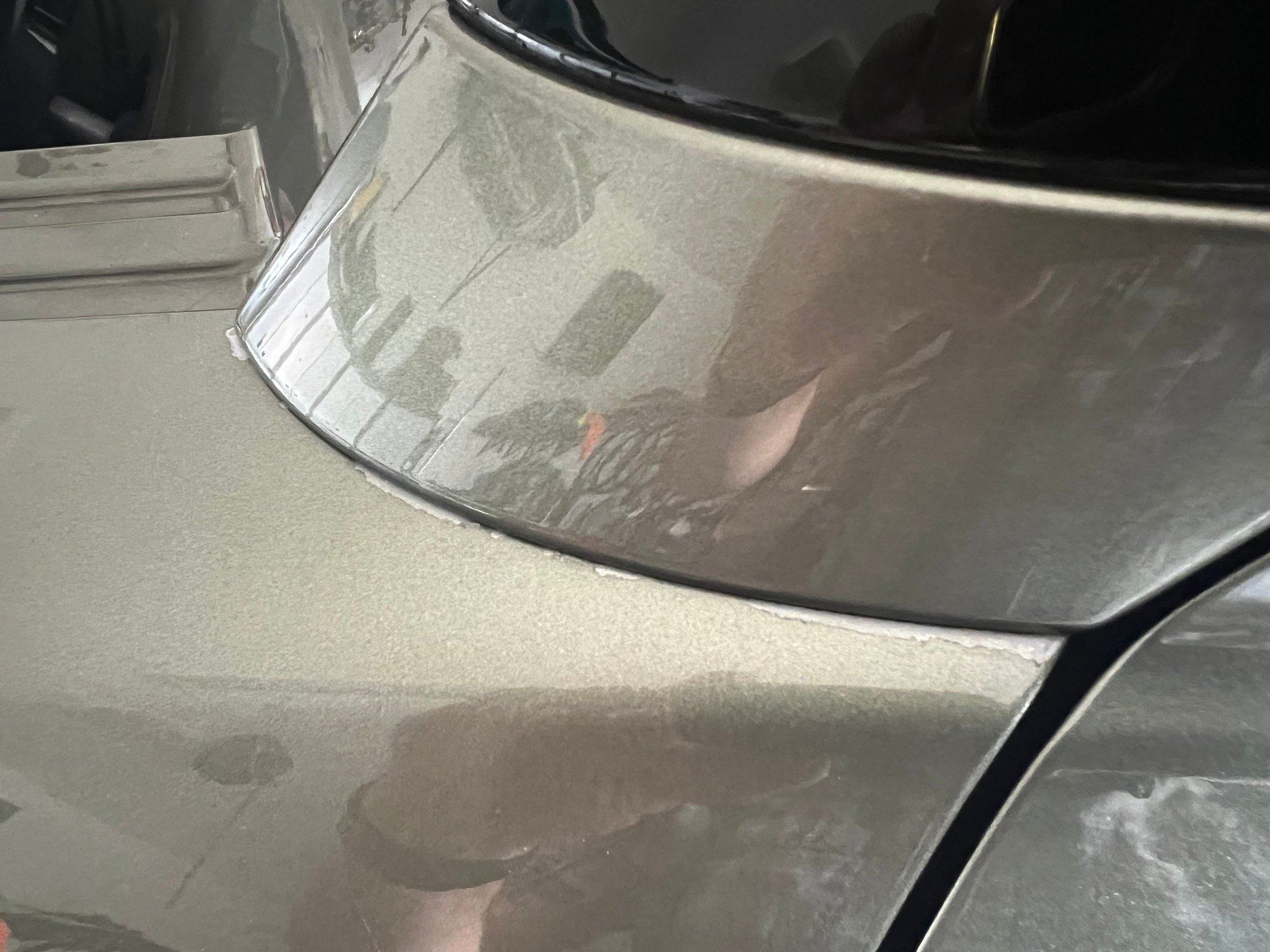

I feel your pain.
I recently purchased a preowned 2021 D90 First Edition with 18K miles. Before committing to purchase, I noticed very similar paint chipping in the same area on the top of both fenders. The selling JLR dealer has committed to paying for the paint repair. My local JRL service manager attributed the paint chipping due to an improper installation of A-pillar trim. I.e. not adjusting the trim upward enough to avoid contact between the lower colored A-pillar trim piece and the fender. Since the windshield was replaced prior to my purchase, the theory is that the replacement window installer improperly adjusted the A-pillar trim. I have not yet gotten an estimate to repair the paint, but I wouldn’t be surprised if it requires a full respray of the both fenders to do it properly.

Only saw this now but I had the exact same thing happen at the exact same dealer (Land Rover San Jose). They replaced my windshield last year and scratched the paint under the A-pillars as well. I brought it up to the service adviser and they used touch-up paint to cover it up.
