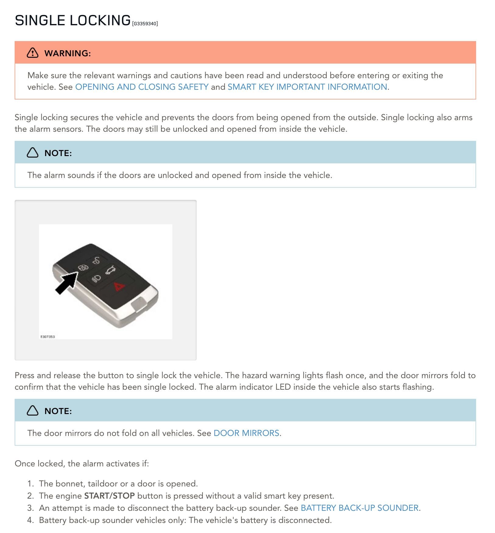

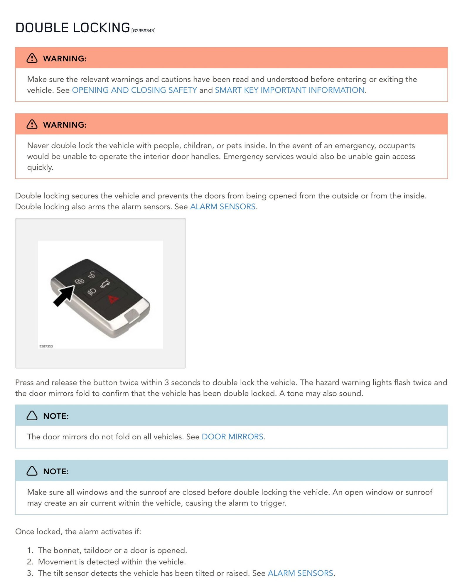

Pressing the key fob lock button twice does not, according to the manual, disable the door lock buttons. There are two stages of locking: SINGLE LOCKING and DOUBLE LOCKING. The differences are explained below. All of this is contained in the manual.
