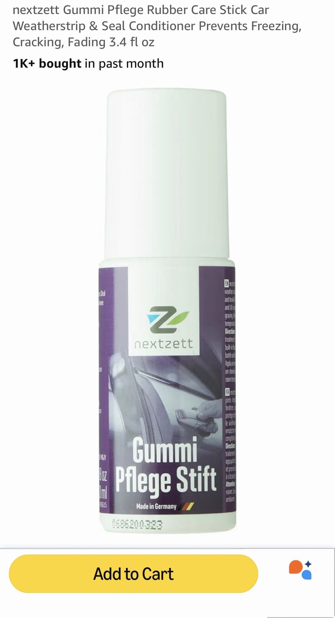

thx for the advice! I just ordered this and will have it tomorrow. Hopefully it will help. It is also a cleaner/lubricant.
