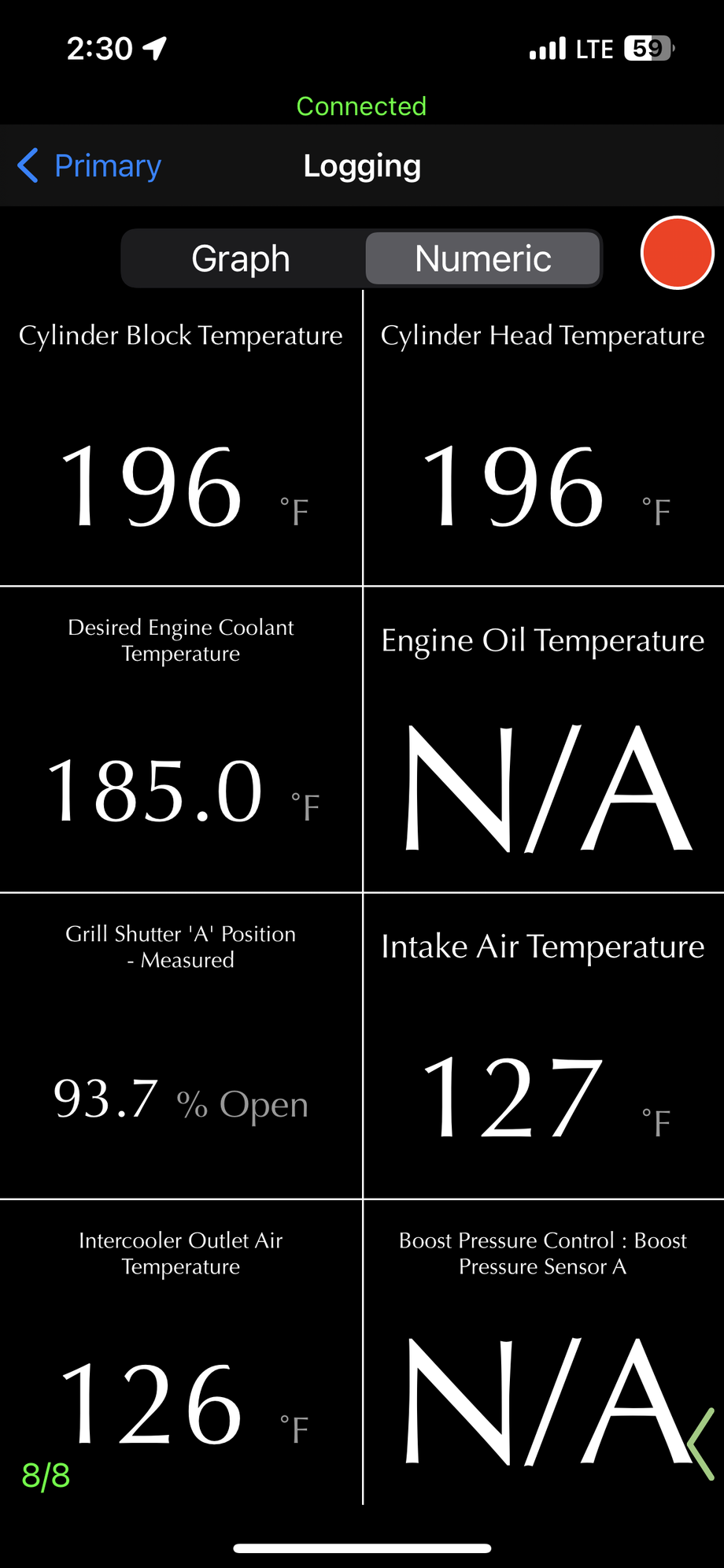

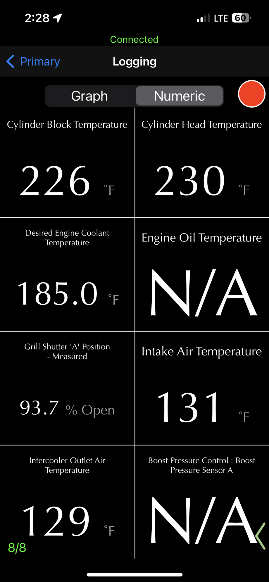

Are these engine temps … ok?
Seems high @ 230.
First image is going up Siskiyou summit, which is a 4000 ft mountain. Cruise set to a steady 70-75. (I wasn’t really giving the motor a workout or hammer down l). Maybe a 6% grade (?). Steep ish.
Second images a few minutes later, coming down the mountain.
2020 P400 110 X 19k miles w winch and bulbar. Just me and backpack in the car (not heavily loaded).
if this were my disco, I’d be pulled over worried I’d already begun cooking a head gasket.

I’ve dealt with high water temps a bit, from a 12-cylinder E Type to an MG midget. I keep in mind that at sea level water boils at 212 degrees F…and yes, I know we all know that. And I know you use a coolant, not water.
4,000 feet does lower the boiling temp (of water) to about 204 degrees, so 230 seems high.
Since the main radiator grill is getting close to fully open but isn’t, you may want to check your cooling system and aux radiators and you probably plan to. I wonder 1) why this reading is the same once the CHT went down and 2) what it is under more normal conditions.
Not an expert but should CHT be the same or close to the water temperature? I would think CHT is normally higher?

Also have to ask; the readouts you posted are from an OBD Canbus reader? Which one. I keep thinking I need/want one.
Cheers
