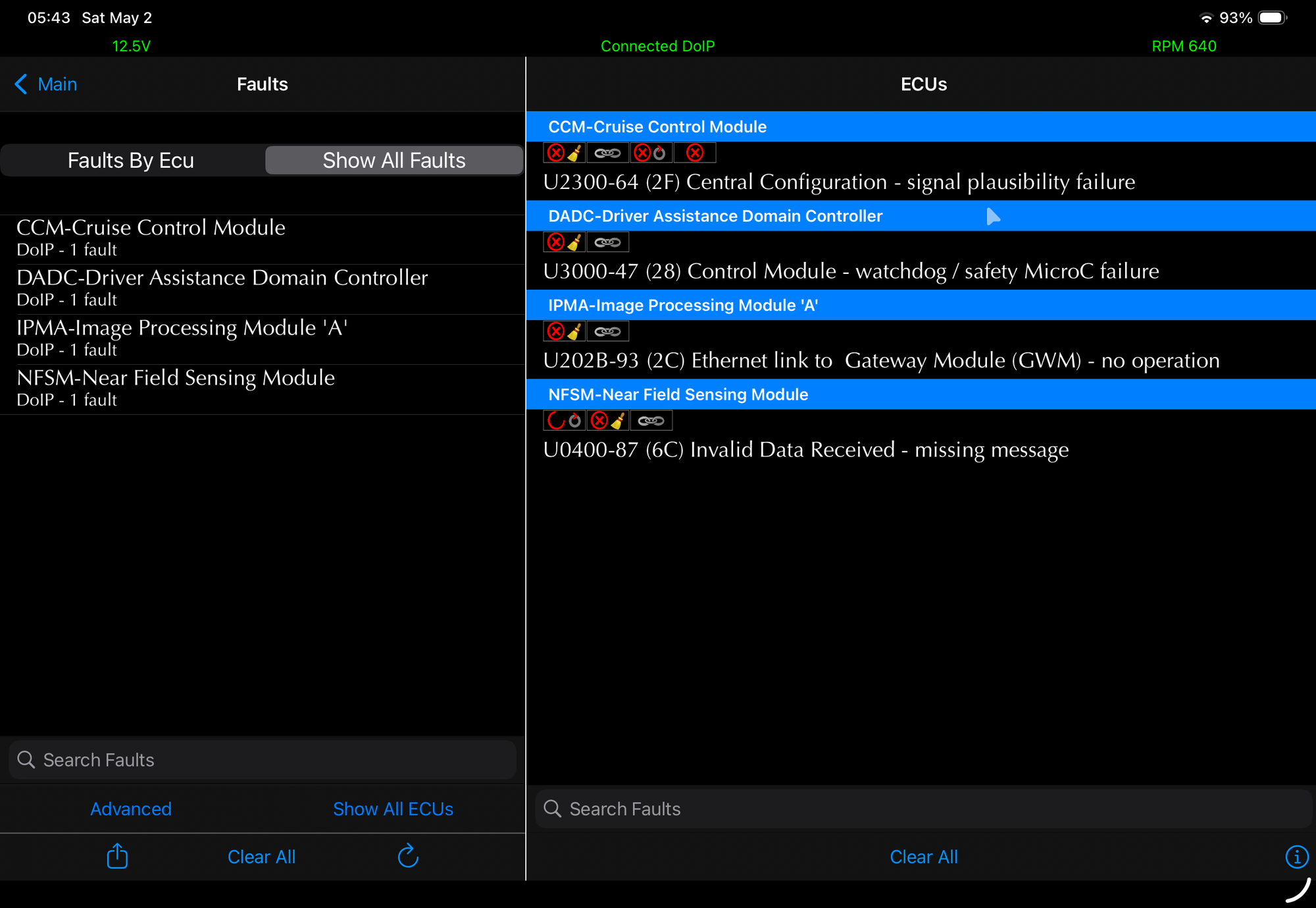

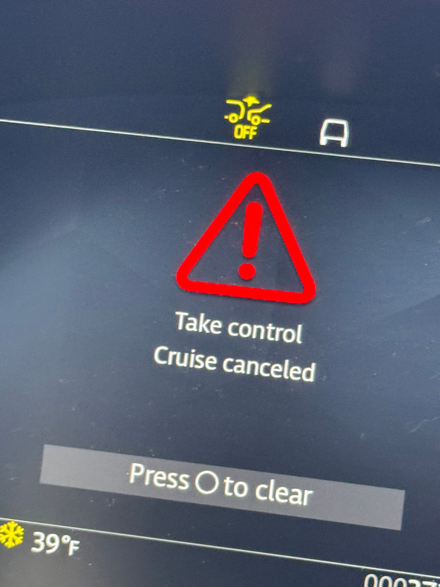

I made a couple CCF changes, specifically the splash screen, enabling the key fob tailgate release, auto start stop memory, and WiFi hotspot, and now my adaptive cruise control isn’t working. I’ve got lights on for no front collision warning and no lane change assist. Anyone else running into this? MY2026 Defender 130 S, North America (USA).
Fault codes
Fault codes

Originally Posted by LandRoverDesMoines
I didn't activate ACC with the tool, but I activated Dynamic and TR
Same issue in my MY2026 130 S. I can’t figure it out. I’m going to restore all CCF changes with the GAP tool and see if that fixes it.

I'd try the basic stuff first.
- Top off the battery with a trickle charger.
- Lock the car and let it go into sleep mode, might take 3 days - your JLR app will show you when the car is in sleep mode. A closed eye-lid icon will be in front of the car picture in the JLR app.
- Reboot the Pivi if after the sleep mode doesn't solve the issue.
All modules need to go to sleep so they can re-read the CCF from scratch.
