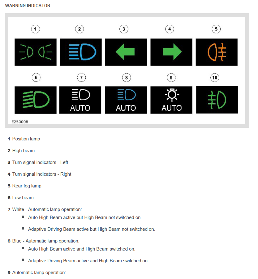

You guys made me doubt. I do have the final build confirmation for mine and here's what it shows: "030NV LESS Auto High Beam Assist" which confirms my car did not come with AHBA. Further looking at my order sheet I see I have the following related to front lights: 064QA Led Headlights, 064AP Front Fog Lights (that was an added option), 064BU Daytime Running Lamps, 064DL Beam Pattern. I do not have: 064BW LESS headlamp Washers and 064DY LESS Headlamp Levelling (I have coiled suspension).
Just to clarify, I do have Auto low beam (i.e. the low beam is controlled automatically by the rain/light sensor when lighting is in auto mode through the stalk), which I understand to be standard on all L663s what I don't have is the automatic switching between high and low beam (as you point out @CincyRover that can be turned on or off on the Pivi touchscreen and IIRC that is not available in my Pivi). I also have that thing where the car proactively turns on the fog light of the side where I am making a turn into. Based on the shop manual I think I have seen all of these in my cluster except 7 and 8, which would be consistent with the car not having AHBA.

LOL. Thanks @GavinC , checked the shop manual and the other component seems to be the IPMA module (image processing) which I also have, so looks like everything is there. There are three explicit AHBA lines on the CCF, so might try those and see what happens. Will report back.
