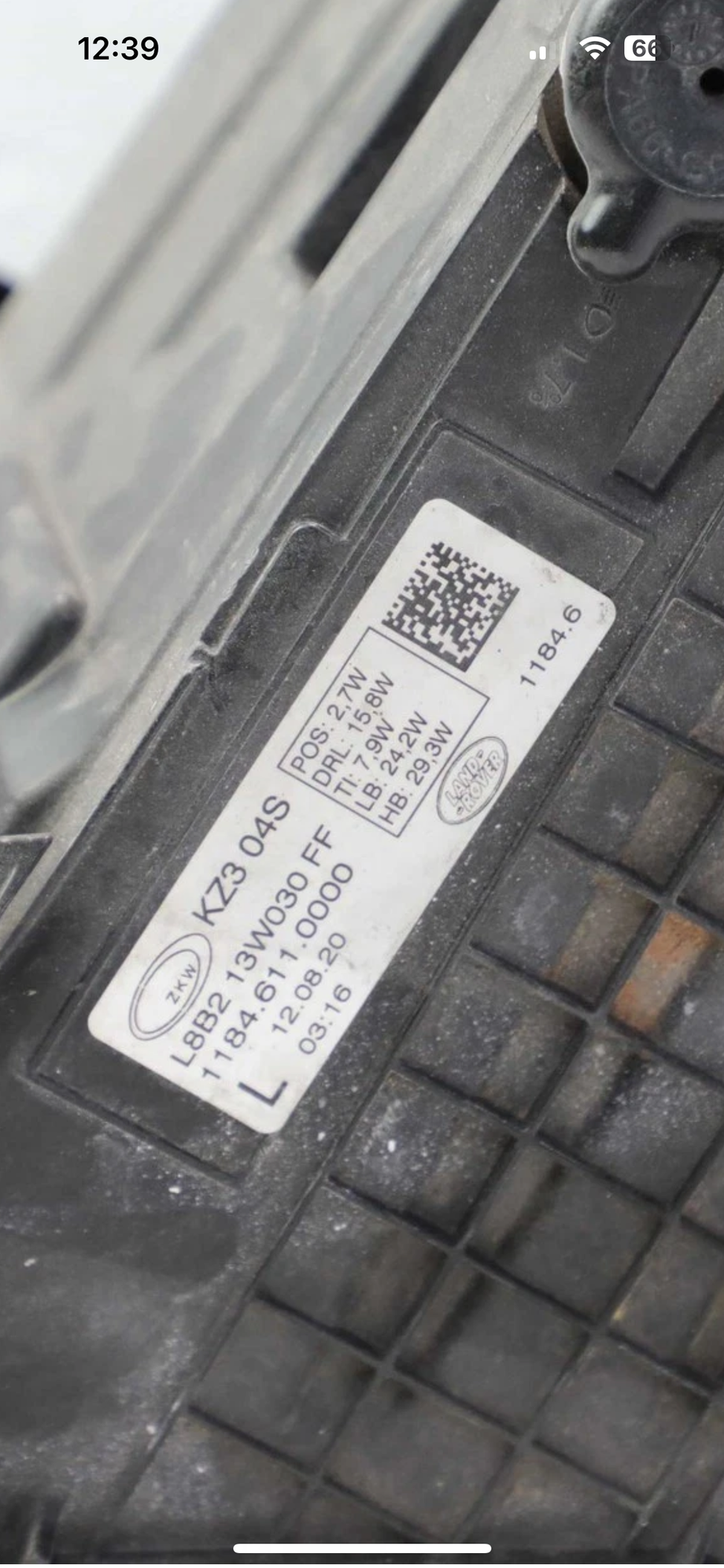

I believe those are the secondary part numbers for premium headlights.
Searching that part number on eBay you get this label, which is a match for specs to the label on my 2020 factory premium headlights.

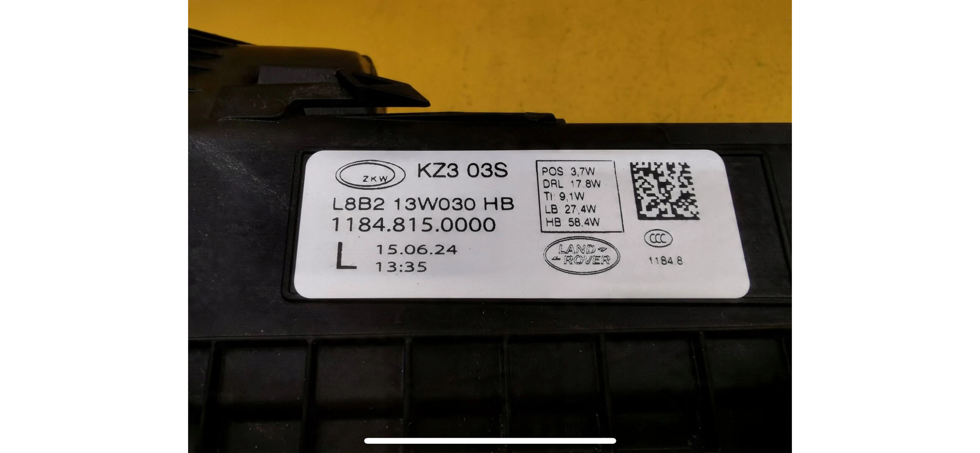

The matrix lights should have higher spec like this:
Thank you, Thank you, thank you!!!!!! You have just done for me exactly what I was hoping someone would do. That is show me a picture of their Premium headlight and tell me what code it shows. So obviously the page that I got the info from is wrong. The headlights that I had bought (and returned, UGH!!!!) were actually Premiums. All right, no huge deal. I can purchase them again. Will now work with the scanner to identify what changes need to be made to be able to fit those Premiums on our car....
Once again, thank you!!
