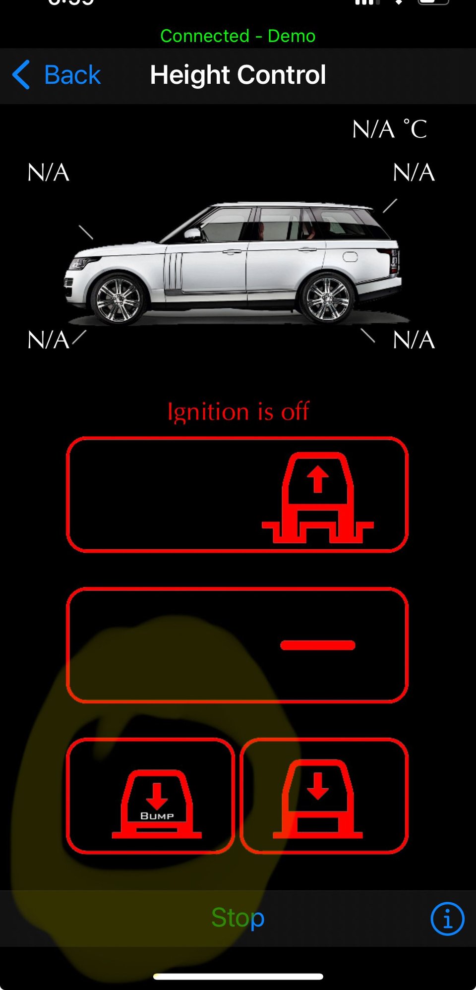

You can drop it down all the way to the bump stops. It's in height control menu. Select that option and you drop all the way down.

The circled icon This is demo mode but it’s the same on Sefender
