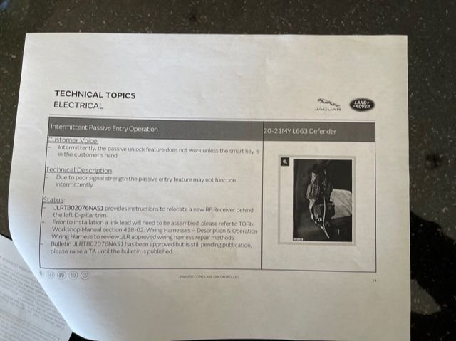

Old Jun 5, 2021 | 10:14 AM
Peak_rider's Avatar
Joined: Mar 2021
This is the fix for it. I'll let you know how it works.
Old Jun 5, 2021 | 11:11 AM
charlypm's Avatar
Joined: Feb 2007
Posts: 140
Likes: 69
From: Tacoma WA USA
this the link to the bulletin.
https://static.nhtsa.gov/odi/tsbs/20...91870-0001.pdf
