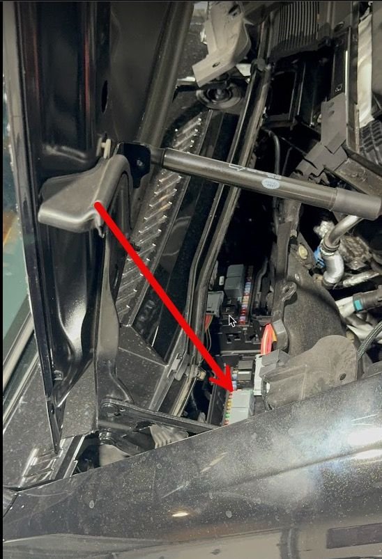

Well. I've had some time to play around and access to the JLR Service Manual info for a week... so I found a few things that have at least narrowed down my search.
For one thing, I know its not sounding the horns to the car. There is something called the "Passive Sounder" and it is either separate from or attached to a "Sounder Backup Battery." It looks like this...
And its located somewhere down here:
The only problem is I don't know how to get to it. I can't see it and I only know its vaguely there based on pressing the button while my head is under there to recognize its definitely in that area. I have a feeling the fuse box has to come out to get to it, or maybe it might be possible to get to it from underneath or through the fender liner.
That was more work than I had time for today though.
The good news is, its clearly connected by one lead and one ground. Nothing fancy. So if I could just get to it, I'm confident I could wire up another siren for a different sound. And I know exactly what I want to use (have used in the past).
I have like 4 of these sitting in my garage and I would love to try it out in this application. Just didn't have enough time to hunt for this today.
Hoping that this info will spur you guys to also help me figure it out! I know I can't be the only one that hates the herbie the love bug 'honk honk' every time we lock our cars.

Heres the little bastard right here. How do i get to it though without taking apart half the car...

Rather than get to wherever this thing is … can you get to where the wires come from, snip or tap them, and wire up the chirpy thingy you want to see if works? Might save you some time…

I had that same thought today but I haven't had a chance to see if I can figure out where the wiring comes from.
I did get under the car today though just to pull the fender liner back to see if there was access there. No luck. you pull the fender liner back and look up and its just metal. which makes sense. It tells me that the passive sounder is somewhere between that fuse box and the fender. And I'm thinking the only way to get to it is to pull that fuse box out. At which point is probably farther than I'm willing to go.
