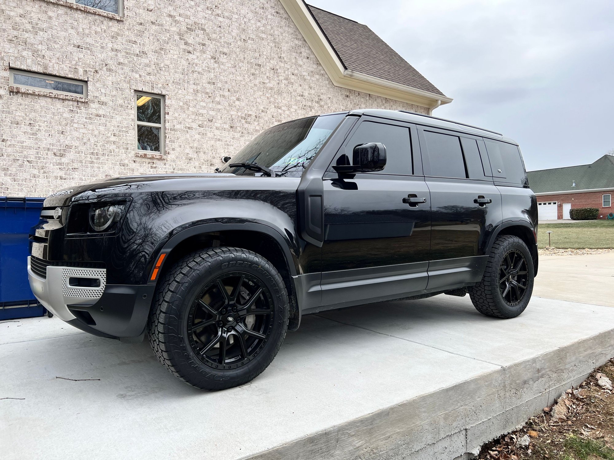

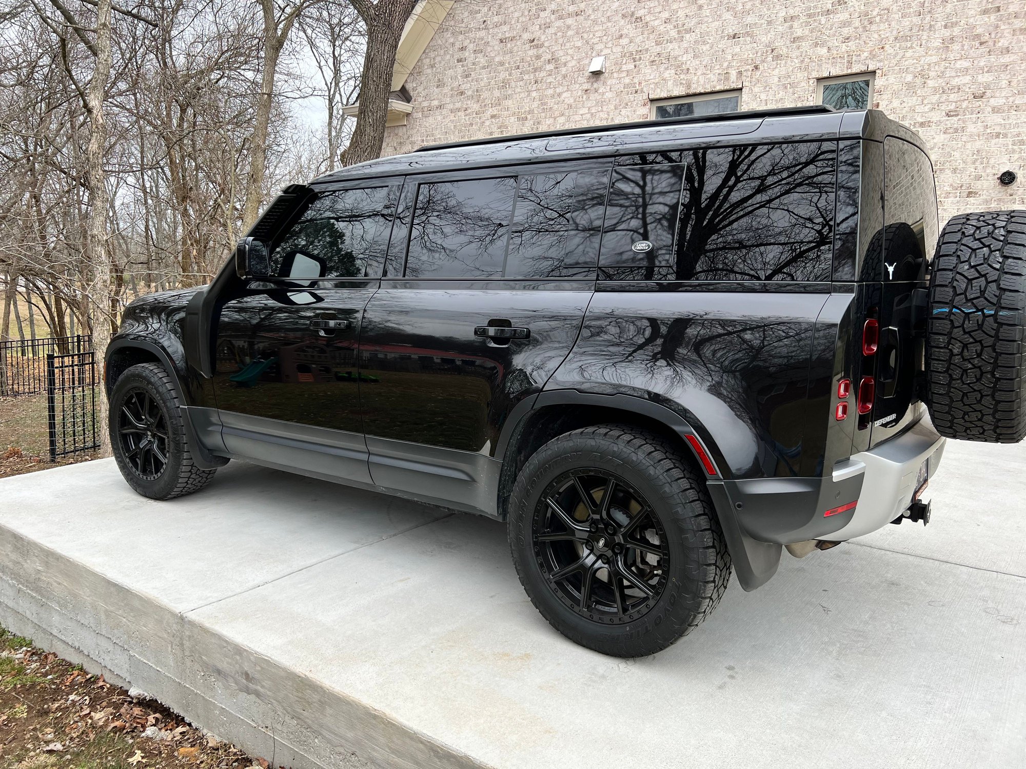

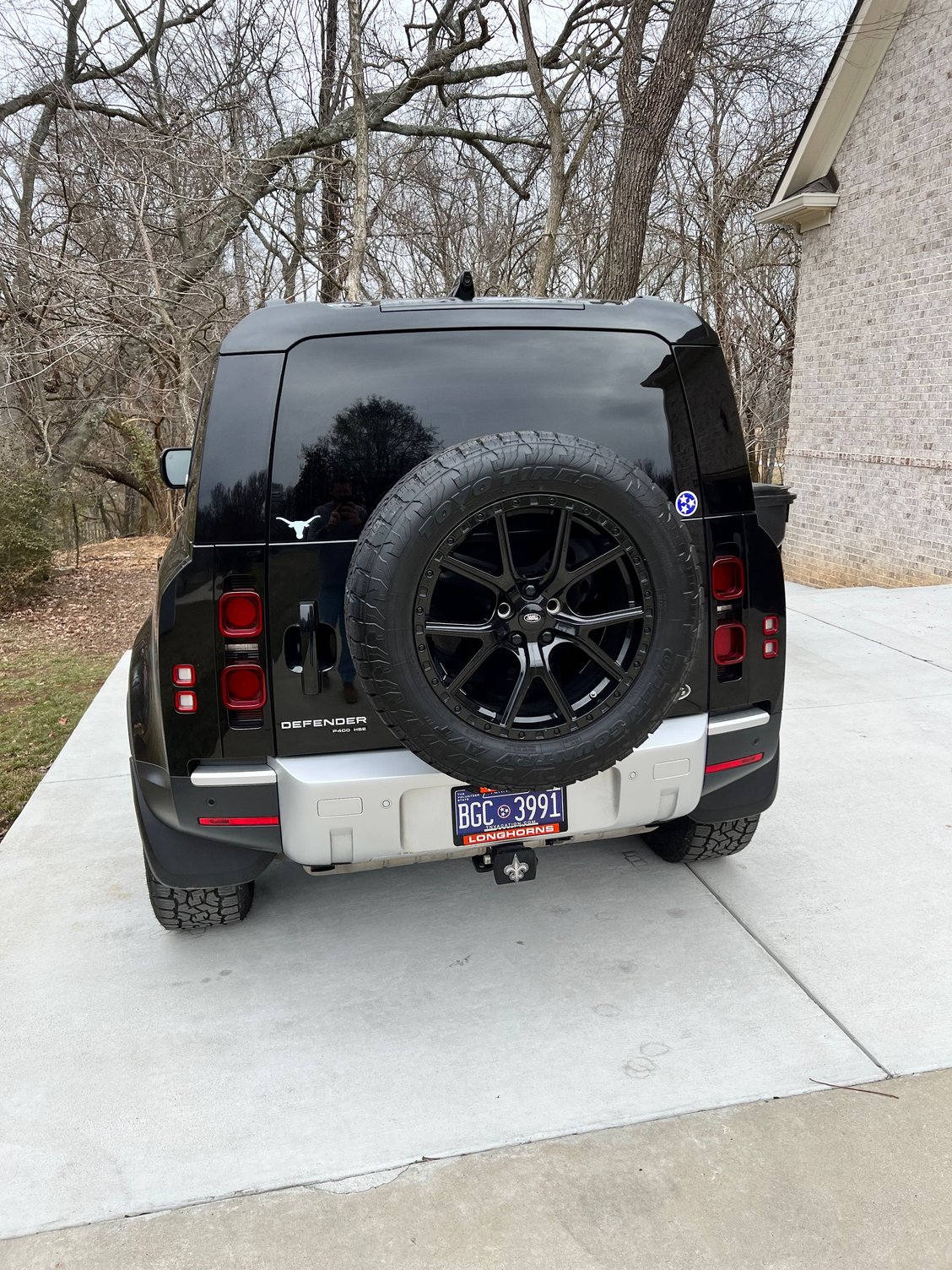

Got it all sorted. Settled on no lift for now, for a couple reasons. First, I love it just the way it is. Second, have to get an alignment after and that’s just a pain in the *ss where I live. Third, why risk having to argue with my local dealership on warranty?
its CPO warranty lasts until 9/7/2025 and unlimited miles. 5yr/unlimited from original date of new sale.
Mantra 20” wheels
Toyo AT3 275/55/20. Only 4lb heavier than oem and 3pms rated. No rub at all.

most lift to avoid rubbing when going larger in tire. but it’s the combo of larger tire and more aggressive offset or wider wheel that causes rubbing
i had to do a 1 inch lift to clear a 275/55/20 ko2 with aftermarket wheels with an offset 10. still rubbed a little in access mode

My offset is +34 and I never have it in access mode so I don’t get rub. But if I put it in access mode I might.
