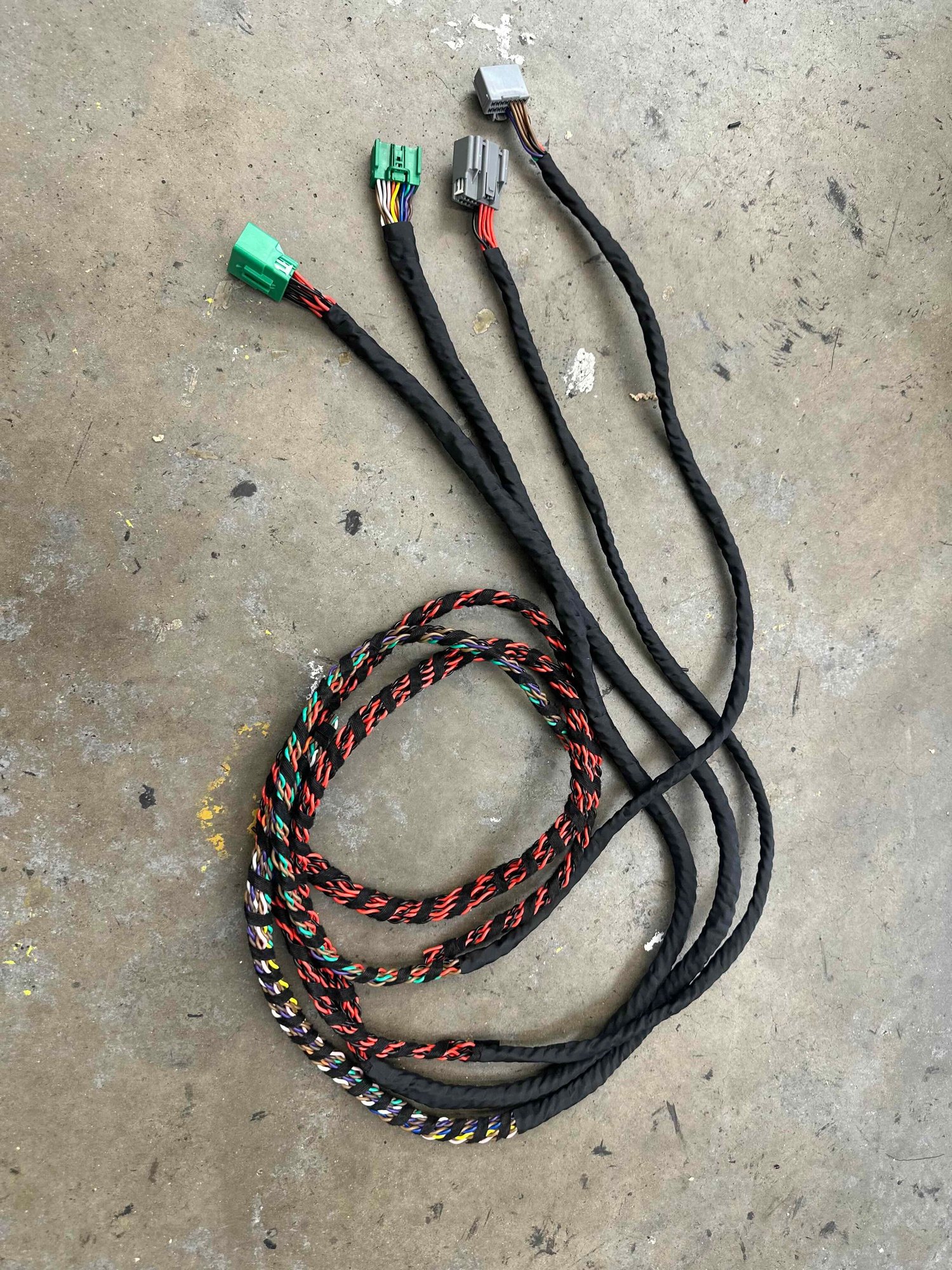

Finally my shop received OEM harness heads (both male and female) and made plug & play harness for my Meridian system.
Front: Helix i7 tweeters, mid-bass, Blam Signature midrange. Rear: Helix i3 teeters, mid-bass. Amp: Helix V12.
But I encountered one issue. I powered stock sub with amp's 2 ch. Then ANC (active noise cancelling) sound was also amplified and created very unpleasant low frequency noise. So my shop switched getting subwoofer feed from front mid-bass instead of subwoofer feed. Then it looks like amplified noise cancellation sound was gone.

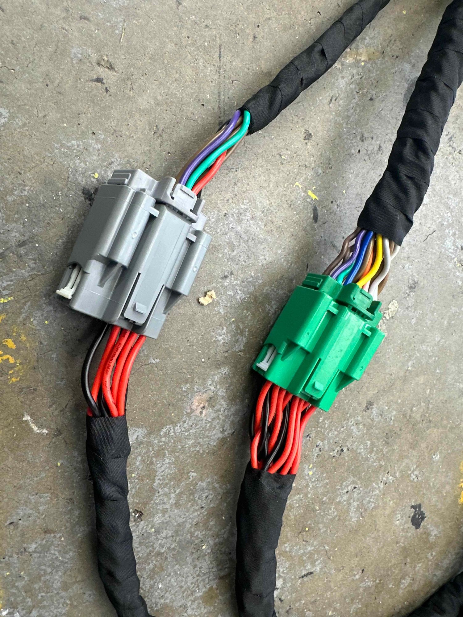

Hello, I am over here from the jaguar side of things. I've been working on upgrading the meridian surround sound system on my car. I was curious on that harness that was created if you could supply the part numbers listed on the side of them. Im considering doing a helix dsp in the future.

I spent over 6 months to find plug and play harness for Meridian to aftermarket (Helix V12) amp but had no luck so my shop ended up sourcing exact harness heads (green and gray) and made their own (pictures are posted above). And as @CincyRovers mentioned above, Defenders doe not have ANC but aftermarket amp will amplify fake engine noise with its Active Sound Design which you can disable with GAP tool.

Without digging into my own car to read the part numbers on the connector it's very hard to find them just googling. "Jaguar amplifier connector" doesn't go far. Especially the other half that is attached to the amp as it's own piece. If any of it is visible to you that would be hugely helpful. Or maybe let me know what so you went to. Maybe they have it noted down somewhere.
