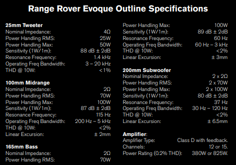

You could've used 4 ohm tweeters, as all Meridian tweeters are 4 ohms. The mids and woofers are 2 ohms on Meridian and Meridian Surround systems. Meridian Signature systems exclusively use 4 ohm speakers. You can probably get away with using 4 ohm speakers with the stock amplifier, as they're all significantly more powerful than advertised. (400w Meridian has a 600w amp, 700w Meridian Surround has a 1,280w amp, and the 1700w Meridian Signature in Range Rovers actually has a 2500w amp).
I've attached below a spec sheet on the Meridian system from when the first-generation Evoque came out, which was the first JLR product to use Meridian sound systems. The speakers are the same today as they were back then.
Thanks for sharing the specs. Actually I forgot to mention all Helix Compose tweeters are 4 ohms. Rest of them are 3 ohms except i3 5.5 and 6.5" which have 2 ohm option.
As Helix was my speaker choice as so far, that's only one makes plug and play speaker adapters. After I got an used Helix V twelve amp, I could use any speakers but just like the idea of vehicle specific mount plates from Helix.
