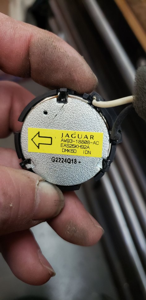

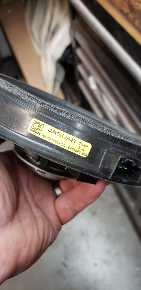

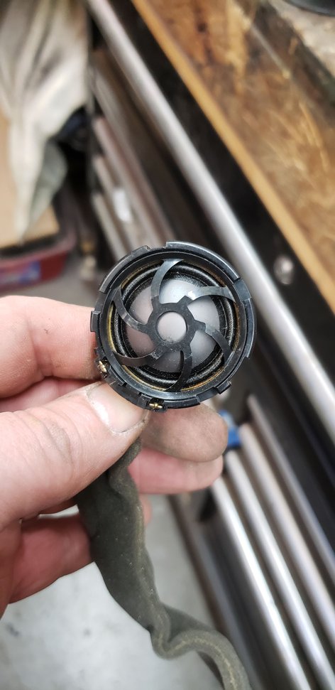

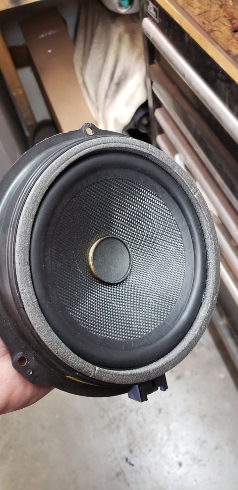

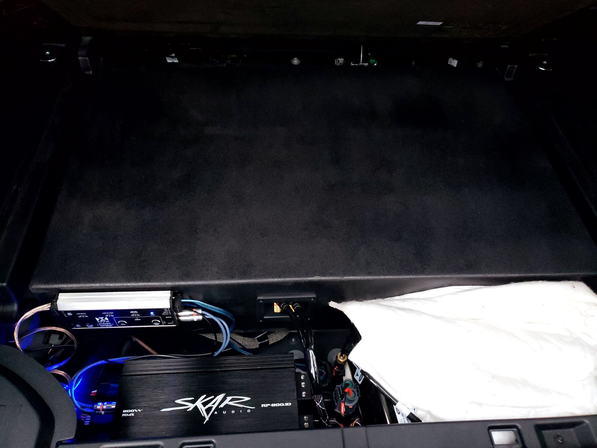

I finished replacing all the door speakers with upgraded factory available speakers from the JLR lineup and adding a powered subwoofer in the cubby below the rear cargo floor. The door speakers are from a Jaguar XJ with premium sound (used off Ebay), they are similar to the Defender woofers in motor structure but the cones are not paper. Side by side comparison while installing (quickly switching back and fourth between speakers while installing) I was able to hear a distinct difference in the two. The tweeters are titanium dome as opposed to aluminum and are a bit brighter on the highs. The box in the rear houses two down firing 10" shallow mount dual 4 ohm voice coil Skar Audio woofers, it is bracketed and suspended over the MHEV electronics, bolted down to what would be the third row seating mounting. I tapped the factory subwoofer signal at the amp (leaving the factory sub in place), and feed it into a line level converter with bass restoration circuitry so that the factory roll off can be added back as needed. Subs are powered by a Skar Audio 800w mono-block class D amp. Power for the system was tapped from the 12V main lead that runs from the 48V - 12V converter to the factory battery. The system has a volume/gain **** that I have mounted within reach at the base of the drivers seat. With a bit of fiddling with settings and gain I was able to get the additional bass to blend seamlessly with the rest of the system. Very happy with the end result. I'm not calling BS Ehloo but I have not experience any engine noise being pumped into the subs. Only downside so far is I have to find a new home for my jack...

i can definitely confirm atleast only Meridian Surround and a previous Defender with same trim had issues with the engine noise.
what stock audio do you have?
Old Oct 23, 2022 | 11:50 AM
  #100
mikelr's Avatar
Joined: Nov 2021
Posts: 89
Likes: 79
700w Meridian Surround
