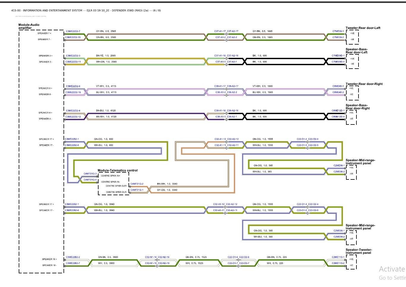

Following this thread as I'm looking at upgrading my door door speakers. More than likely I will be adding some small subs in the rear rear doors that will need further amplification. This will require getting speaker signals from the systems audio amp (located behind the panel where a factory air pump would be located). I did some searching through the factory tech manual and found the wiring diagrams for the factory amp/speakers and though I would drop them here for anyone looking for this information. Note: This is for the premium Meridian system with surround.

if you have a 110 you are very limited in space in the factory 6.5 location. it actually prevents you from lots of speaker options. there is a cross beam support right behind the speaker hole. I ended using a Morel Virtus Nano which is a super shallow speaker
You should be summoning the signal from the factory dsp not amp.
