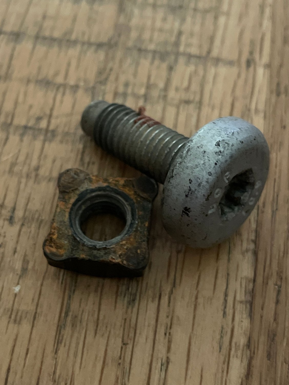

I know this is an old thread but I too have a missing bolt 'E' from my 2022 110 P300 S TReK edition. After dropping the under armor last week to change the oil, I noticed that there is a welded on nut missing from the under shield moputing bracket/brace 'A" in the images abave. So that explains why I am missing a bolt 'E' as there is nothing to thread into.
Anyone else have this same issue?

Here are some black ones from BRITCAR. You might need to weld or tack a nut to the bracket for easy access.
M10 x 25 torq pan bolt

While cleaning up and removing copious amounts of mud from behind the front skid/bash plate, my remaining pan torx bolt came loose. Upon further inspection the other weld nut fell off the support frame. I will need to remove the support brace in order to weld in weld nuts better than factory (hopefully)
2022 Defender 110 Bash/skid plate mounting hardware weld nut failure
