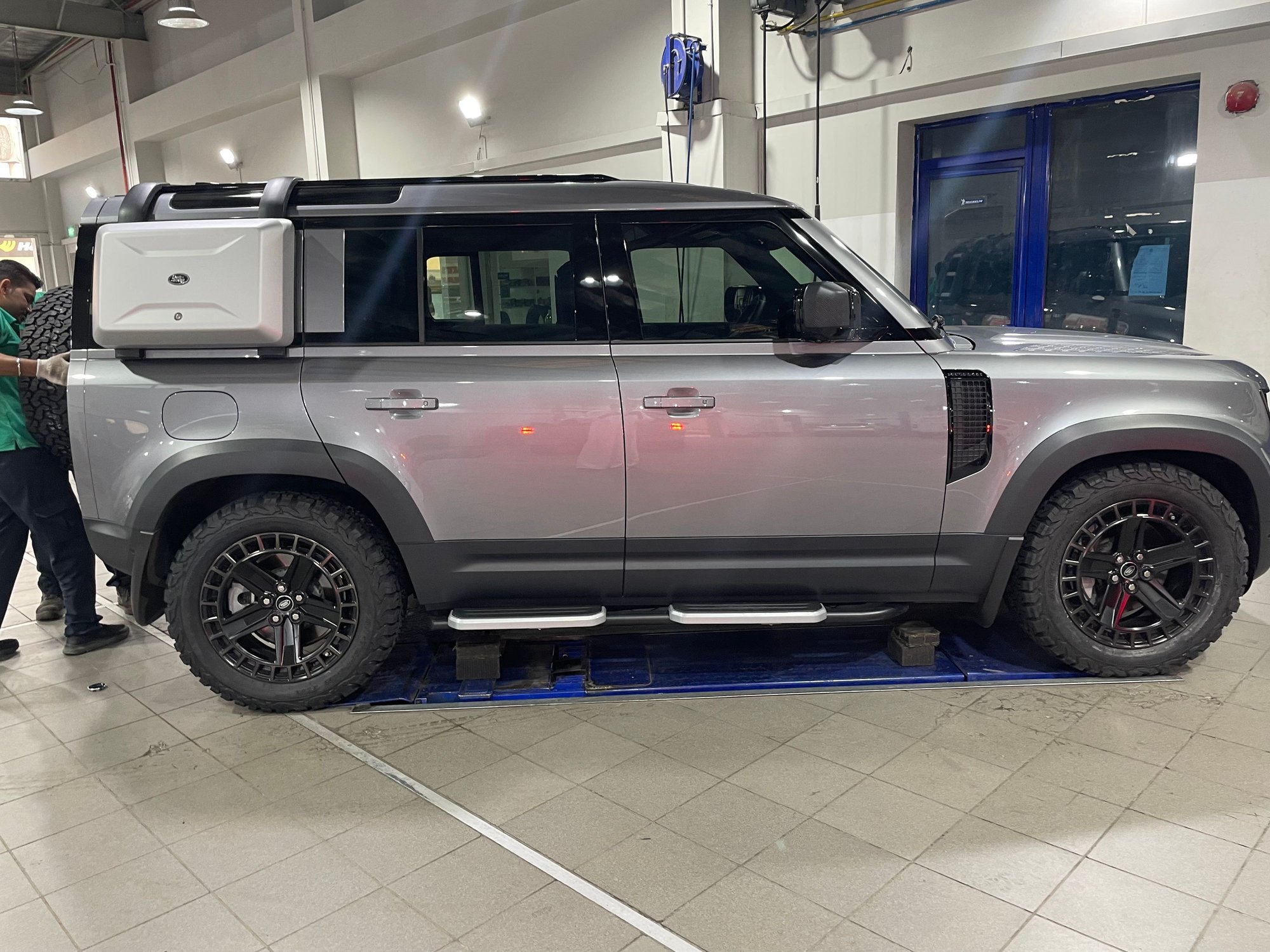

KO2 275/55/20 on the redbourne alston wheel
*UPDATE*
Me and the guys at the tireshop noticed that the defender lowered itself a bit even if the easy access was turned off, as soon as I Turned the car on and put it in drive, the car leveled it self up, and FINALLY NO RUBBING so now I can confirm 275/55/20 with redbourne alston wheel works with no lift.
will share better pictures soon.
KO2 275/55/20
Goodyear wrangler 255/60/20

Originally Posted by aao4473
I tried the KO2 275/55/20 on my redbourne alston‘s and unfortunately they do rub at turn.
That must be the rims, as mine don’t rub at all on the stock rims. I have posted images above.
