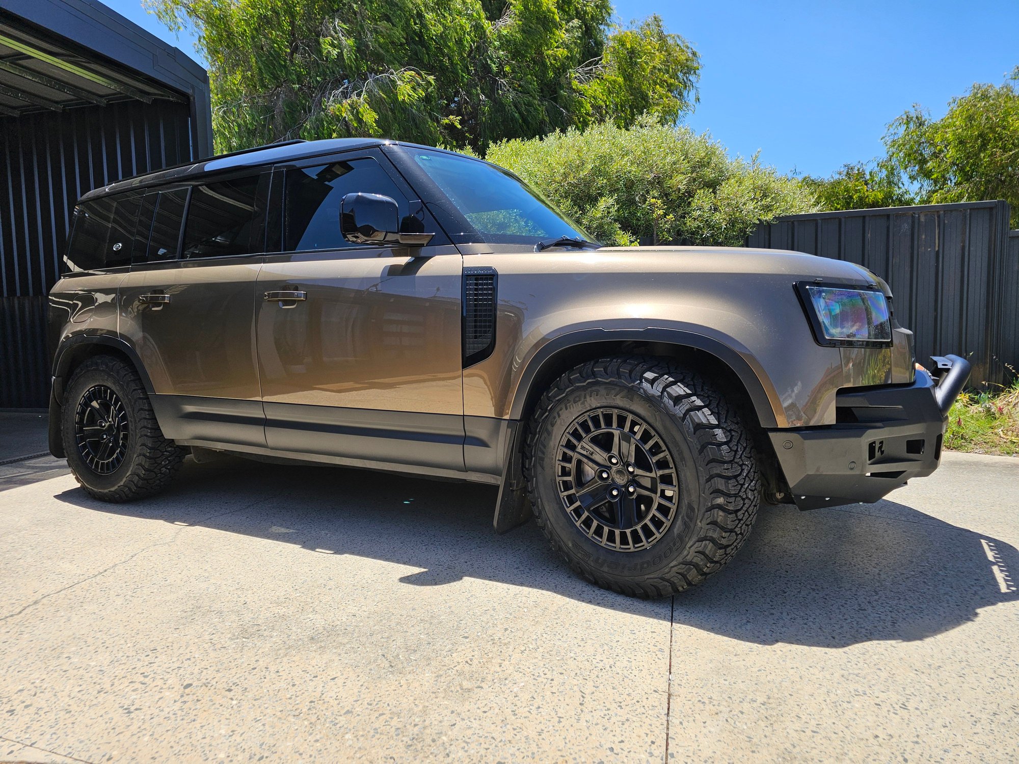

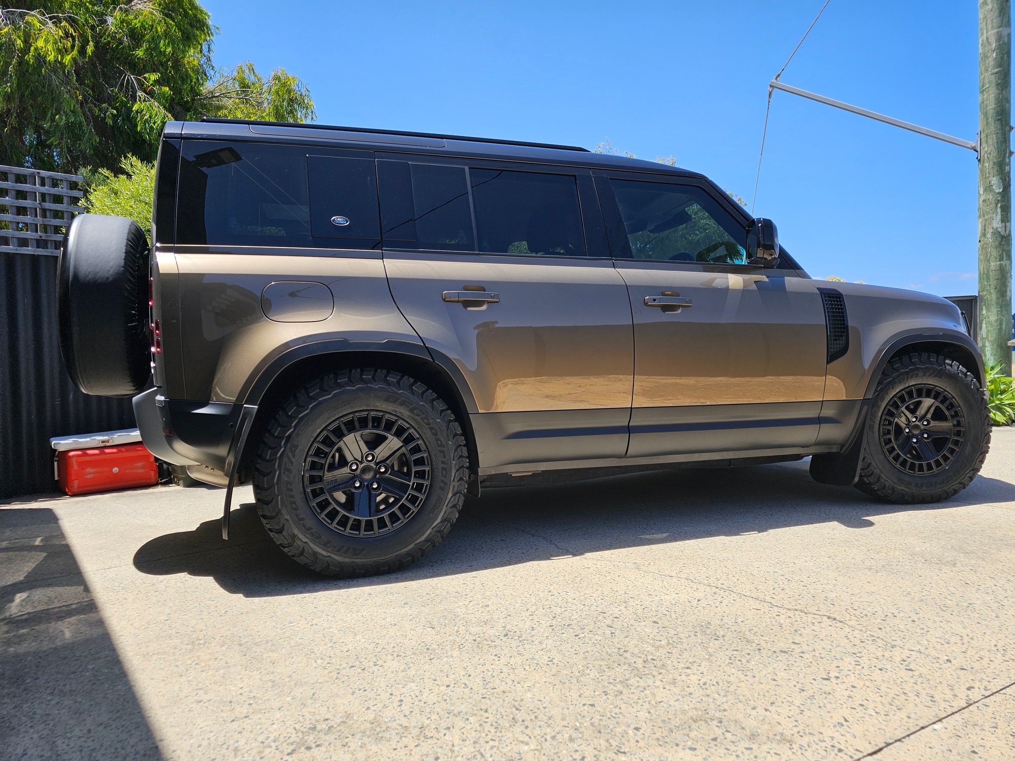

Originally Posted by Dave's Defender
Looks pretty tough now with Black Rhino 18's and KO3's
275/70/R18
Any rubbing on that size tire?

None, just did a week offroad and even at normal height there's no rubbing 👍

You will get far more clearance with the aftermarket steel front bumper than with an OEM setup
I reckon there is no chance whatsoever a 33” tire is fitting without a small lift or a trim, especially on those ET +25 wheels.
I run 32,6” KO2 and there is zero room to spare in access height. ET +29 rims.

Those KO3's are 33.2" so I think that slightly narrower but bigger sidewall size fits no drama's,, at access height it only rubs on full lock.
And yes they have to tilt the coolers to fit the roo bar so there's more room straight away that's why I got it "2 birds 1 stone" kinda thing

Yes. That's in line with what I was visualizing. The front bar-work is most excellent. Increasing your tire room and approach angles all great bonus features.
KO3s look to be a fine tire choice.
