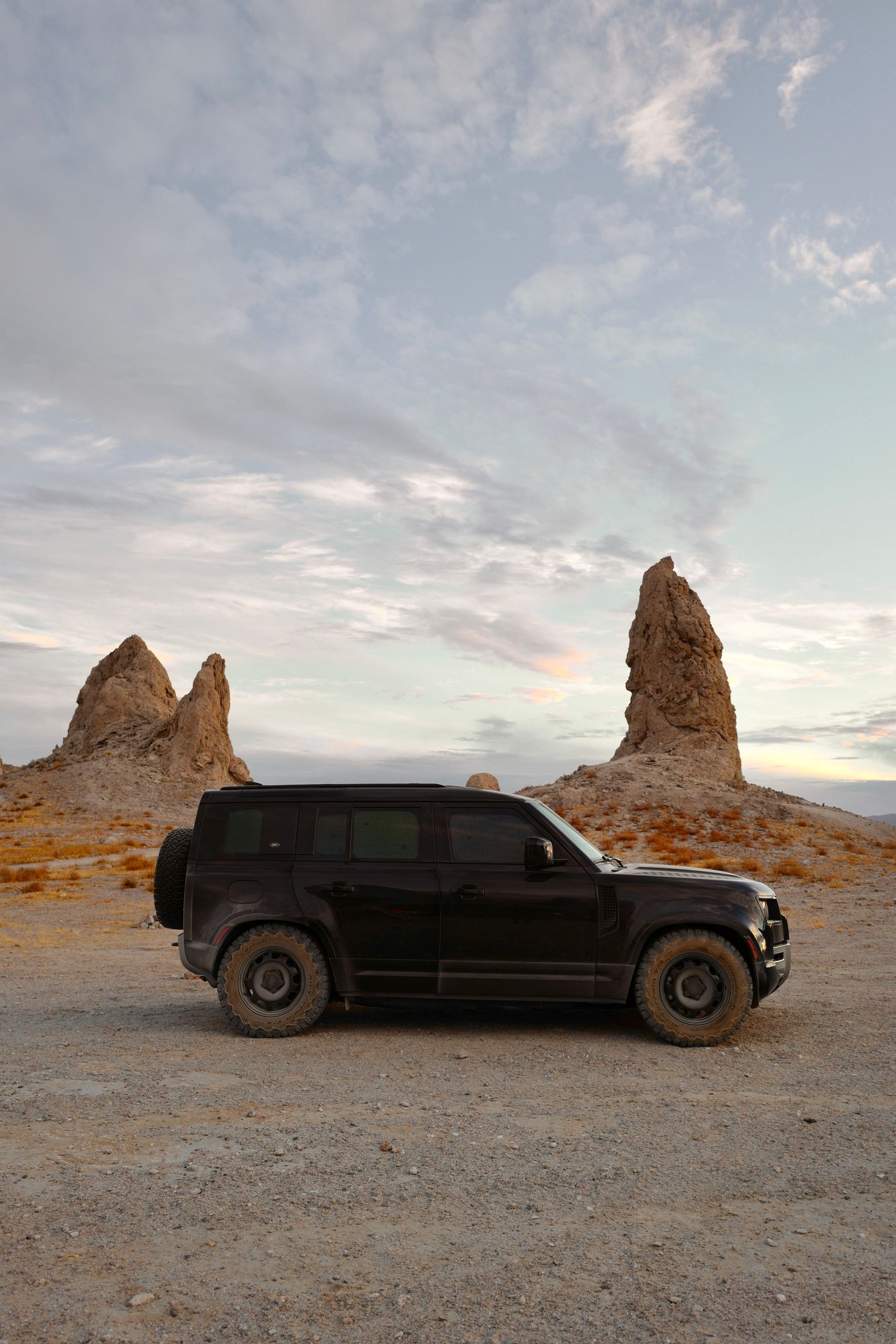

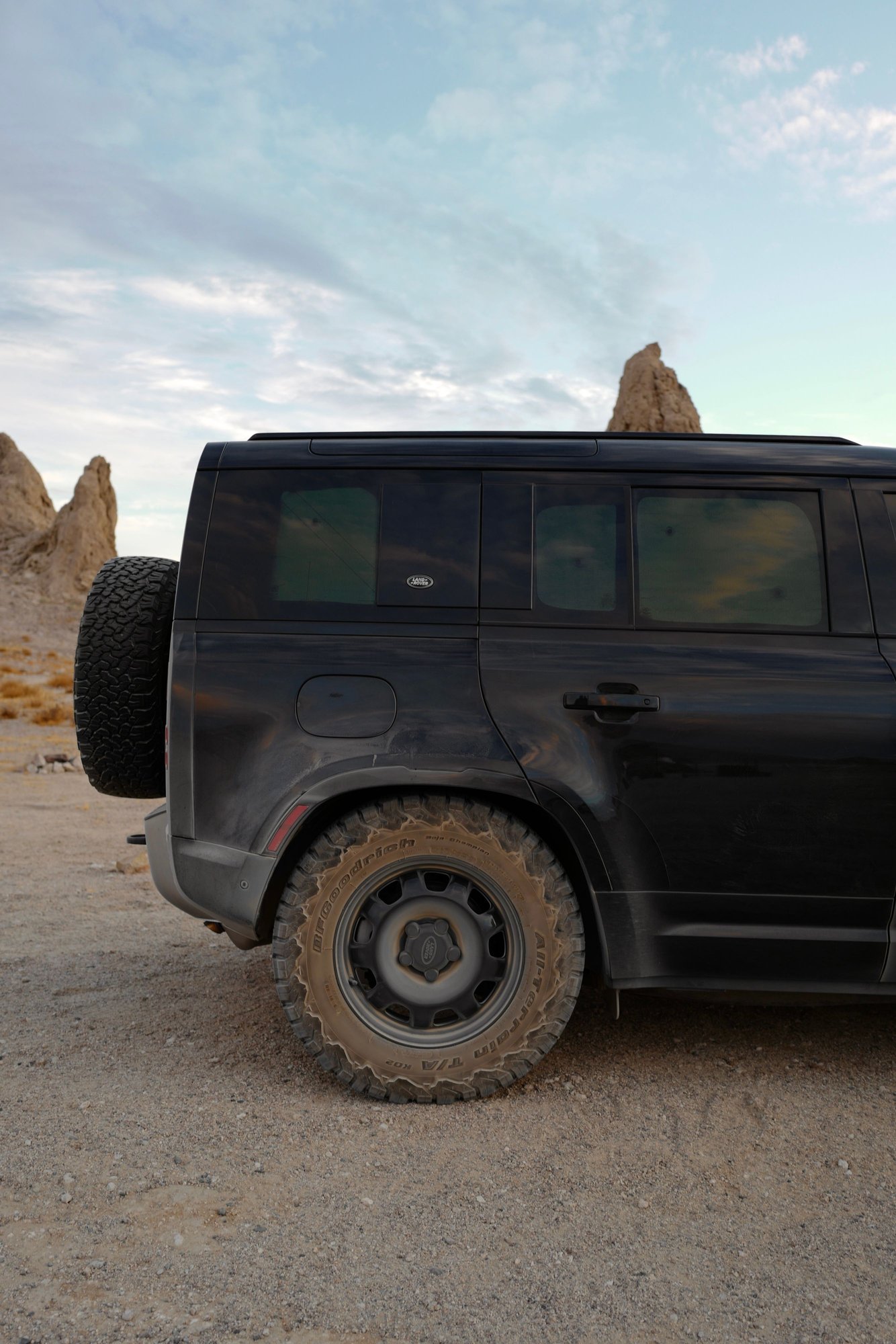

Looks pretty tough now with Black Rhino 18's and KO3's
275/70/R18

265/70/18 KO2
