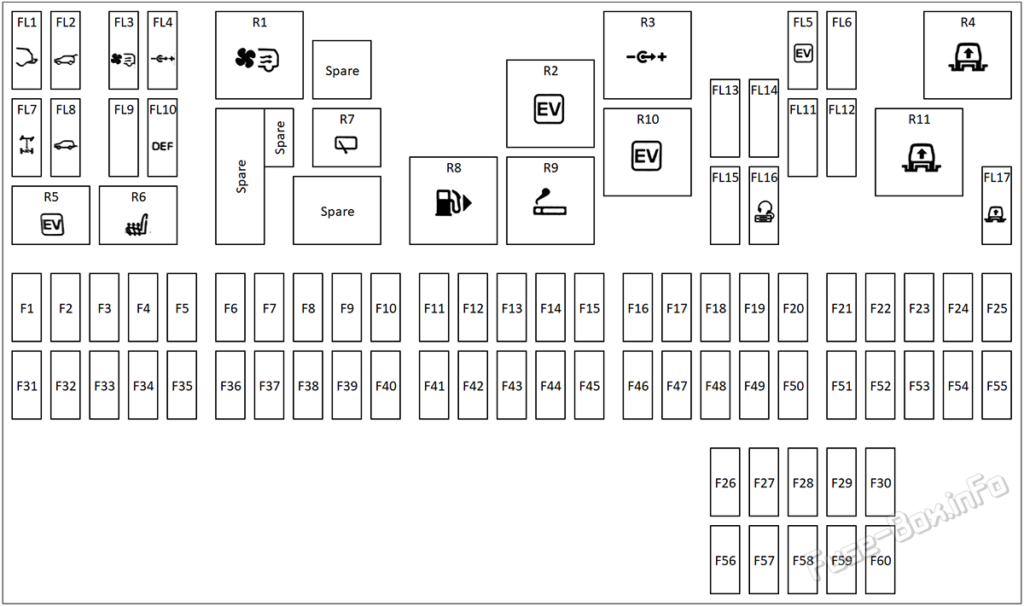

hi, can anyone tell which fuses to check in my booth fuse box to pier my 3 x 12v cigar sockets ?

Fuses 1 & 2 in the fuse box behind the glove compartment are for the front cigarette lighters and accessory outlets, and 4 & 10 are for the rear USB ports & accessory outlets. Both are 20 amp yellow fuses. In the cargo area fuse box, fuse 18 is for the 110v outlet - also a 20 amp yellow fuse, and number 21, a 20 amp red fuse is also for the second row accessory sockets.

Yep there’s a little piece of paper on the fuse box in the cargo compartment too - do you have that? It’s pretty helpful. Took me awhile to find it he first time I removed that silver cover. That paper has the diagrams for BOTH fuseboxes I believe -- the rear cargo fusebox and the glovebox fusebox.
