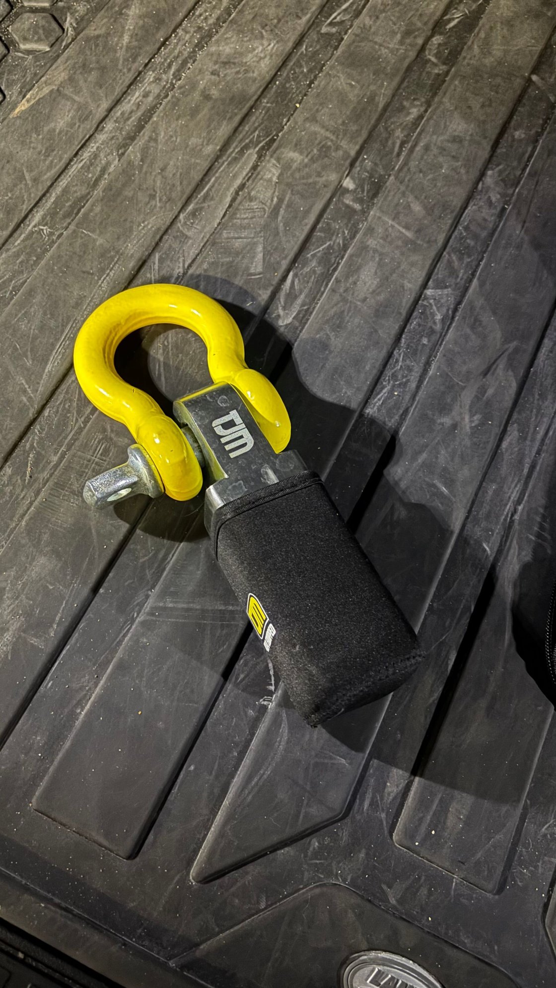

TJM tow bar mounted shackle

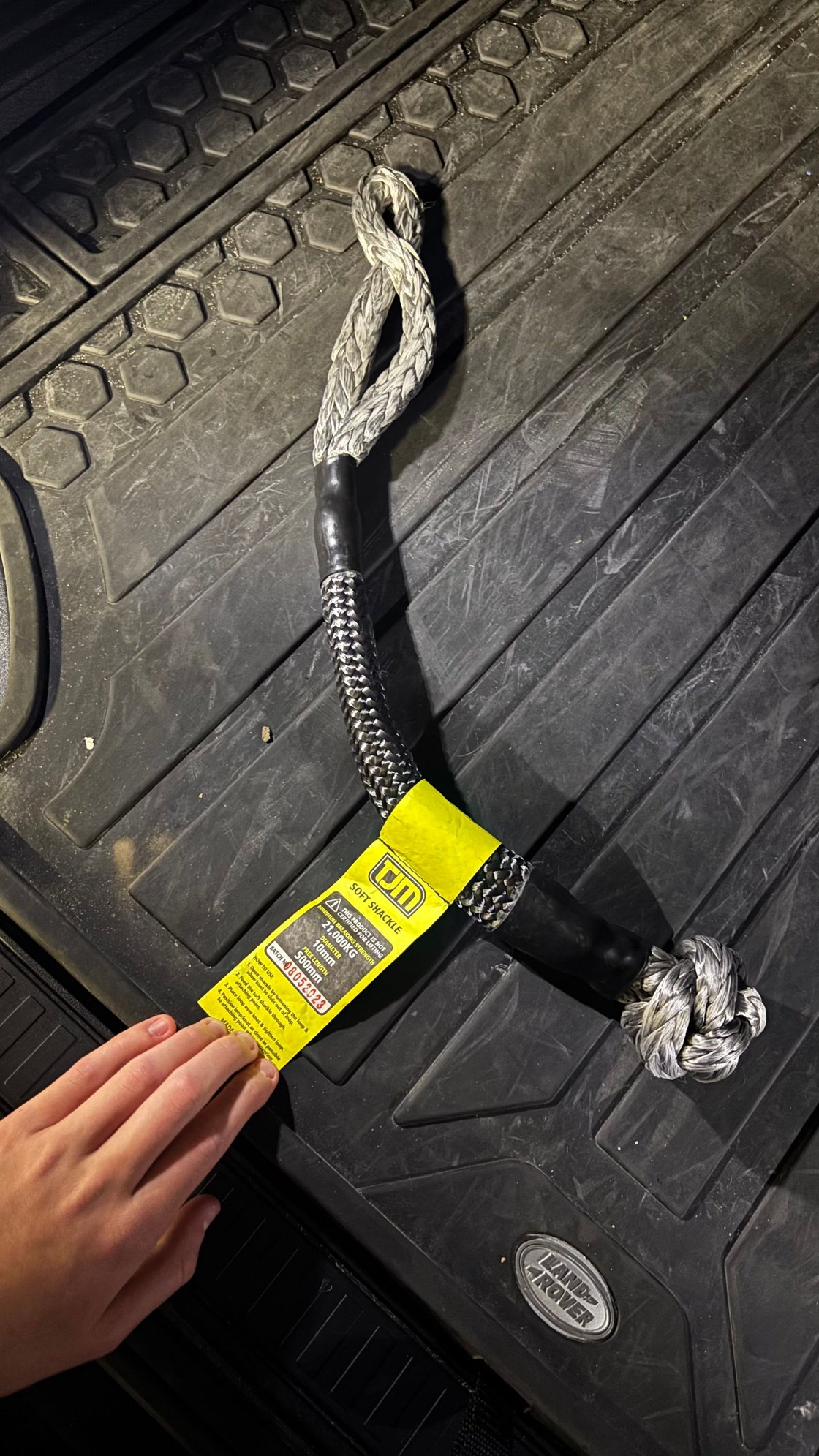

TJM soft shackle. Rating on label

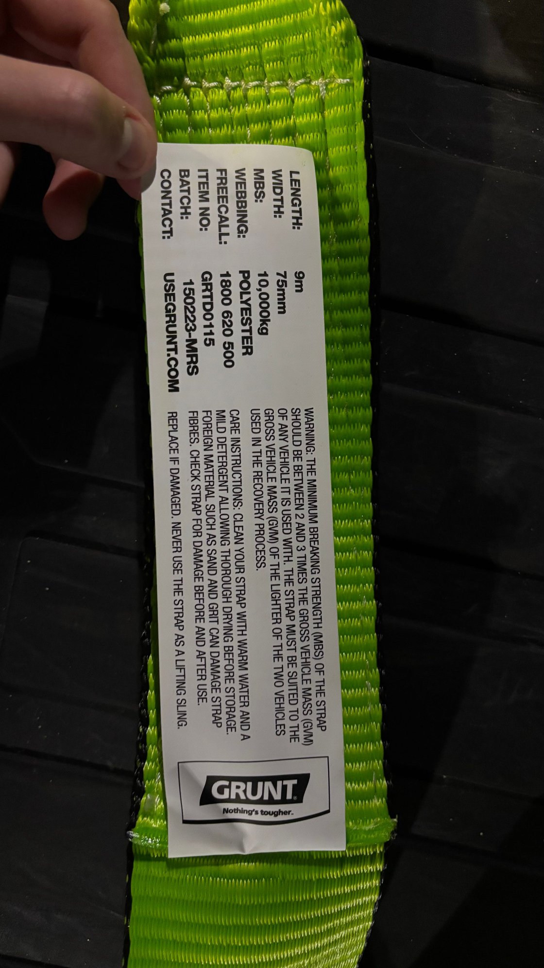

Tow rope (not elastic). Rating on label
Good? I think another soft shackle wouldn’t be in vain.

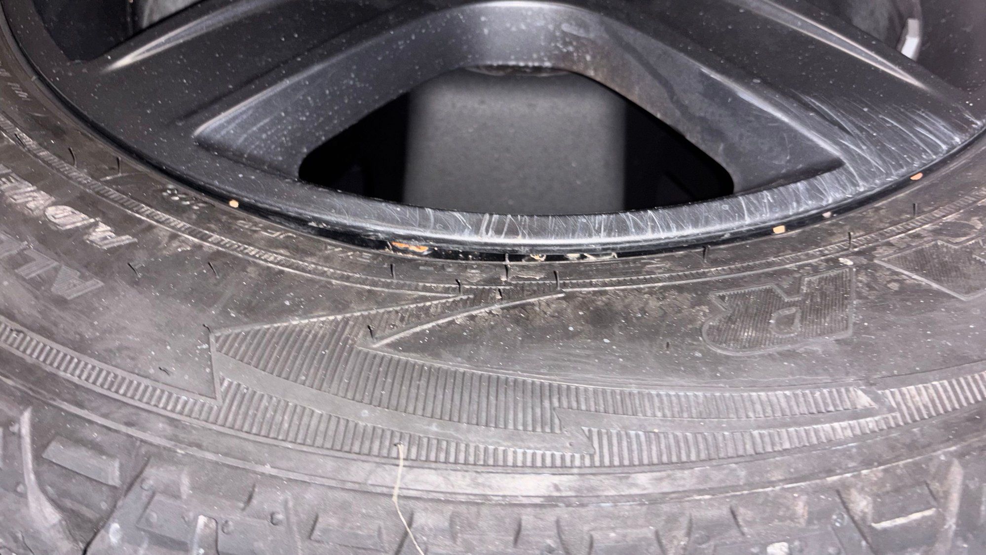

Hand saw and extinguisher is a very good idea, first aid kit it covered though. Also, I understand about the rim damage - it’s already done
worth making sure the hitch pin is also rated as it takes the load. Again, I like the Factor55 ones as if memory servers when I asked them the load rating it was 50000 lbs or more than enough.
TJM soft shackle. Rating on label + Tow rope (not elastic). Rating on label
A tow rope is worth having and can be used for extraction in a pinch - just don't lay the hammer down as it's not a dynamic/elastic rope. I won't comment on rating on labels for ropes or shackles2 as I can't do the conversions in my head anymore :-) LOL Just ensure they are rated/sufficient for the weight of your LRD as it's kitted out
More shackles provide more rigging options and options are always good to have. Two is certainly a minimum for single line connections - one at your vehicle one at mine.

The tow bar shackle has a max load of 4750 kg, and the Defender weighs 2100 kg. Enough tolerance?
Now, on the toe rope, what exactly is a rope rope used for? And, what is the difference between a ****** strap and a kinetic rope?

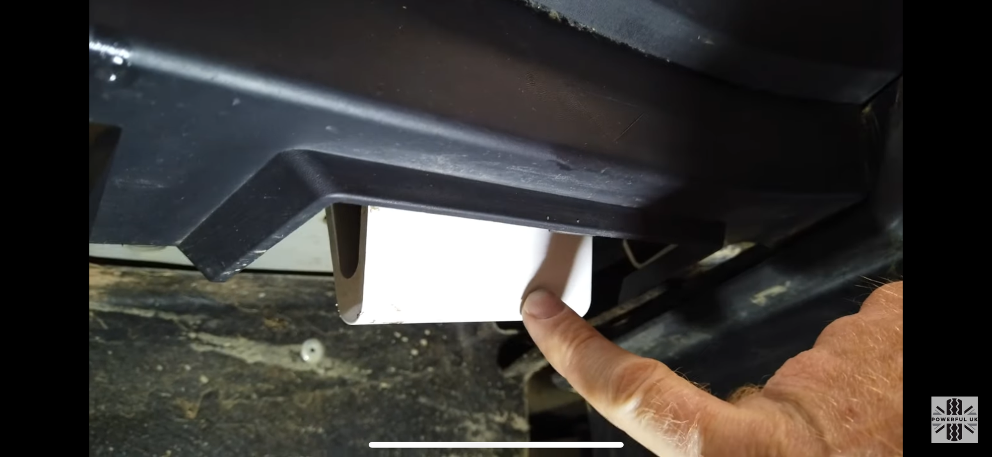

In terms of jacking with the bottle jack, are you referring to this as the pinch weld?
Thats a silly question. But anyway, where is the pinch weld that you can jack the car from? Also, where do you store your bottle jack in the car? I’m apprehensive about losing the factory styrofoam insert for a metal one because I don’t want everything to be rolling around or something to go wrong and the sensitive electronics beneath get smashed/wet.
