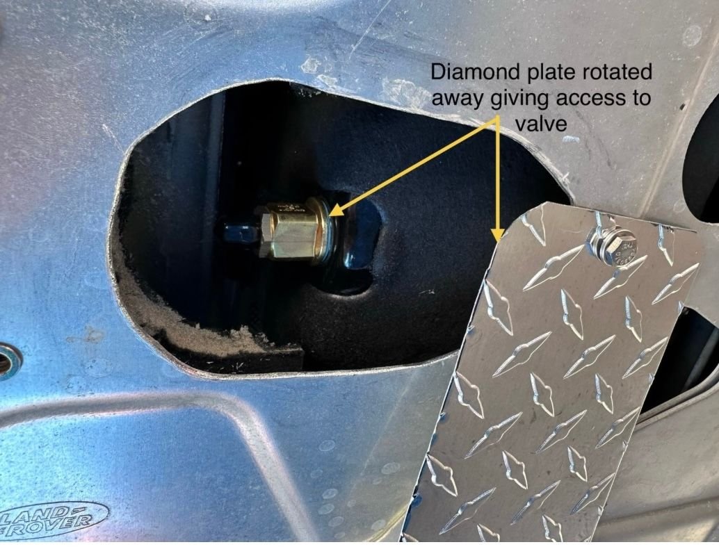

I’m with you on the ‘old fashioned way’. And I also always ‘underfill’ slightly then add a bit at a time after driving a few days. And with a 9 liter capacity, being a 1/2 liter low will cause no harm. My first change it sure seemed like a lot of bolts, but the first time always takes longest, each time after takes less time, especially using a power ratchet. I also found that after removing the first undershield plate, there were a few bolts hidden under the fiber liner. To avoid removing that each time, I used a utility knife to expose the bolt heads. Also, to make future changes even quicker and easier I went with the Fumoto valve and created an access port to the valve, but if one prefers to not go the Fumoto route, the access plate will still allow one to remove the drain plug without removing the undershield plates. Oil changes now are a breeze.
Also have the Quick Jacks and added these casters using zip-ties. Now I can roll the quick Jacks into place with a nudge of my foot instead of dragging them into position.

I really like the access plate. This is a good idea. I may have to attack that soon. I’m not even at my first oil change yet, but again - am an overkill guy. It will get changed at 500 miles, then every 3-4K after that. People will say “you are wasting money”. Fine. I won’t go poor - and it is piece of mind for me/theraputic to do it…
What kind of threaded inserts did you install on the skid plate to fasten the diamond plate to? (I can just barely see part of one of them in one of the pictures).
