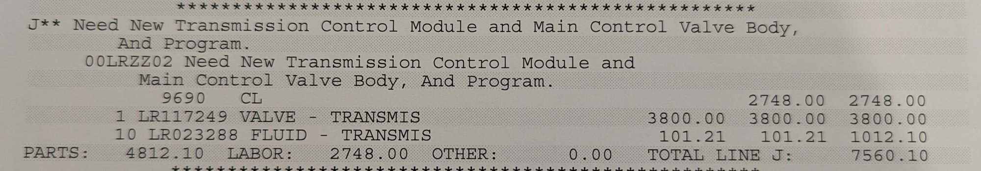

This code/error resulted in needing a new valve body for the transmission. They hadn't seen this issue before and I haven't found any examples of this ZF8 failure online either. This was $7560.10.

Far out! That is not a small repair bill. As for the transmission oil - I believe it needs 8.5l - looks like you been charged for 10l. (unless there is some different unit 'measurement' in the US).
That said, the specified oil for ZF gearbox transmission (being Shell or ZF) you will probably find cost about $30-33 per litre. You are looking at $280 worth of oil, or even for the alleged 10l they charged you, cost them no more than $330.
Looking at the cost of a new valve vs a reconditioned, if it happens to me, I'd happily save circa $3k for a reconditioned one at anywhere from $600.
Cannot comment on the labour involved as they probably would have thrown in the diagnostic & reprogramming fees in there as well.

The part is also available as reconditioned if that's of interest for about half that.
The oil and transmission pan are available from a number of vendors at a fraction of that cost. Essentially buy with the ZF part numbers rather than LR and you save a packet for the same OEM parts.
Case in point. Same ATF is $15/liter. Amazon also have it.
I wonder is there much labor needed, once you have the pan off, to remove the old valve body, and whack in a new one. Seems like it's on the underbelly of the transmission. I'm looking at doing a preemptive transmission drain and fill in the next year or so. Not sure I want to wait till 105k miles.

Ouch! Sorry to hear that. As other point out the mark ups that dealers put on parts are really getting ridiculous...
