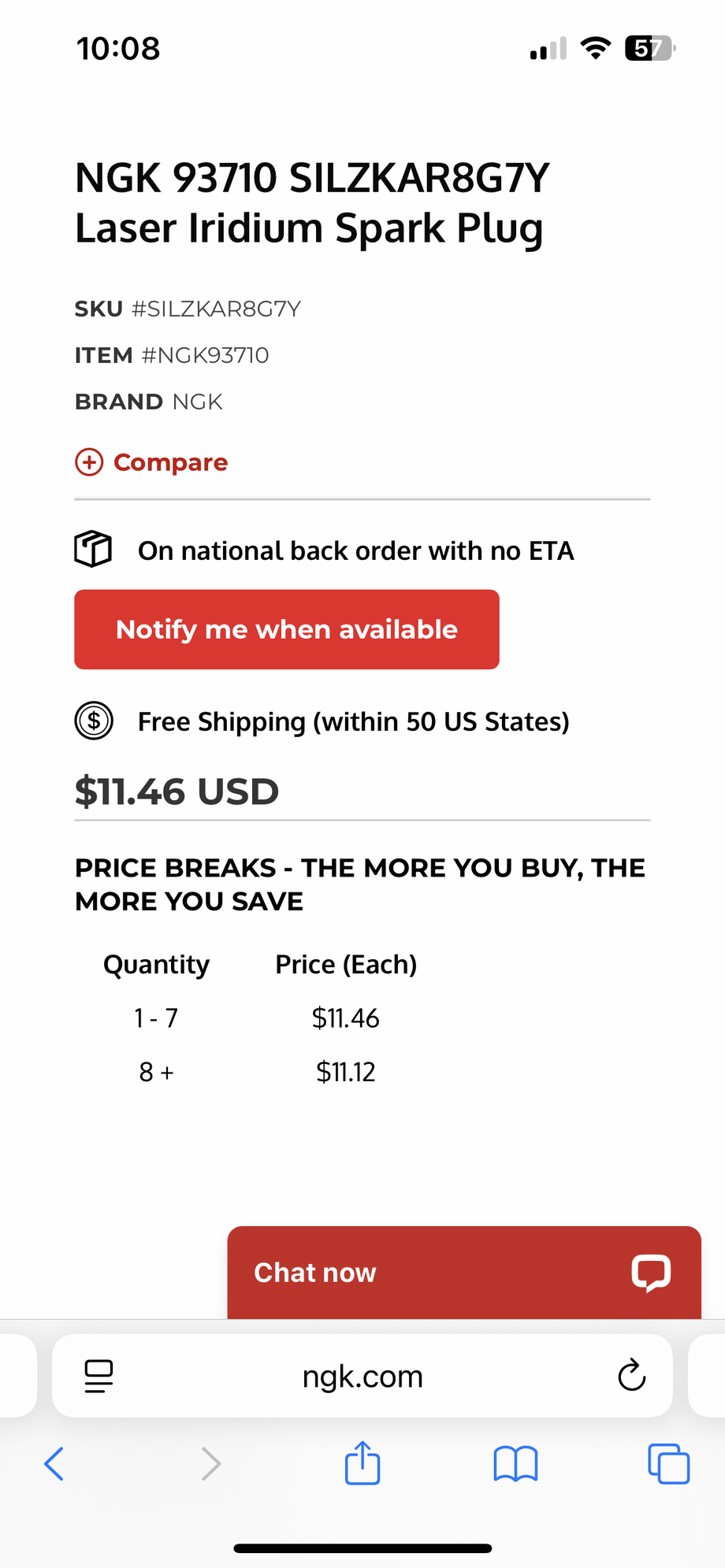

I’m at just over 51k miles on my 2020 X and going to be ordering oil/filter, a few other maintenance items and am going to order plugs too.
Has anyone used the Bosch 8502/VAR6SIP plug or is everyone using the LandRover LR091617/LR178881/NGK SILZKAR8G7Y 93710?
I buy everything I possibly can from FCPEuro and see that they have both. I’ve always gone NGK over Bosch, and am leaning toward NGK as they are the oem but wondering if anyone has seen/heard/experienced anything for or against the Bosch plug?
Seems like the NGK plug is unavailable everywhere unless you get the ones in the landrover box for double. LR box is up to 25-32 each now whereas the NGK box is 11-16 but unavailable everywhere, including the NGK site showing national backorder.

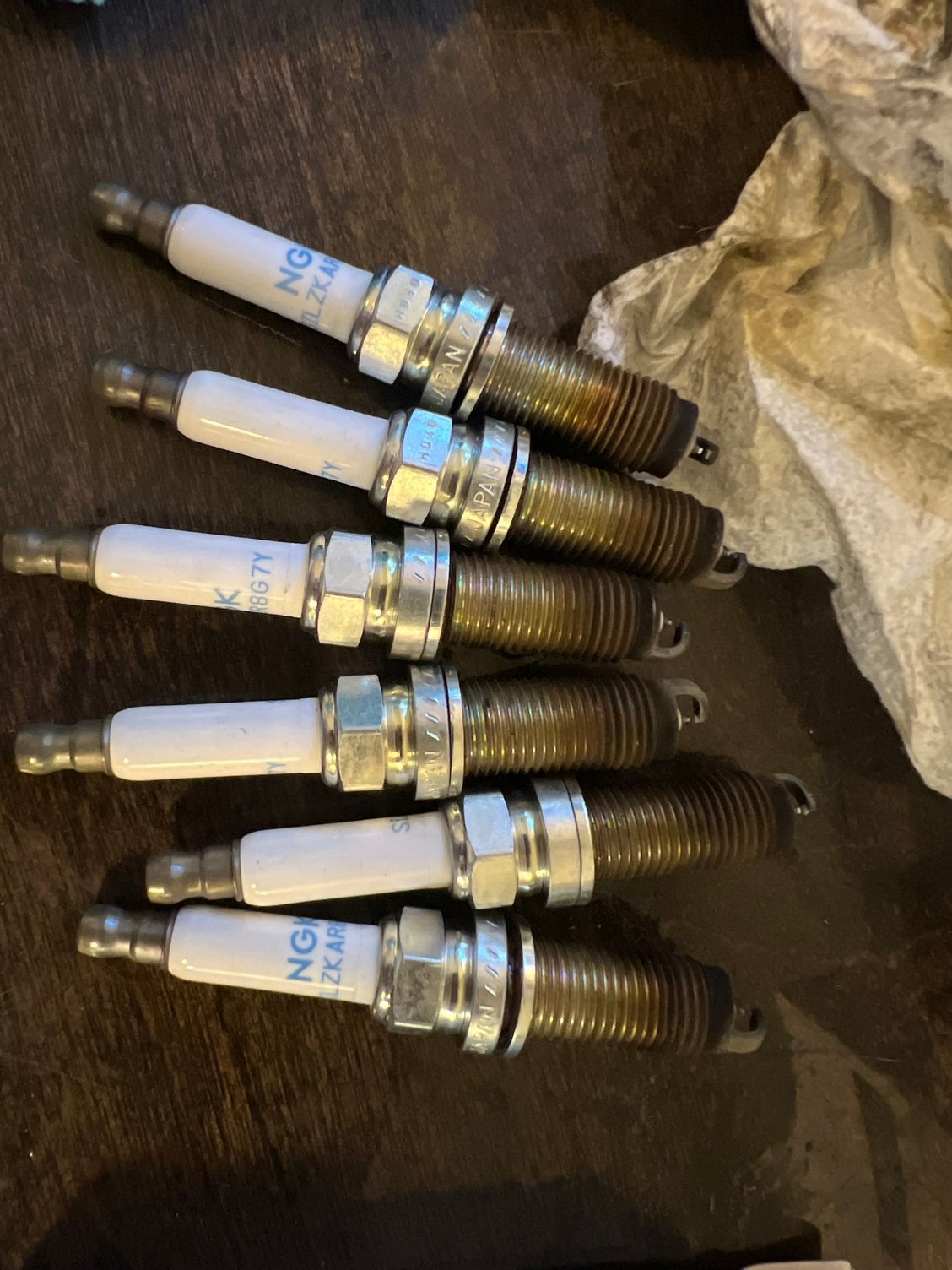

Got the 6 oem plugs and finally got a chance now that I finished replacing the roof on my house to get at the plugs and an oil change.
Holy hell, snapped the wiper arm puller from Amazon, as well as another 2 arm puller I had. Ordered a different puller, hoping to try again in a few days.
Used penetrating oil, the nuts cracked free easily and it’s a Florida car from new, IDK.

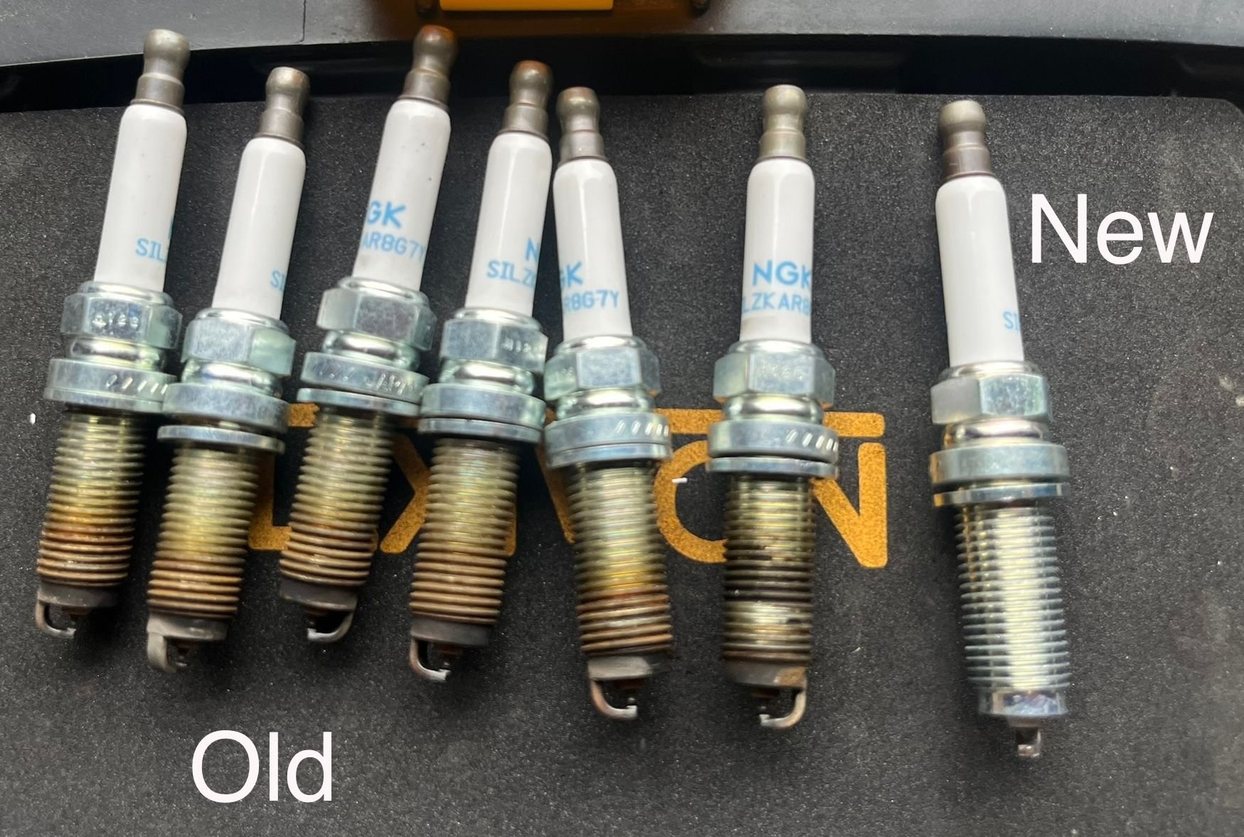

Got em done tonight and then did an oil change too.
Took a solid 3 hours.
Having that other wiper arm tool was a blessing. Take the wiper arms off, cowl under the arms, I ended up taking the a pillar trims off too, not sure if that was actually needed or not but was able to get behind them clean them up and get them put back on.
I would definitely recommend taking the plastic trim piece that has the little rubber edge at the very front of the car off, it’s black texture plastic that runs between the headlights and has the openings for the hood catch and latches, so that you don’t inadvertently rip that rubber seal off.
Placing the intercooler into service mode, I would definitely recommend the following, it made it easy to pull it up and lay it back down in place.
-Left side has one 90degree rubber hose from the intercooler to the intake manifold. Don’t loosen the intercooler side, loosen the manifold side.
-Right side has the main intake hose from the turbo and then a smaller hose behind it from the supercharger bypass to the intercooler. Front main intake pipe fiddle with the clip to get it snapped into the release position and break it loose. Loosen the clamp on the rear hose on the intercooler side and unclip the clip on the supercharger bypass, pull that lower part of the hose off the supercharger, then the intercooler will tilt up and out of the main intake hose pretty smoothly and then lay back down and clip back in well.
