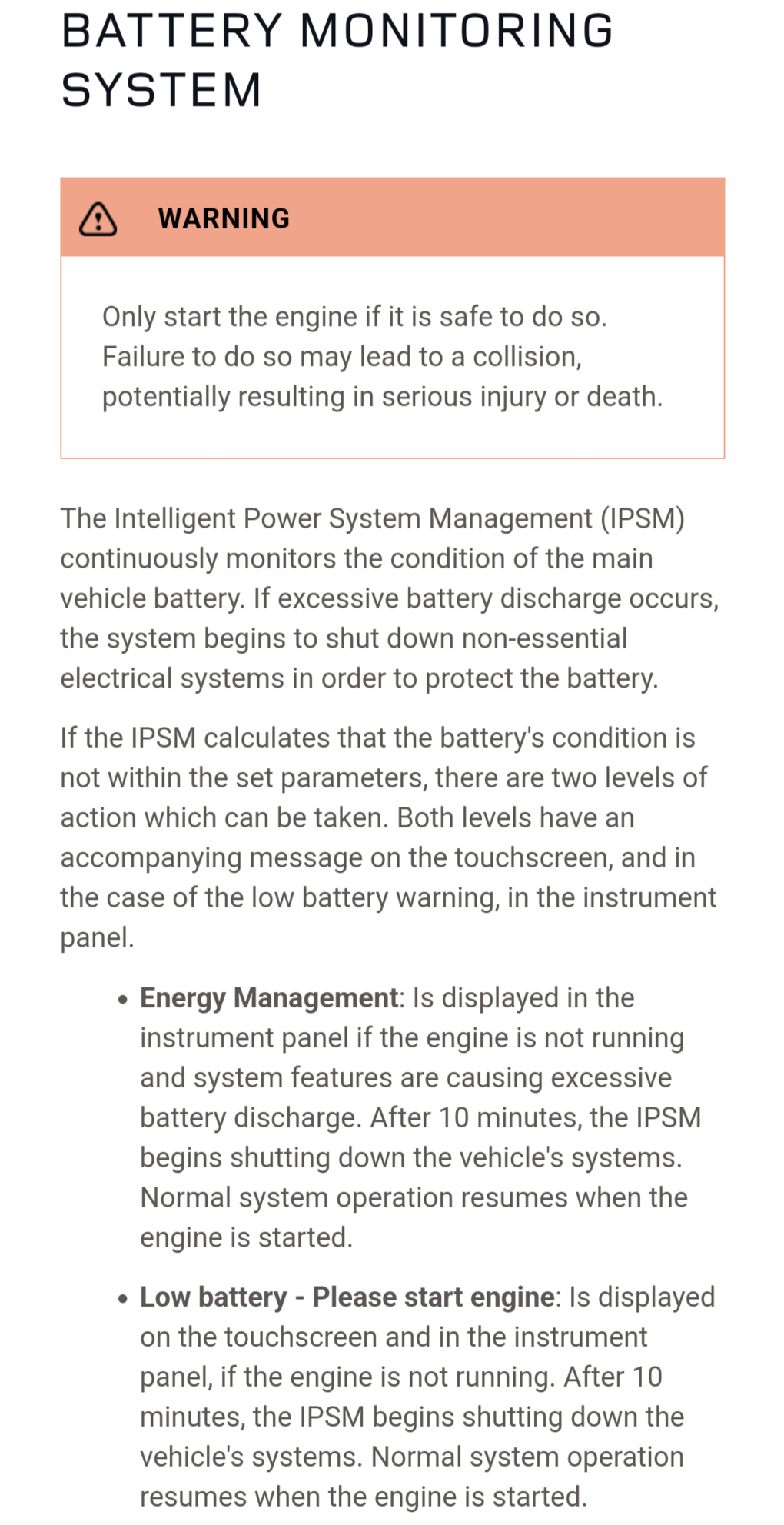

That's part of the battery monitoring system. Unplugging prevents battery data from being sent to the ECM which then will not engage start/stop as a fail-safe.
Problem is that there are other systems involved.
On other JLR vehicles, there are better ways to do it that only turn off start/stop. I did it on an XF and an F-Pace under the dash. No idea on a Defender and I don't care bcs, to me, start/stop has been improved to the point where it doesn't bother me.
Going through the workshop manual with a search for "battery monitor" will show other systems affected by the BMS.

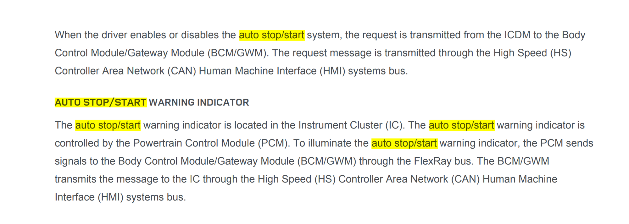

I remember in one of the Jags that there was a 3 or 4 wire plug that connects to a module next to the fuse panel. This wire supplies power to the start/stop system.
Unplugging it throws an error when the car is started. Something like "start/stop not available" but that clears and no other systems are impacted.
No idea if the Defender has a similar set-up but it would be in the good book if it does. Just have to find it.
https://landroverforums.com/forum/20...0-p400-109129/
