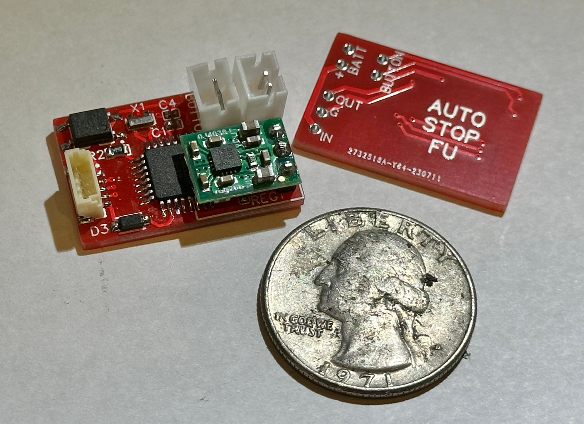

All right, I conquered this annoying feature with a brute force hack. After researching 4-5 different ways to disable the auto-stop, I decided that a small custom circuit embedded in the console was the least intrusive to the vehicle. I made a tiny PCB that waits 30 seconds after the car turns on then presses the button once for 500ms using an opto-isolated relay. I'd prefer not to piggy-back a circuit to the console PCB, but other options including changing the CCF files, doing a CAN command injection, or disabling battery health monitoring cable all seemed equally problematic. This fix only cost me $25 in parts, but unfortunately it is not a fix I can share easily, because the PCB, components, and connections are all custom designed/ordered. I also wouldn't want to be responsible for anyone hacking into their console and bricking something (it is very delicate work under a scope). So, I'll be watching this space for a better solution, but for now I am living the button-free stop-free good life.
