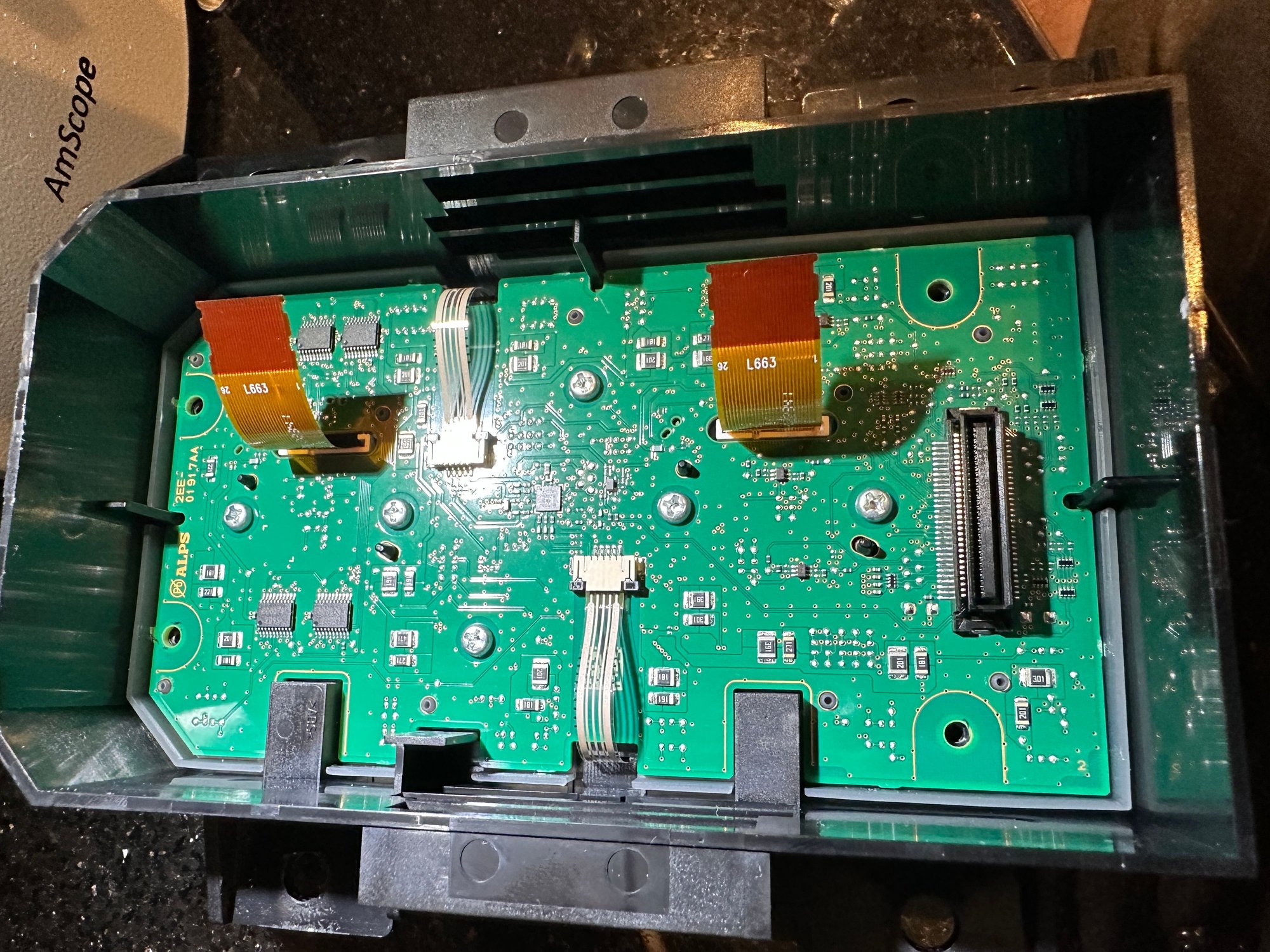

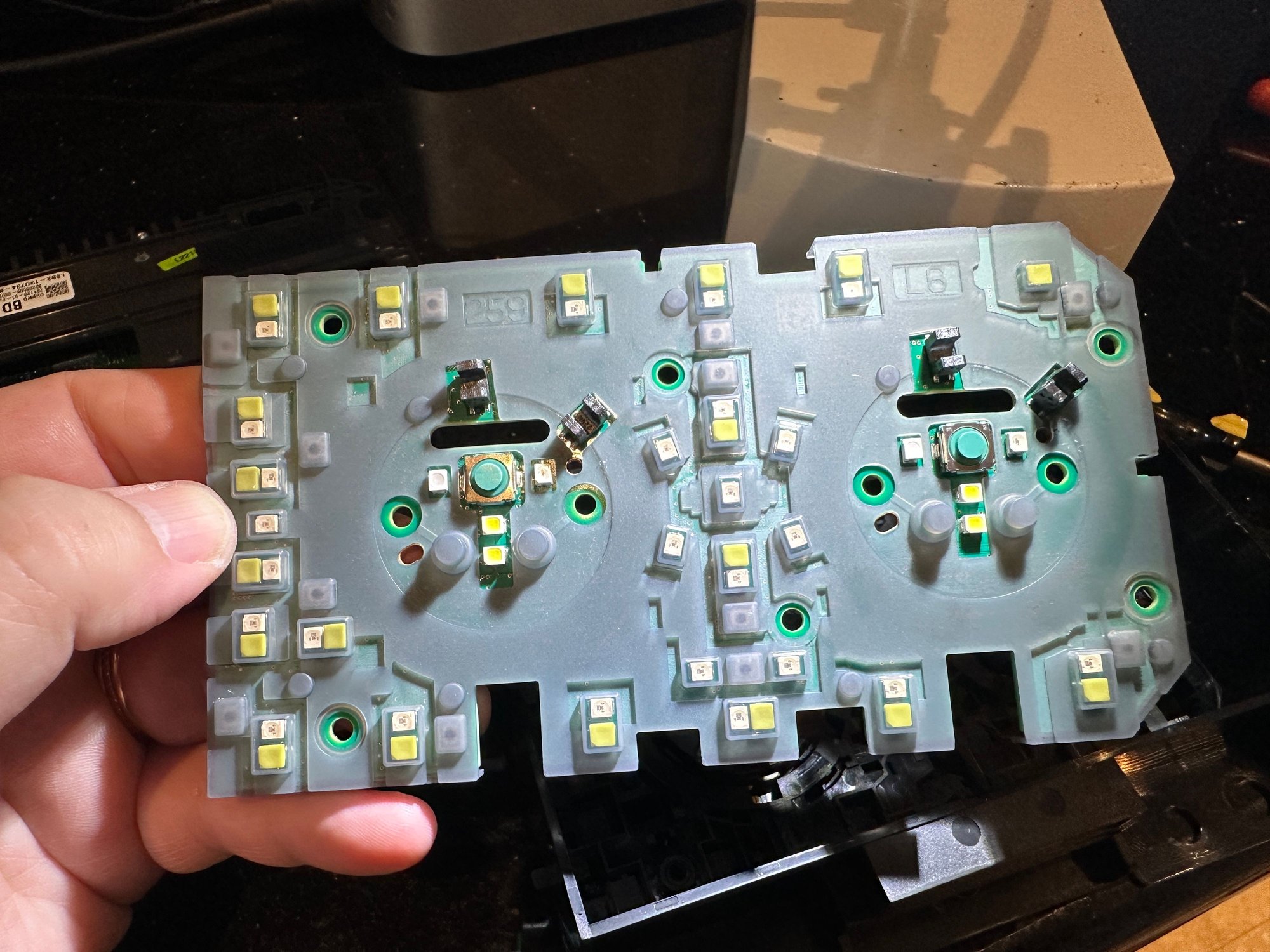

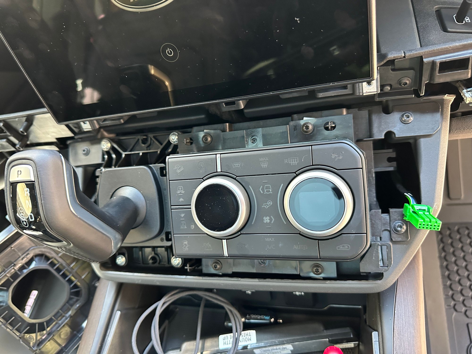

So I pulled out the switch cluster that controls the auto start/stop to see how easy it would be to tap into the A button with a hardware solution. The cluster was easy enough to pull out, but getting down to the actual PCB and a place to tap into the switch was evil. There are micro ribbon connectors and the tap point would need to be a .5mm via on the board. It could be done, but solving with software is the better solution. Anyone in SoCal with GAP IID or a CCF editor? I'd prefer not to purchase a copy just for this one single use case. Thanks!

Probably best to buy a GAP tool, there's so much more you can do with it and it will be really useful if you keep the vehicle.
