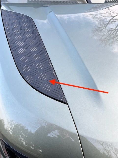

The plastic diamond plate panel on the passenger side of the hood of my 2022 SE P400 has started to peel off. It looks like it's held on, at least in the front, by 2-sided VHB tape, and that's come unglued. It actually looks like the same attachment method as the checkerboard protection kit pieces. (I'm using a small piece of black duct tape to hold it down right now.)
I can't seem to find the part online, even looking at the exploded view of the hood on some parts sites. I'm hoping someone knows either the part number or what its official name is. (Some of the British parts name are not obvious to me, e.g., "plinth.")
Thanks.

For some reason they call it a "scoop". It has something like 8 or 9 white plastic pins that hold it to the hood and double sided tape at the points. If I was you, I would just redo the double sided tape. Powerful UK has a video where they remove it from the hood- none of the pins got damaged.

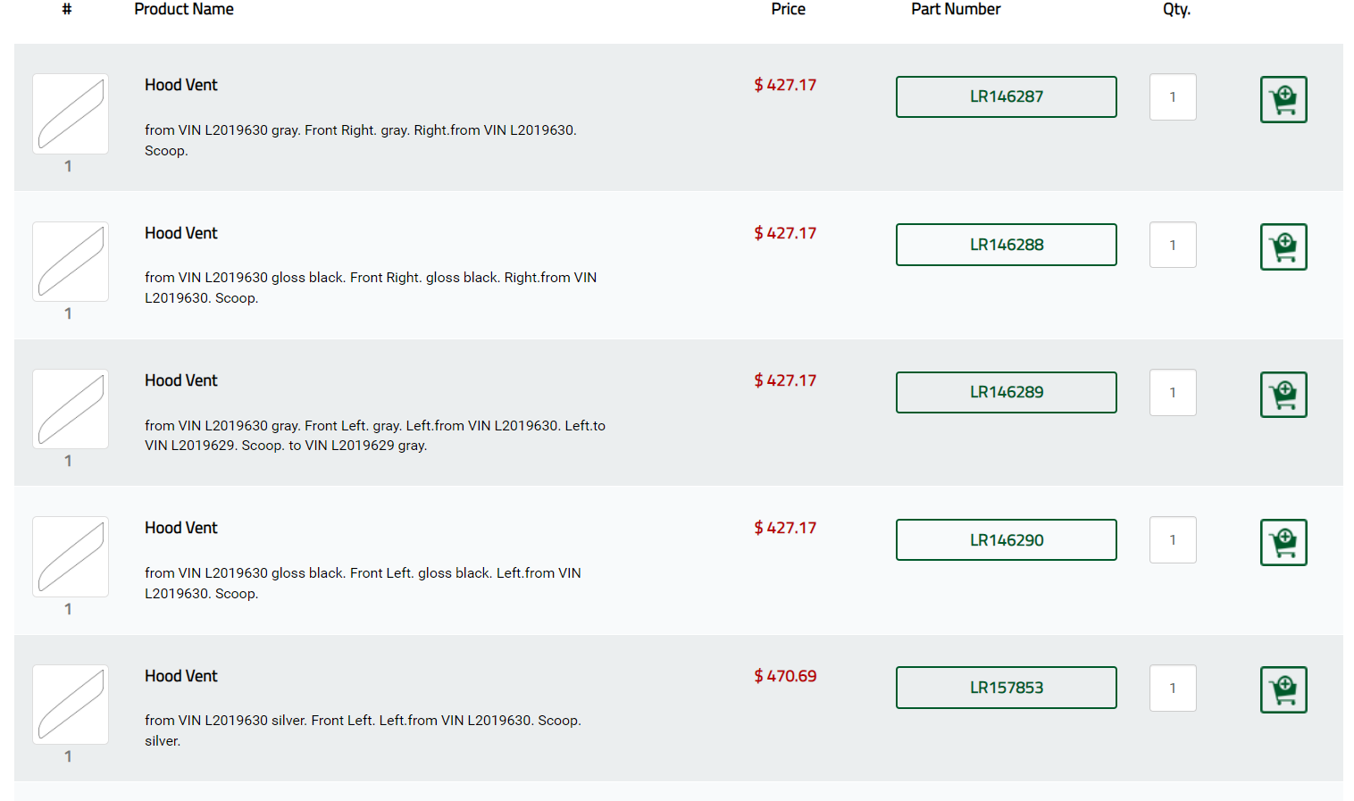

EDIT: Here's the part #s. I recommend securing it, because even if you can find it cheaper - it's likely to still be expensive:

Thanks, all, for the replies. I actually did see these but thought there was no way that piece would be over $400!
Looks like I'll DIY this until the dealer gets the replacement part (they've committed to replacing it, but the part is taking a while to arrive).
