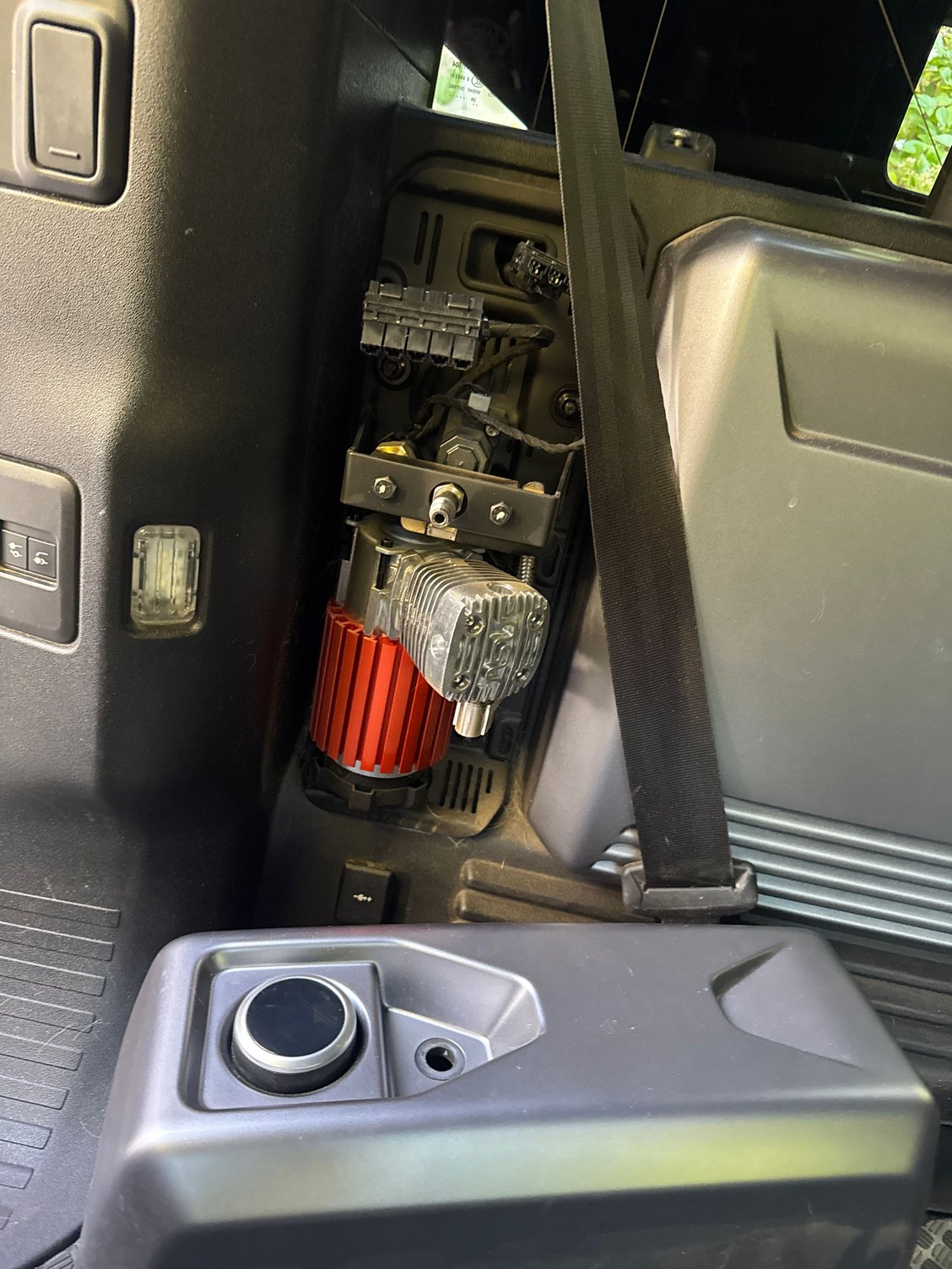

5) On mine - remove the accessory air compressor - which was easy for me because I’d installed it. Remove the cover, then undo 3 bolts, careful not to lose the spacers and rubber mounts, then undo 3 wiring harness connectors. Set aside.

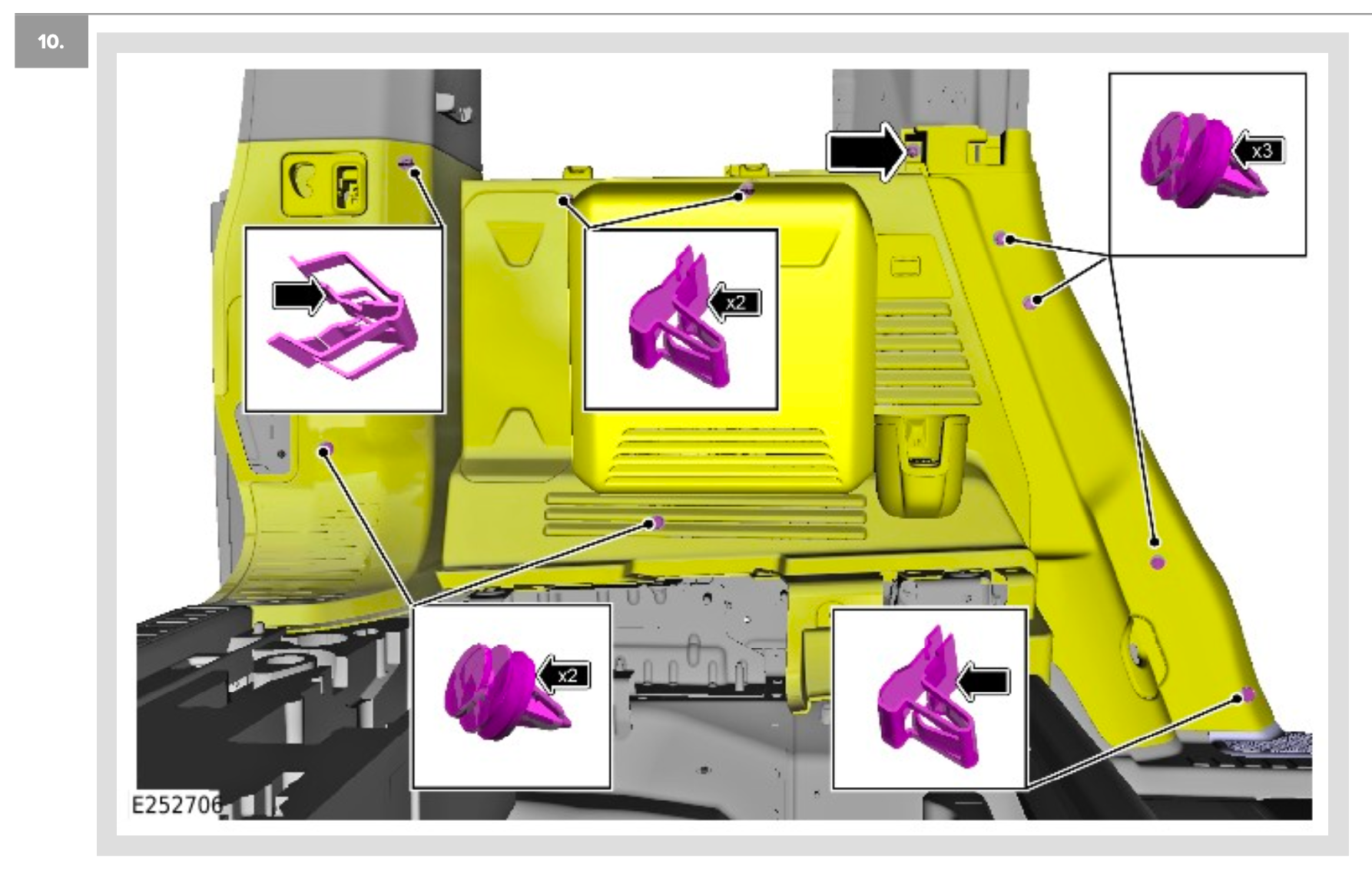

7) Remove Left Rear Cargo Trim panel - clips as described in the service manual - picture below

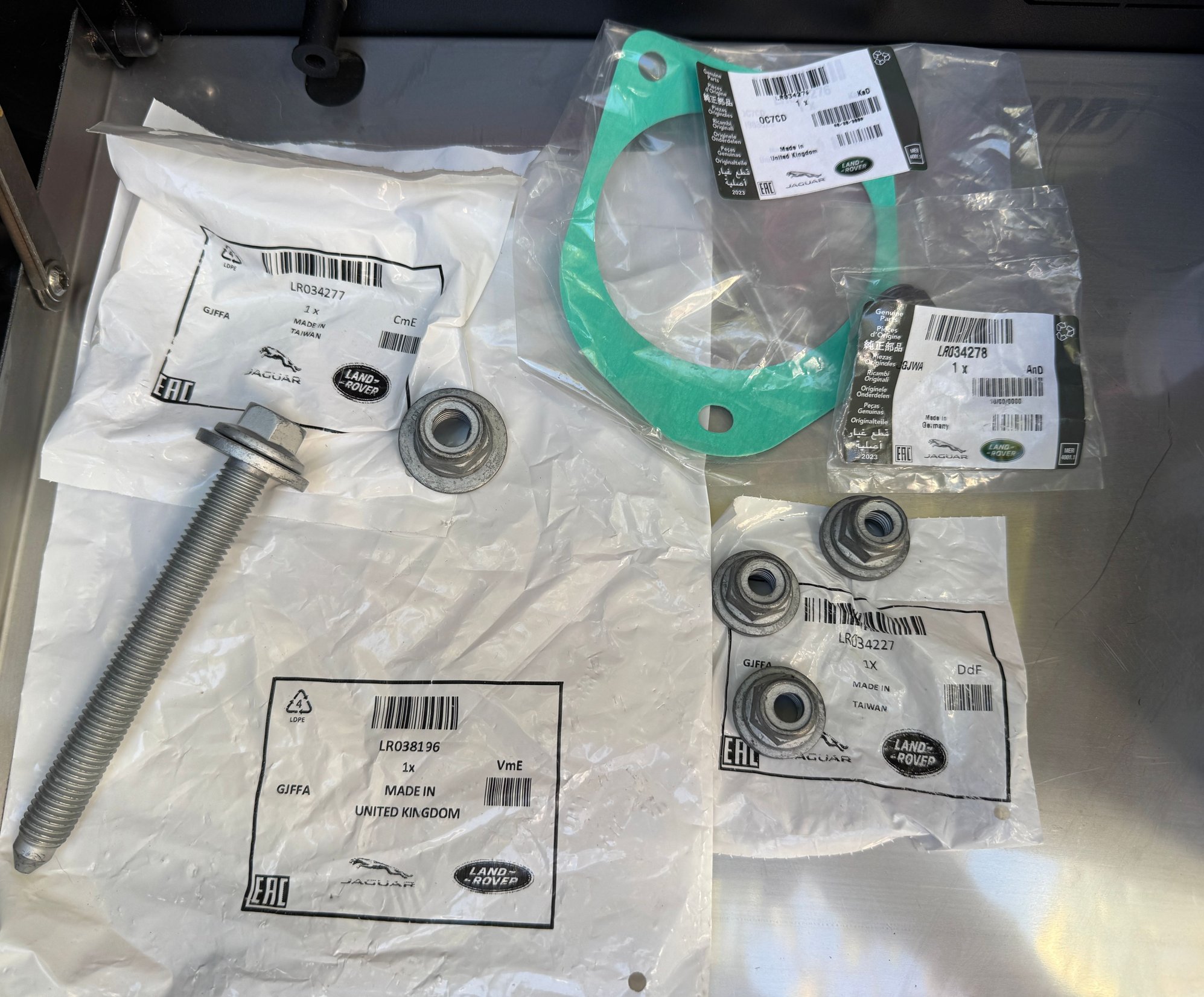

Parts list:
  • Adaptive Rear LH Shock - LR132722 —> supersedes to LR140076
  • Upper Shock Mount Seal LR034276 (the green thing)
  • 3 upper mount nuts LR034227
  • (If you also need the top shock shaft nut that is LR034278 but I did not)
  • Lower big bolt LR038196
  • Lower nut LR034277
  • 4 new white clips for LH cargo trim LR013135
  • 2 yellow clip LR035841 for LH cargo trim and LH lower 3rd row AC vent (note: these clips didn’t fit right. There is no way this is the correct part #. I broke one, had a spare, then had to file them down to get them to fit the 2 holes -- one on the AC vent, one on the lower front part of the cargo area trim by the left rear passenger door. LR dealer even checked parts diagram. Whatever.. be advised)

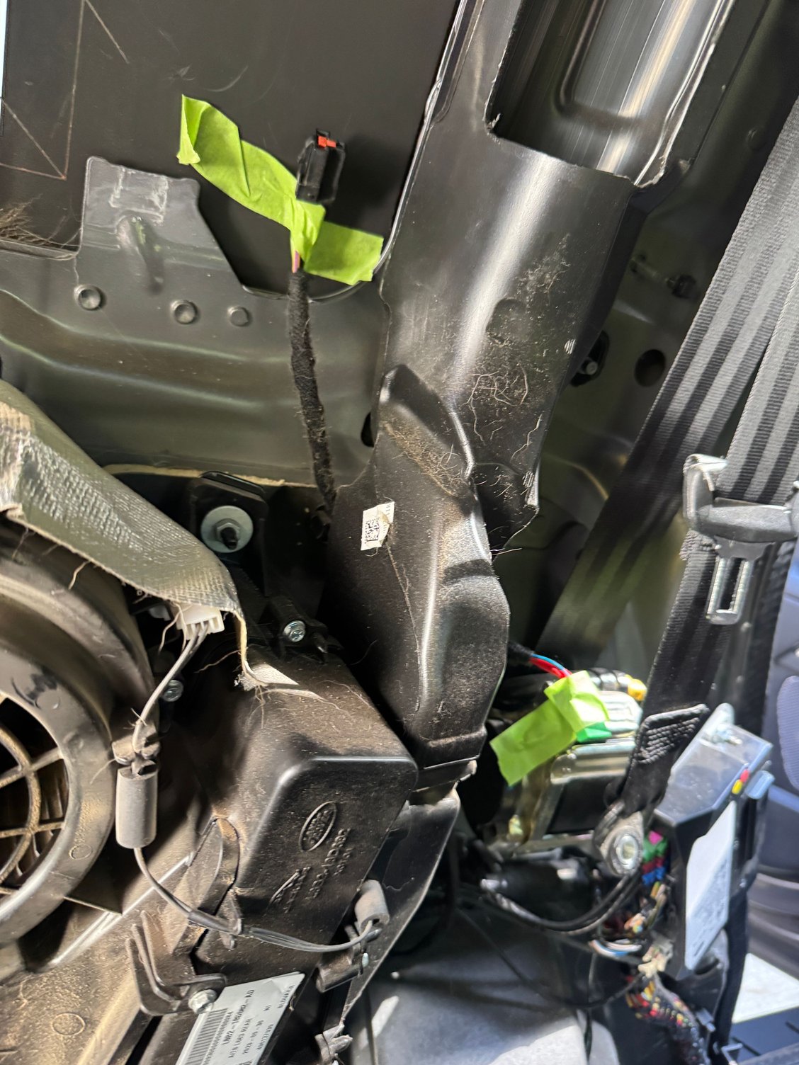

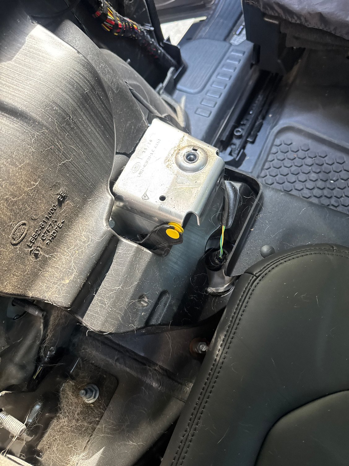

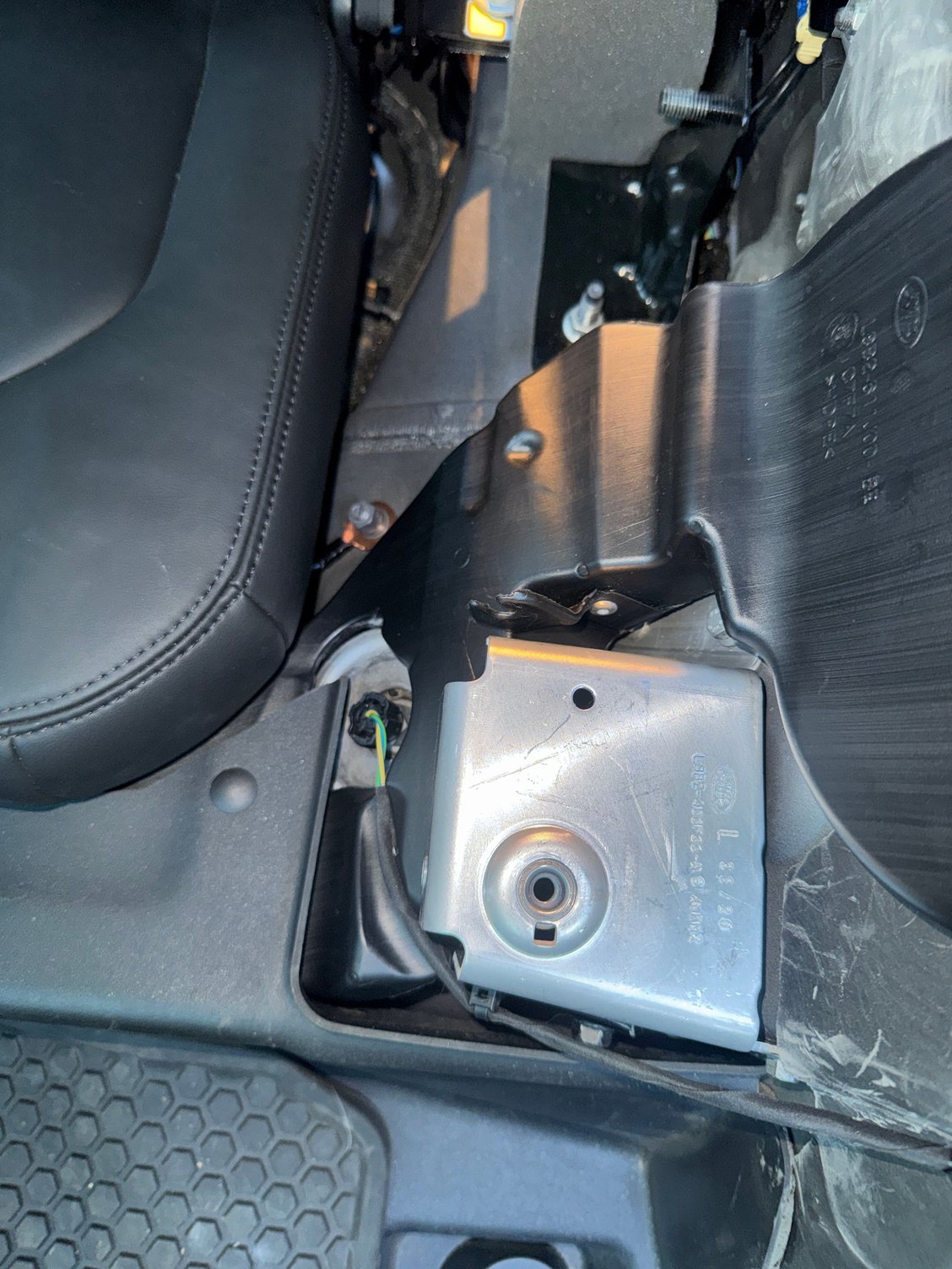

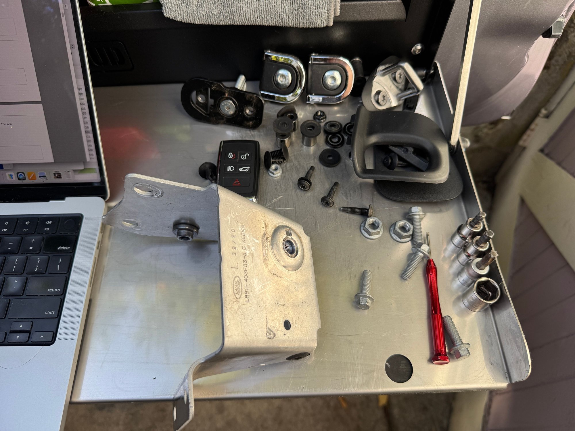

This is what you see when remove the side cargo trim on a 7 seater. There’s a metal bracket that must be removed - this bracket is what the cargo tie-down goes into. The black plastic is the rear cooling assist (HVAC) vent. That’s also got to go. You have to remove the vent tube to remove the silver bracket.

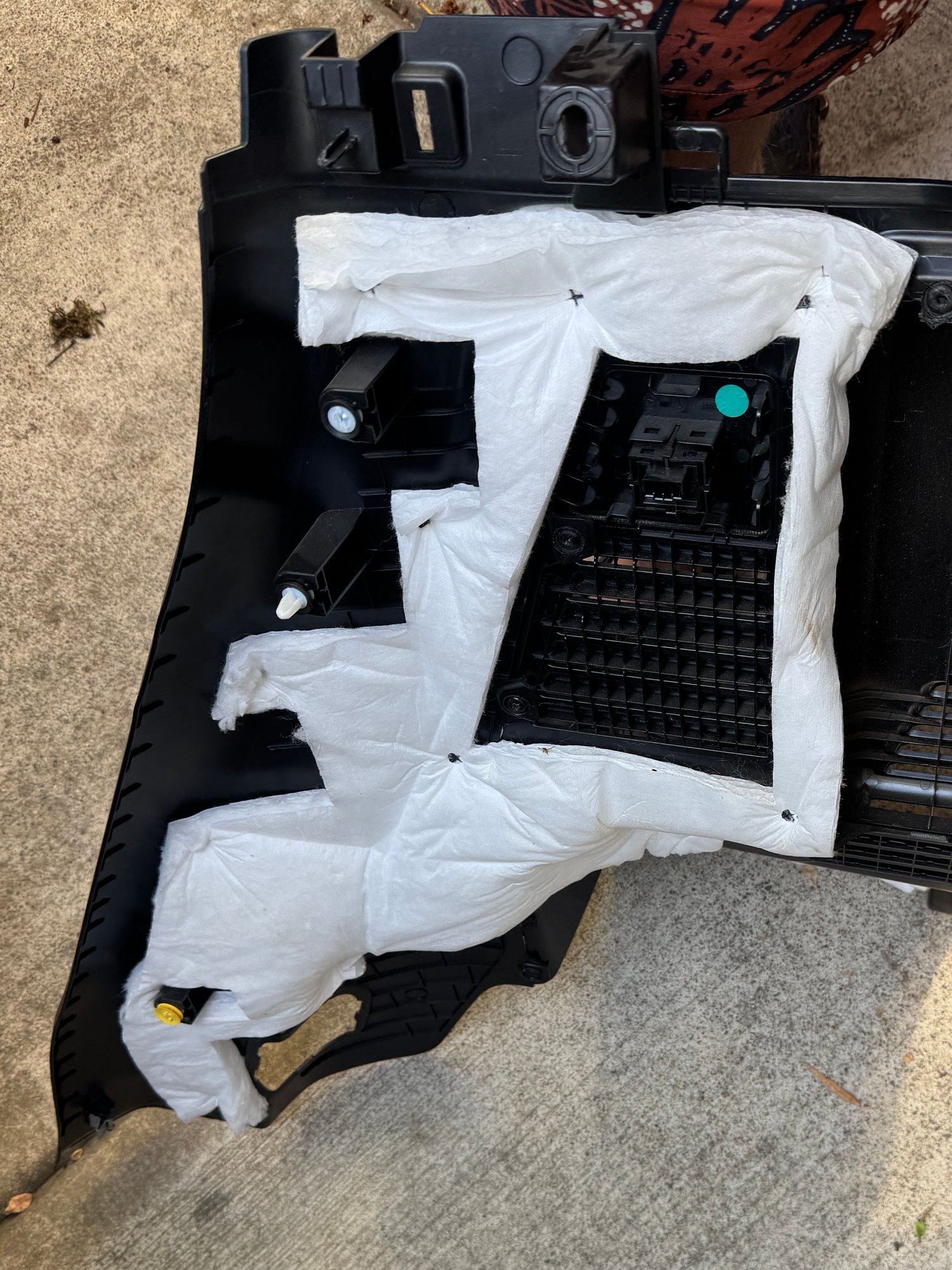

Rear of the LH cargo panel on a 7 seater, showing the white clips and yellow one (broken) on the leading edge by the left rear passenger door. Note this yellow clip is the same yellow clip as the one holding that rear vent tube in the above pic.

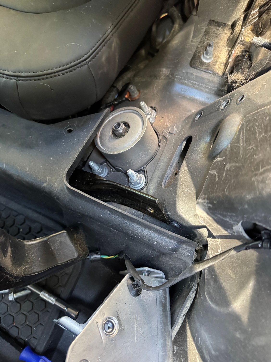

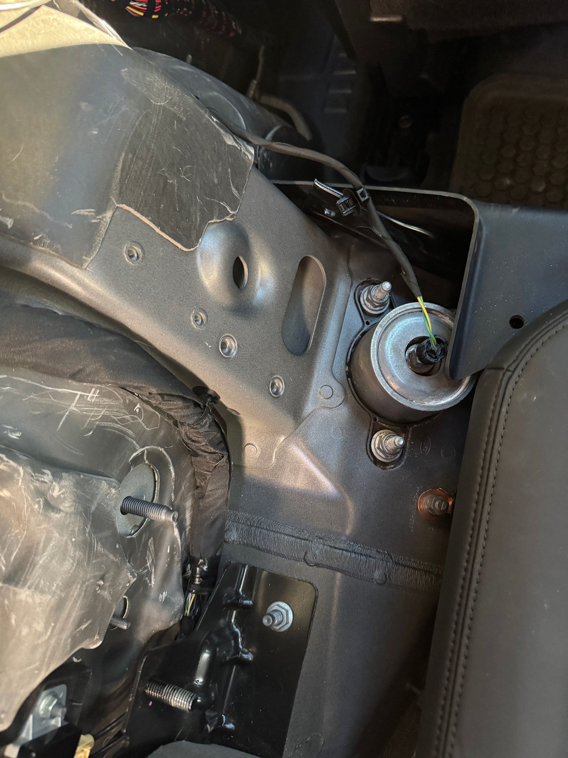

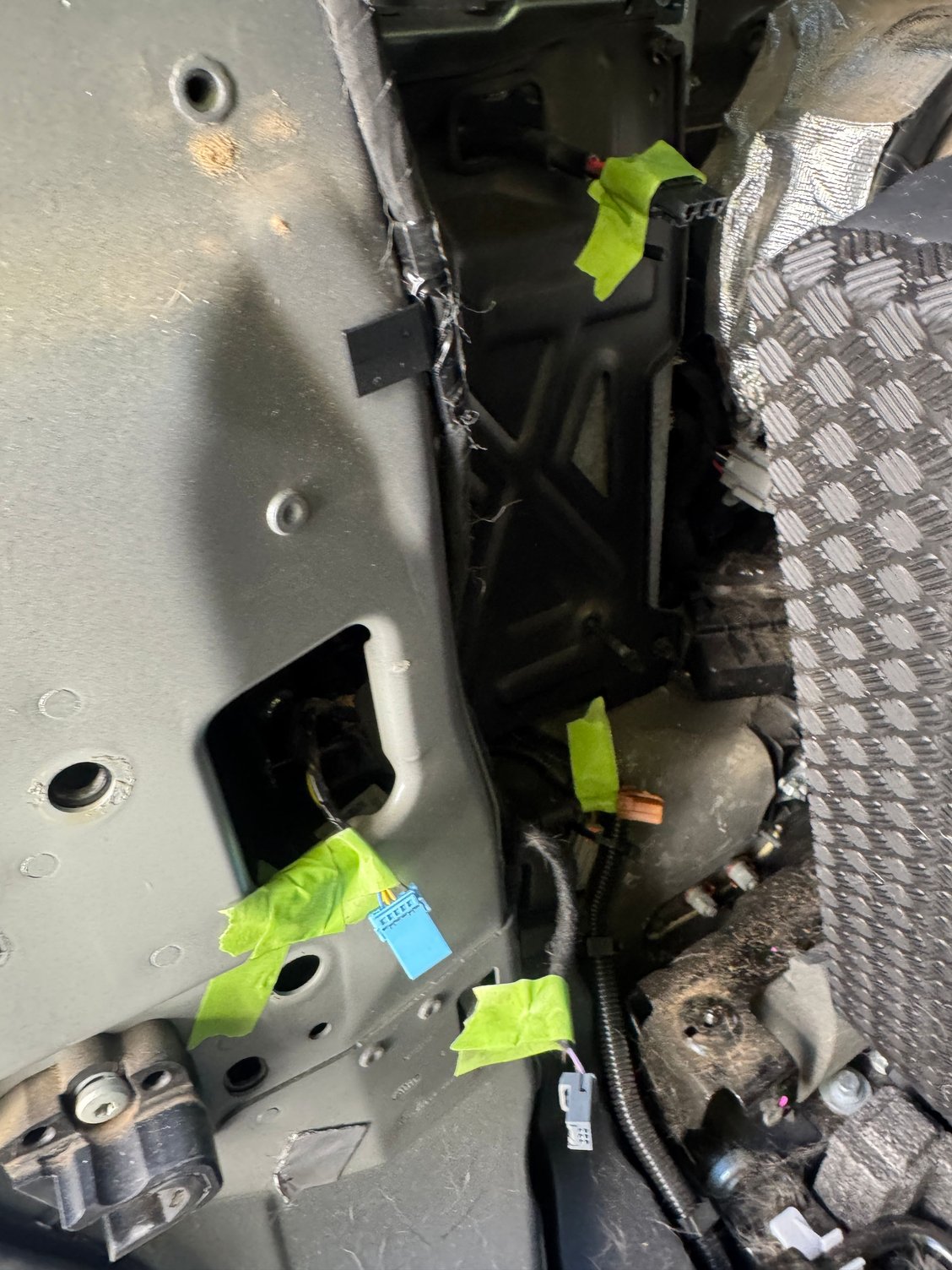

Full access here - everything removed and wire unplugged (squeeze both sides and pull straight up, very easy).
Parts
Marked wires that need to be plugged in with tape for visibility. I’m forgetful.

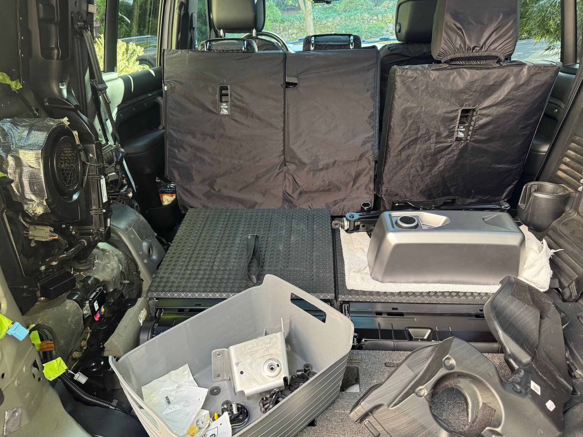

The work zone

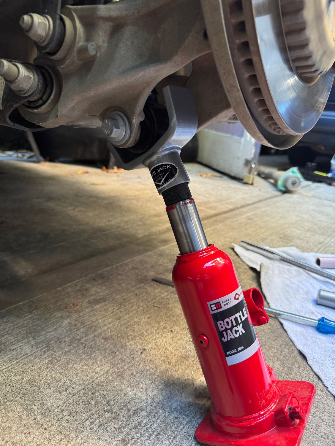

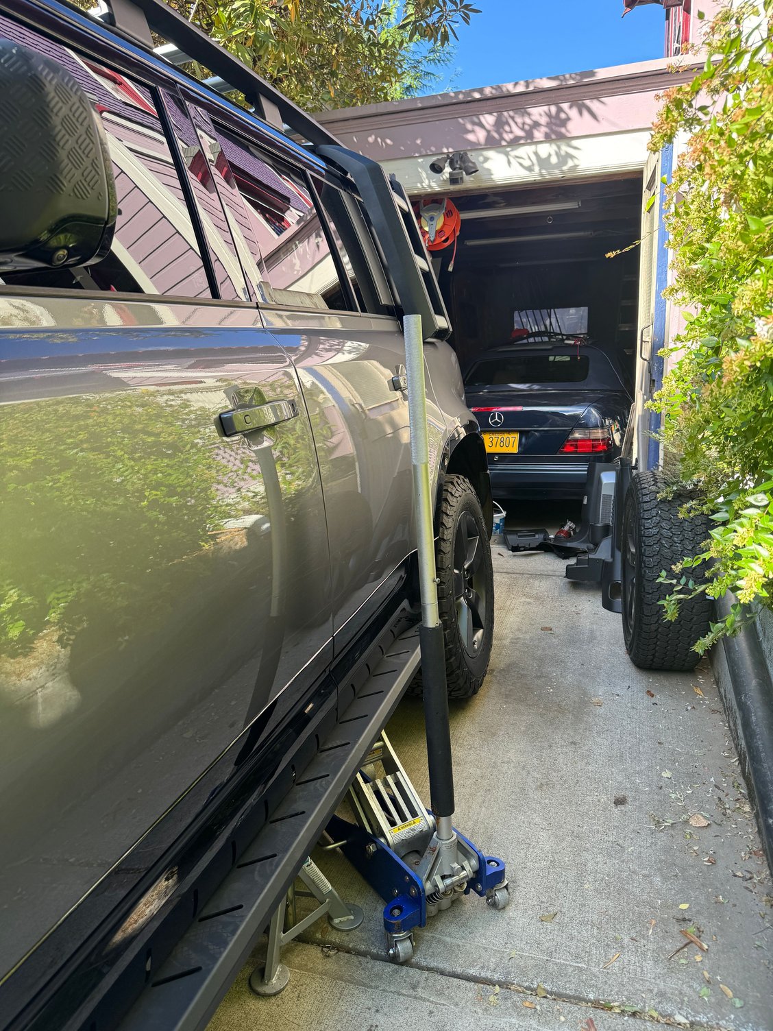

Jacking and using jack stand. Love the sliders during maintenance.

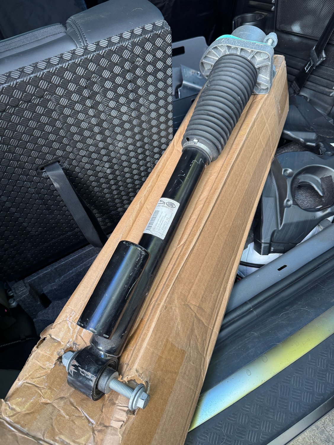

My New Ebay Shock
My New Ebay Shock
The new hardware
The new hardware

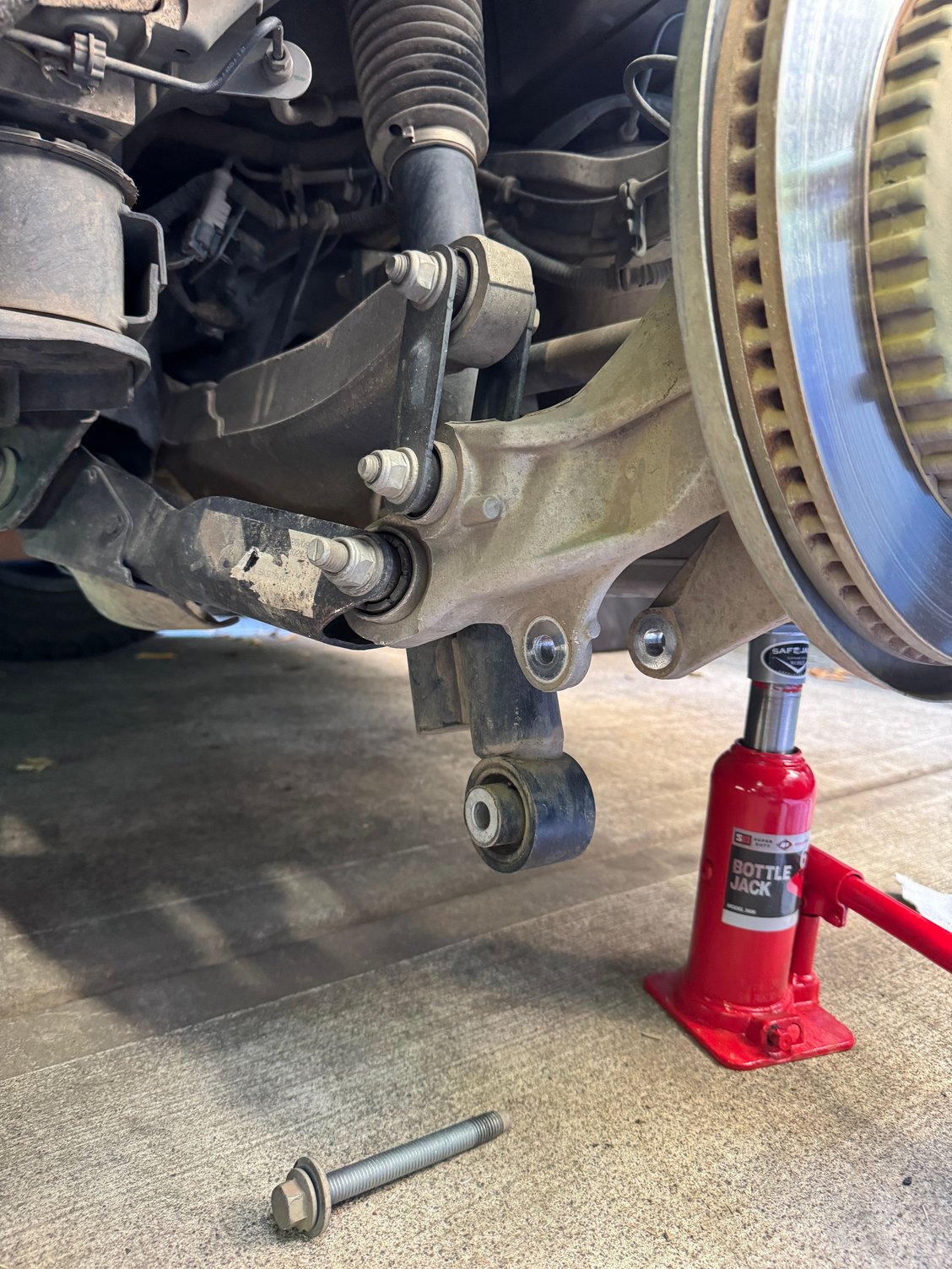

Nut removed, Bolt still in.
Nut removed, Lower Bolt still in.

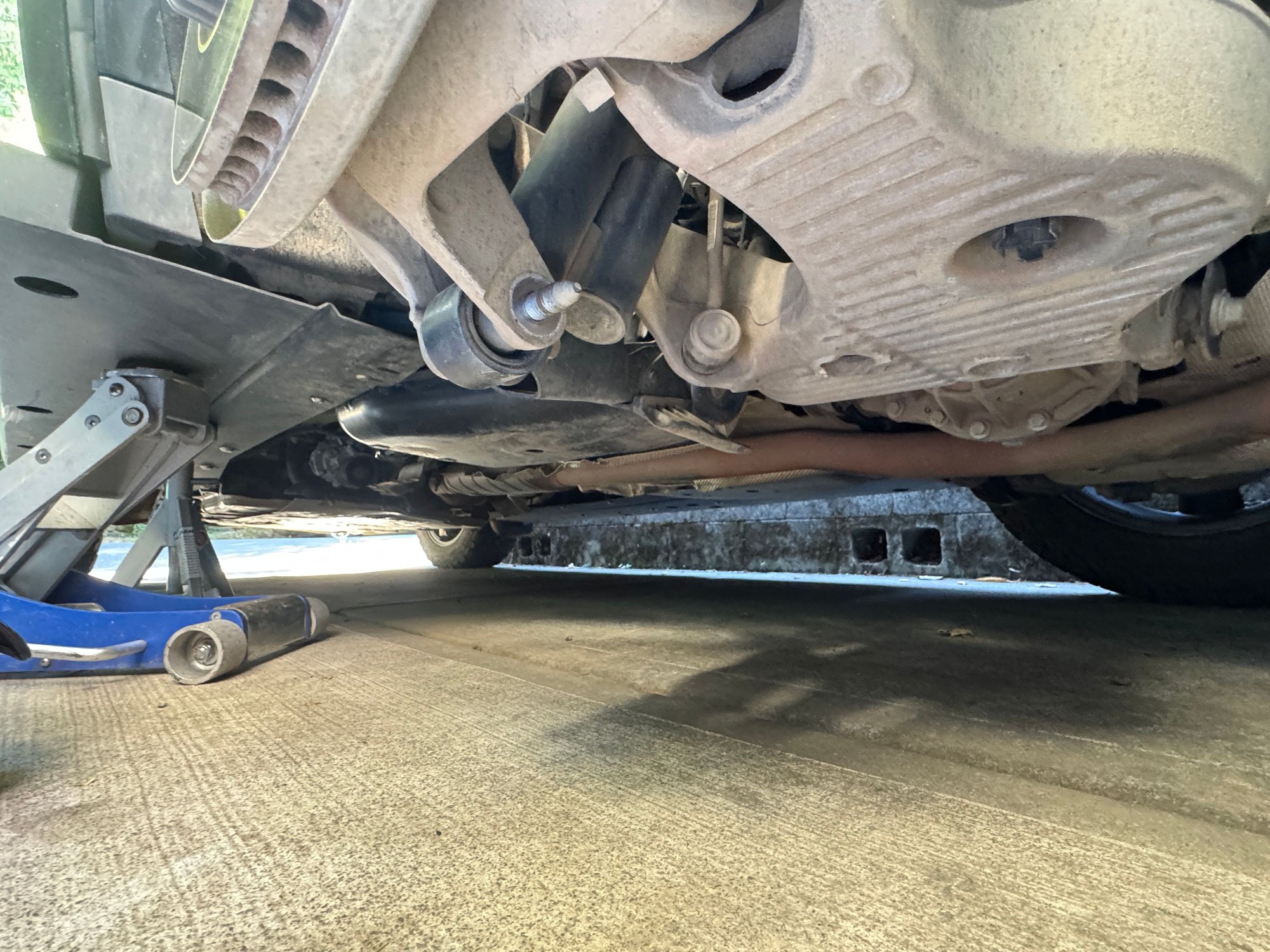

Lower mounting bolt/nut removed

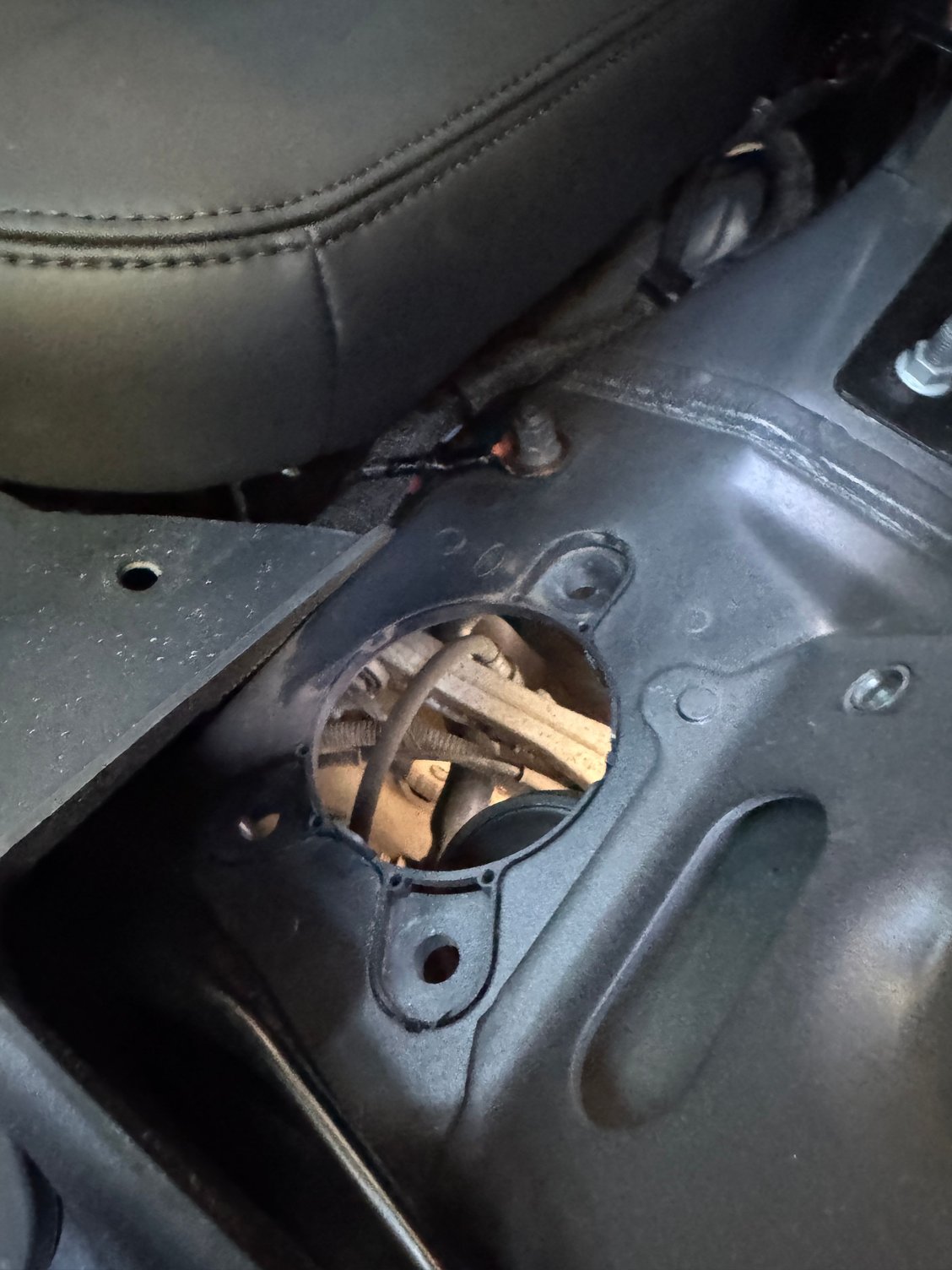

Upper shock mount removed. Look at that very small slot inboard of the bolt hole - it’s an odd delicate aluminum casting that is part of the car’s unibody. Fascinating. I think that’s to allow water to drain out.
Had to use the jack to compress the shock enough to get the bottom bolt through.
