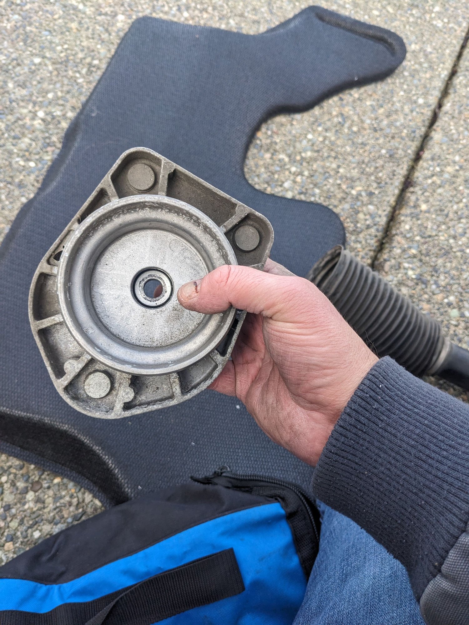

Replaced rear shocks on 2017 with air suspension and 3rd row. Couldn't find any reference online to interior parts to remove so I'm just sharing mine. All that needs to be removed is
Rh rear cargo area trim circled in red
Lh and rh 3rd row cup holders. They just pull up to remove
3rd row seat cushions. Pull up on front of cushion then pull forward
Trim under the third row seats. Just pull towards front of the car
pull carpet forward to expose shock mounts
Remove foam covers over the shock mounts
The shock removal is the same as what these poor range Rover owners detail in the video below.
https://youtu.be/kAZTrvE-Tns?feature=shared

More picks of the shocks disassembled. Very straight forward.
